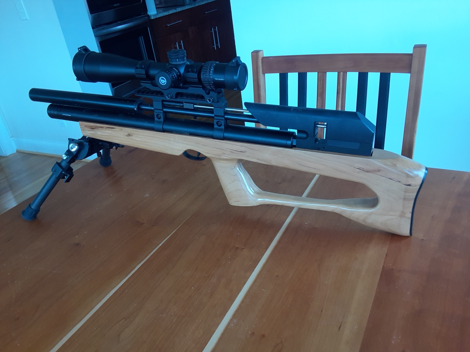

I mounted it on my P35-22 this morning and shot the gun a few times to get it sighted in. It is windy and cold here today so I did not want to stay out long. I had difficulty with the elevation adjustment and shimmed the back (shooter side) of the picatinny rail with 4 layers of soda can metal (about .020 thickness). That allowed me to get it sighted in. Not sure what was up with that, it is supposed to have a very similar range of elevation adjustment as my other scopes which did not require shimming. I am not a fan of shimming scope rings this way but I think shimming the rail the rings attach to is OK.

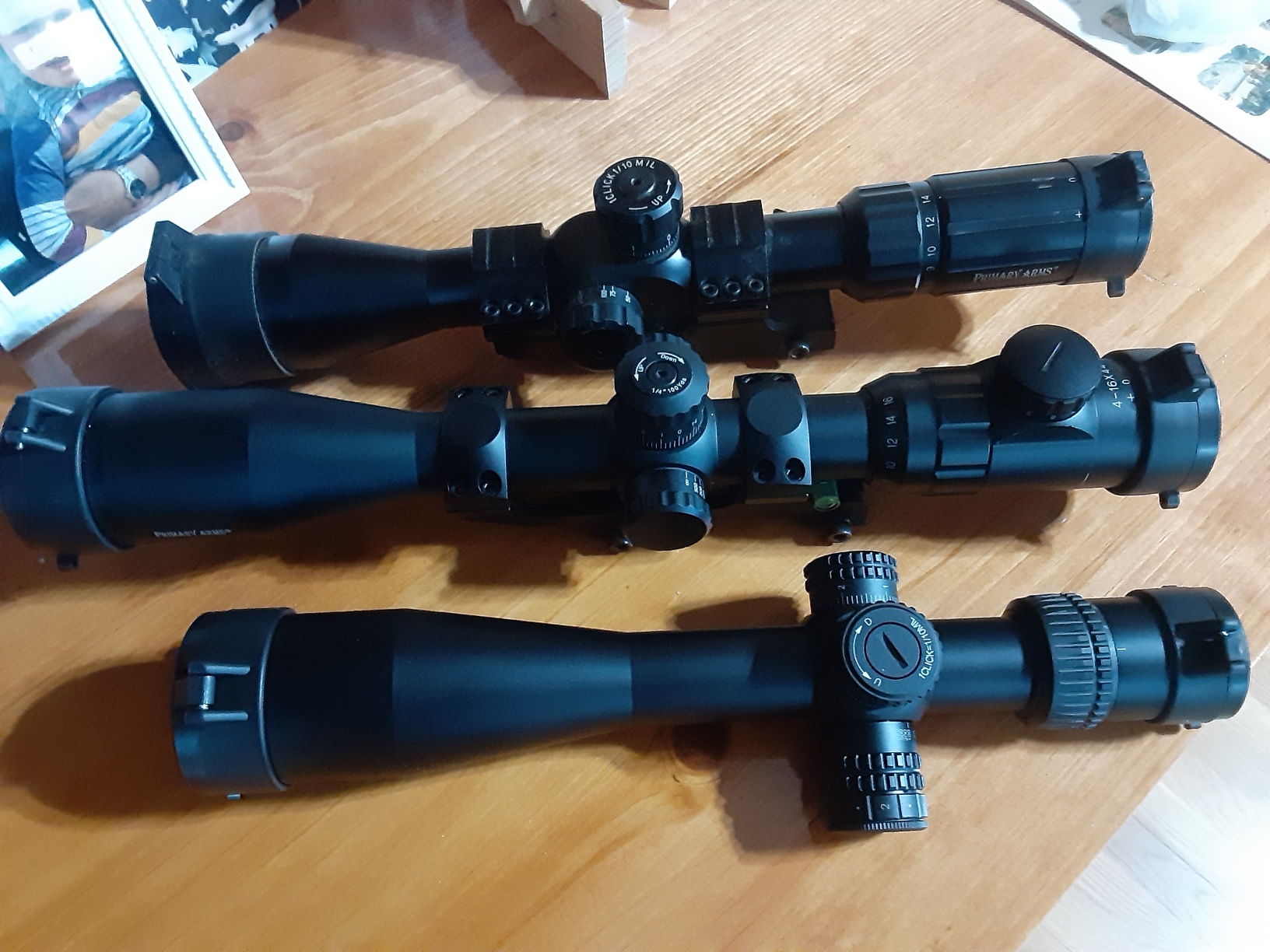

The other two scopes in the first picture are a FFP Primary Arms 4-14 and a SFP Primary Arms 4-15.
