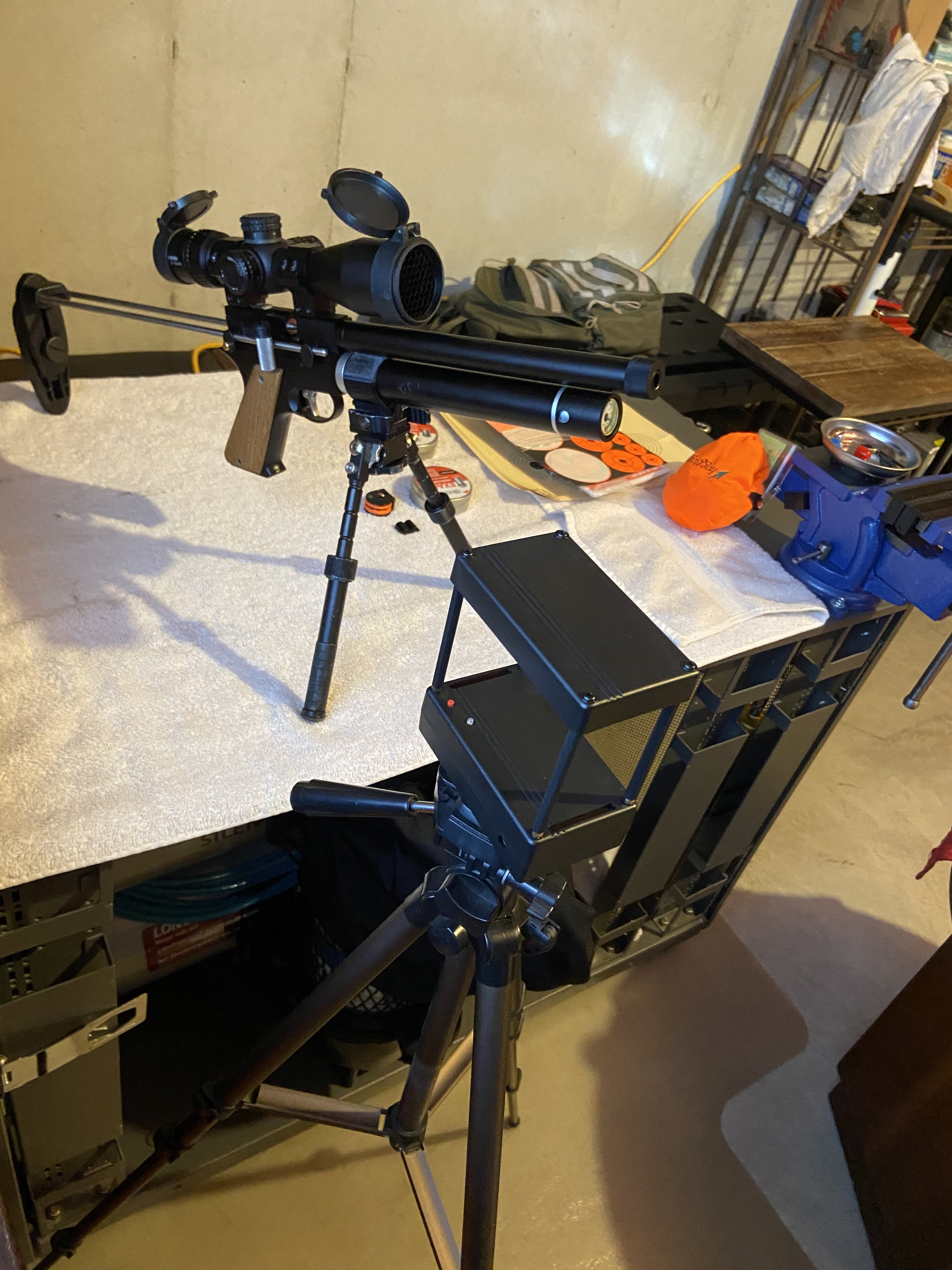

My Veyron 3-12x stopped holding zero today. I couldn't get any groups less that a couple inches at 30 yards. When I tried to rezero it, the poi move all over the place in about a 2-3 inch circle. You never knew where adjustments would move the poi.
I put a SWFA 10x on and shot a 3/8“ group about 1 mil high and 3/4 mil left. Dialed in the change and dead on.
So now we'll see what Vector will do. I'm pretty sure the Veyron only has a 5 year warranty and I've had this one well over a year, maybe more, and don't remember where I bought it.
