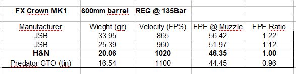

Hi, attached is data from my Crown. I hope it helps. I calculated the FPE ratio using the H&N 20gr pellet because they were the lightest lead pellets.
