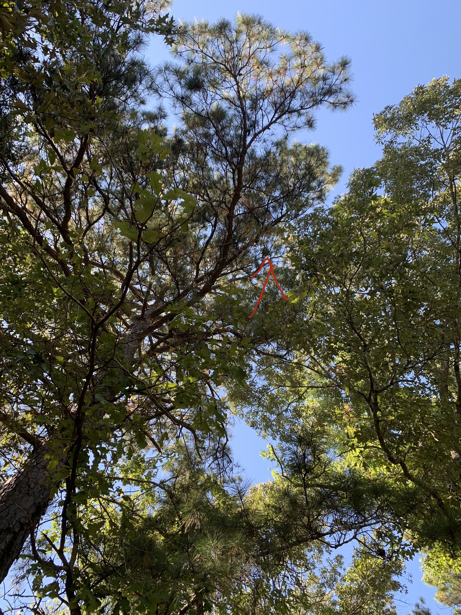

This year I’m able to identify and shoot at squirrels higher up in the canopy (or above the canopy as some pine trees penetrate the canopy created by hardwoods). I’m used to spotting squirrels in or around oak and hickory trees. They’re more difficult for me to see and track in pine trees. Some of the pines they’re in are pretty tall (around 75-80’) and I’m estimating their distance from me on the ground via the parallax knob on my scope. I intend to get a little practice in on some pinecones later today. I think what proves most difficult is that I frequently don’t seem to hit anything that makes an audible sound upon impact or to knock bark off of the tree so it’s tough to tell where the shots are flying. After watching the video I believe my shots have been flying high. I have the scope zeroed at 25 yards. As a couple of you stated, it appears that I need to hold-under.
Just shot a few mags at some pine cones in this tree. It’s around 75-80’ last I checked. I’m sure it’s grown some inches since I last checked. POA was around the tip of the red arrow. I held under 2 mil hashes which I’d probably 3-4 mil considering that there appears to be at least 2 mil worth of space between the crosshairs and the first holdunder mark in the Vector Veyron reticle.
This was the result of an offhand shot approx 75’ up holding under 2 mil hashmarks shooting an EDgun Lelya 2.0 in .25 caliber starting reservoir pressure approx 200 bar shot around 23-25 shots ending pressure approx 145 bar. Not sure which shot this was. Most likely around shot 20.
**Note it didn’t take 20 shots to hit the pine cone pictured below. I shot several pine cones at various angles working my way up to vertical shots. My point blank POA worked well for most shots. It probably took me around 5-6 shots to figure my hold shooting vertically from a kneeling position or from standing offhand. I then had to allow time for everything over head to fall down around me so I didn’t get debris in my eyes.
