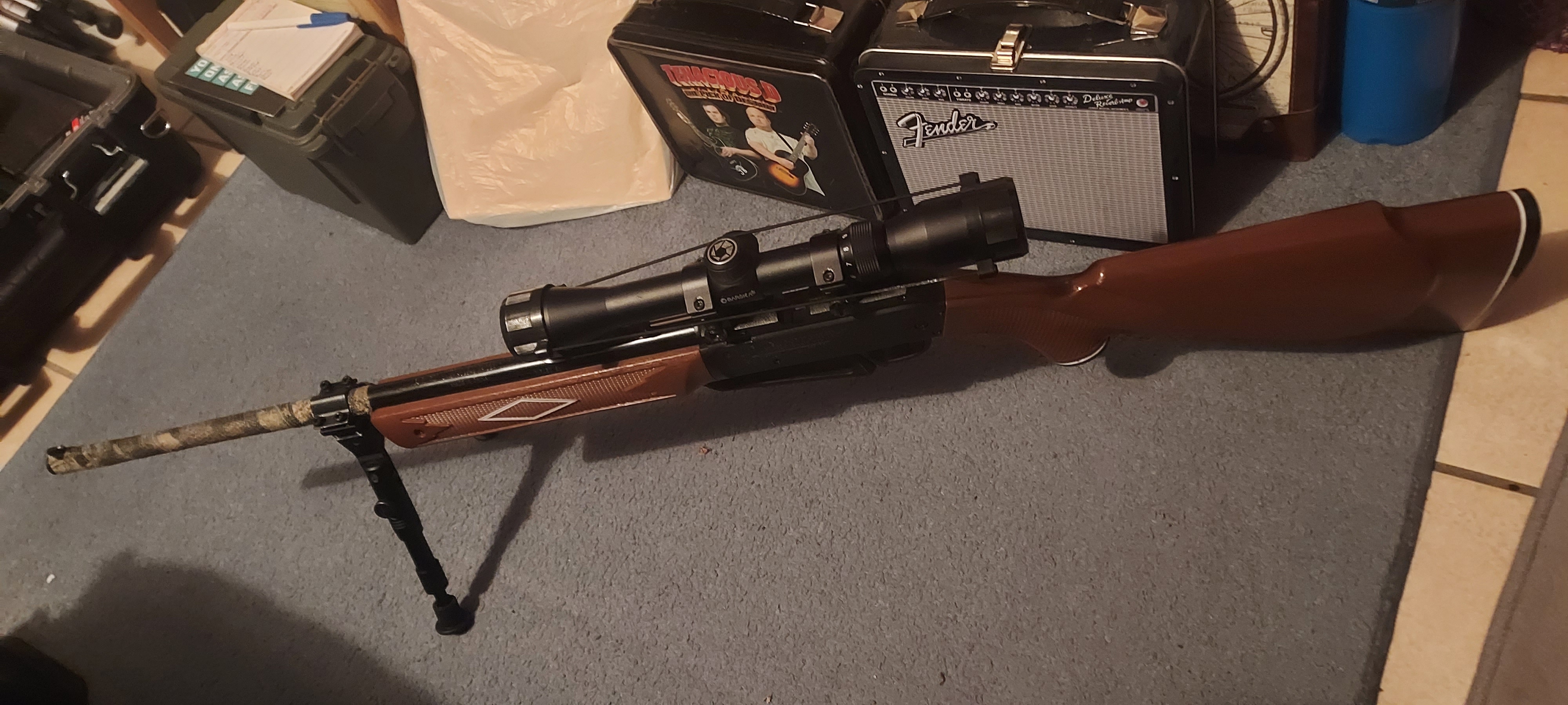

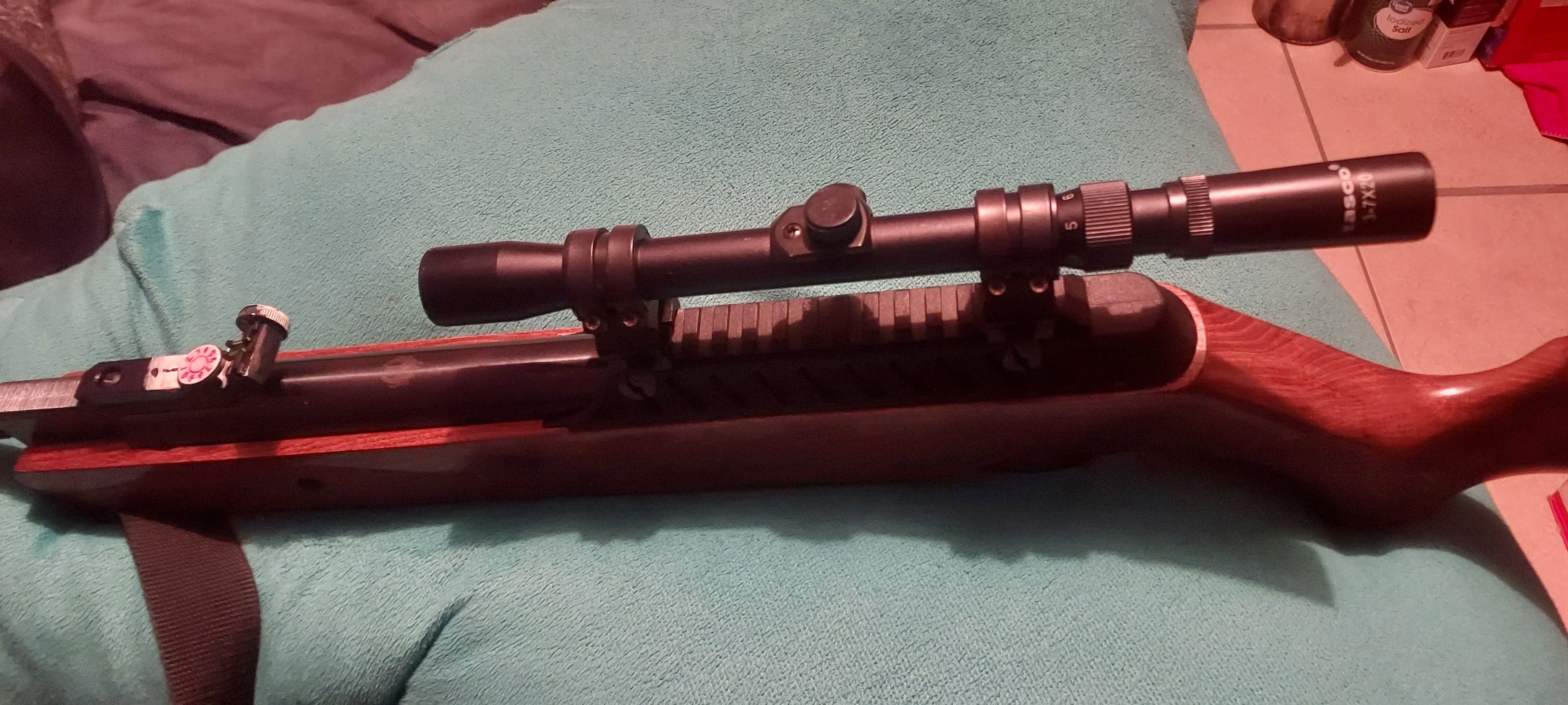

Objective lens size for me is determined by usage*
Small.scopes don't take up as.much room/I can setup my see through mounts and use iron sights underneath of my scope.
Big scopes eliminate that option so I use those on slingers that dont have iron sight availability.
Examples below using my ruger🤙
^my ruger with a large diameter objective lens. Can't see under scope.
^this way; installed some spacers for a thin scope, slapped on tall see throughs.
Now I can use my scope AND my factory iron sights🤗🎩🤙

I like that idea! Decide to use scope or open sights on the fly, without having to change anything on the gun. But how thin is “thin”—is yours 1”?
Then again, if the gun comes without any sights, might as well put on a bigger-diameter objective.

That little scope is a 3/4" tube😅
Tasco 3-9×20

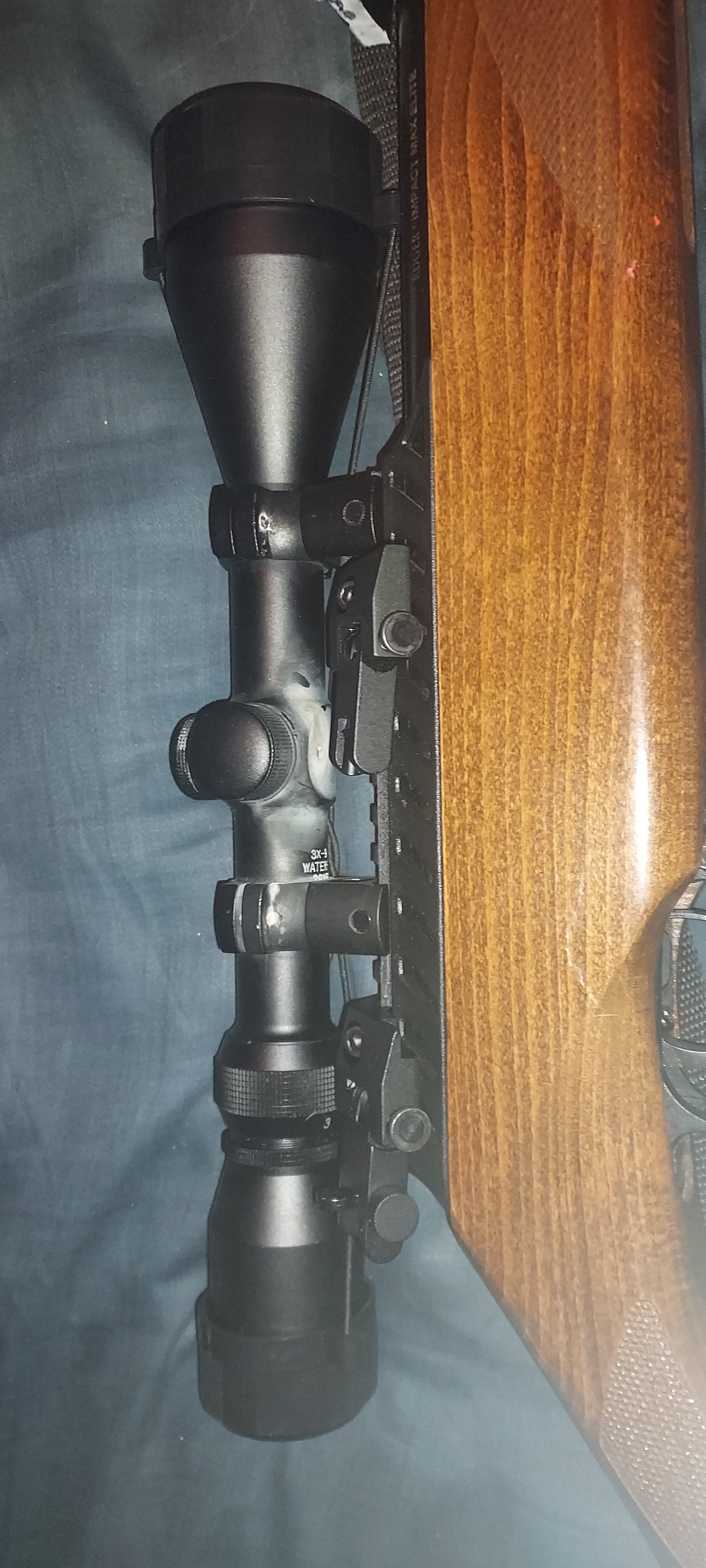

Barska 3-9×32🤩
Hits bottlecaps.at 50yrd all dayyyyyyyyyyy💥🤪🎩🤙
View attachment 371458View attachment 371459
