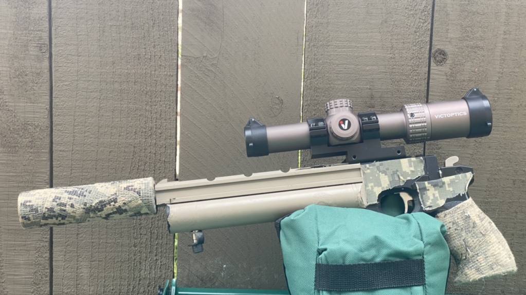

So got the second one today and mounted it on my PP700. Have to say I’m still impressed if not a bit more.
the problem with my PP700 is I switch between carbine and pistol format all the time because with the folding stock it’s really hard to fit into my biking backpack. Red dot works but my eyes don’t really like red dot as much and then I like to have a little magnification especially in carbine form for the 25-30 yards shots. Hence the reason I’ve tried over a dozen different optics many times on the pp700.
what was interesting today is I realized the eye relief on this scope in 1x is so good that at full arm’s length it still is kind of useful as a pistol scope but only at 1x. But move it a little closer in FT style support I can use 2-3x fairly easy. Because of this I could use the same exact scope in 2 very different shooting style or switch between carbine and pistol. Very interesting, will play with it more but I’m even more impressed with this budget scope. Only wished it’s even lighter!

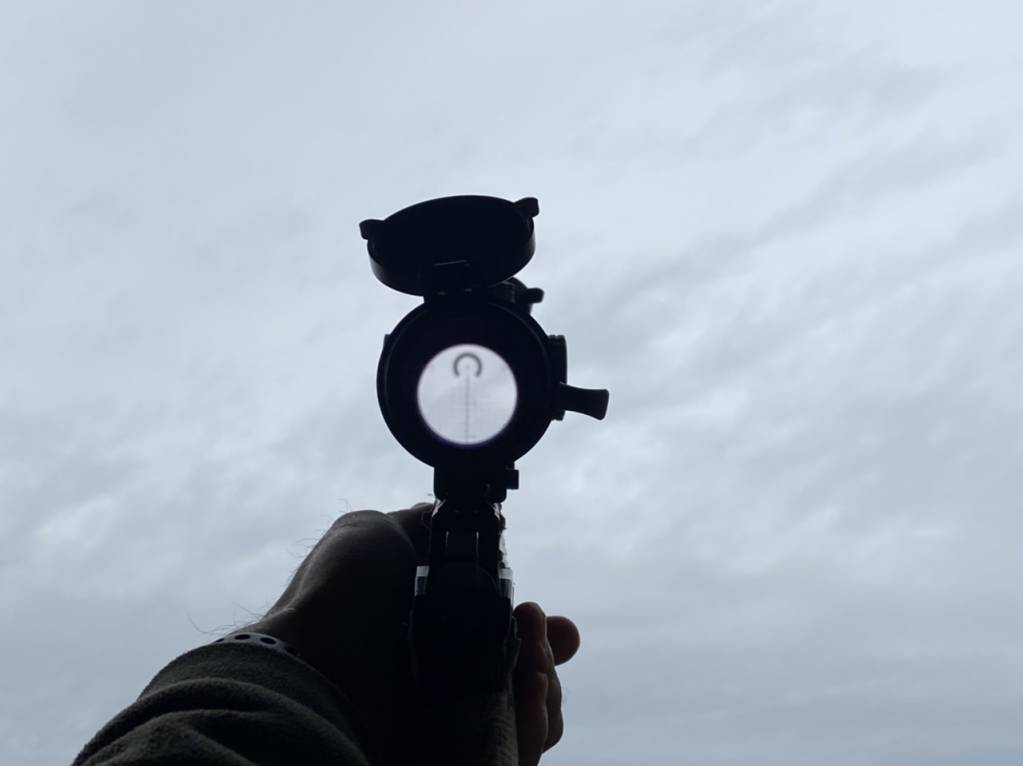

ok, side by side these 2 scopes are impressive their own ways:
Glass: vectoptics is whiter and little brighter but alpha 6 has better resolution even though it has a yellowish tint to it but that helps with contrast
eye piece: alpha 6 has significantly larger eye piece which means significantly wider field of view.
eye relief:
1x vectoptics has linger eye relief
3x alpha has slightly longer eye relief
6x Alpha has longer eye relief
from eye piece perspective alpha is SIGNIFICANTLY better! Not only it has larger eye piece with wider field of view the eye relief is far more consistent throughout zoom range like expensive LPVO scopes.
I really love Alpha 6 LPVO scope but really dislike the big round dot, had it only has a modern reticle it’s just crazy hard to beat. interestingly the not so great eye piece with extra long 1x eye relief actually made it a possible very versatile scope on my PP700. Also being very light weight is very appealing. If you don’t mind the weight and round center dot the alpha 6 is definitely better but they are a little different with their own good points and bad. If only the vectoptics had the Alpha eye piece…….LOL
