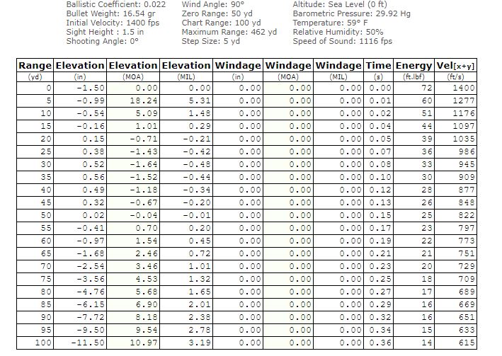

GTO 25cal 16.54grains Muzzle velocity = 1400fps BC 0.022
Looks like velocity drops into transonic speeds before 15yards.
Won't be very accurate past 15yards?

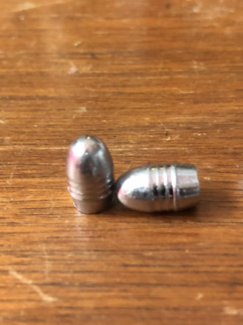

How about a round nose boat tail slug that has a BC of .15 in lead? It's 48 grain bc .15. I read on some blog about ballistics written by someone who knows a heck of a lot more than me that round nose boat tail type projectiles are not as affected by the trans sonic transition. The diablos with the skirt on the other hand... How else to explain people shooting 22 LR right around the speed of sound with plenty of stability over long ranges? Bullet shape I believe

How about a round nose boat tail slug that has a BC of .15 in lead? It's 48 grain bc .15. Can you estimate for a tin slug of the same size with a weight of 31 grains?
Around 0.096BC but where did you find 48gr 25cal slug with 0.15BC 🤔? Seems fairly high seeing some 257cal slugs with significantly more weight barely reach that. If I remember correct most slugs that I shot out from 25cal sumatra from 48-55gr had 0.07-0.095BC.
Ok well it seems like .15 is a high number based on a vendor's claim for a product. I would love to know the actual BC of the slugs in the previous post of mine. Based on a BC database maintained by Robert Sterne (I think?) it looks like bc's above 0.1 In .25 slugs is verified and the slugs with that BC were flat nosed rebated boat tail with prominent drive bands and less aerodynamic so maybe those in the pic above would be unusually high like .12 or .13. I don't have two working chronographs and my airgun is unregulated so I don't think I can test it.
Noe 50gr FN BT seems to be 0.1282bc and 60gr 0.1480. Nose of the bullet dosent have much to do with ballistics on subsonic speeds FN, spitzer or RN dosent matter much. Main problem with BT bullets and airgun barrel twistrates tho is the fact BT requires faster twist and atleast my 25cal 1:18twist barrel didnt balance any of the BT bullets I tested from oldschool .254 bore sumatra. Best bullet I found for that gun was https://noebulletmolds.com/site/shop/251/tl255-50-rf-cb2/tl255-50-rf-cb2-2-cavity-pb/ that BC is wrong on that it surely isnt 0.176 but more of like 0.0760 if I remember right. If you have 1:18twist 25cal barrel I highly recomend that bullet as long as you size them to right bore size.
Thanks. The slug i posted a pic of was designed/tested etc. to shoot out of LW choked .25 barrels in older huben k1, and stable at a range of velocities out of that gun. Worth taking a look at and I never see folks posting about these slugs.

Orginally that bullet was designed for 22cal huben to fit and stay in mag and barrel was unchocked also.. 25cal is just enlargened version of that not really designed or tested for huben 25cal and havent heard much about that 25cal. Maybe it just dosent work.

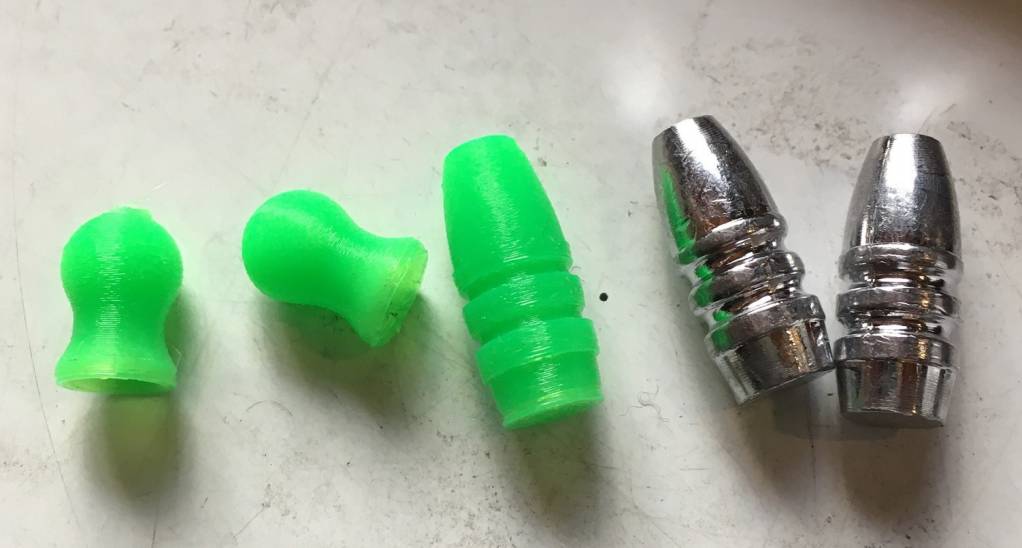

.. It shoots 50 grain slugs at over 1000 FPS. How fast would a 16 grain lead free diablo shoot? And what would it's trajectory be?
Those 16gr would probably be about 1200fps, and it will get progressively more difficult to go higher. I adjusted my .25 caliber HP airgun to shoot 70gr lead slugs at about 960fps. It shoots identically shaped 8gr PLA slugs at about 1660fps. The BC is so poor that it would be subsonic before it reached 15yards.
The hollow 3gr PLA pellets had a muzzle velocity of 1750fpsand would be subsonic before 5yds.

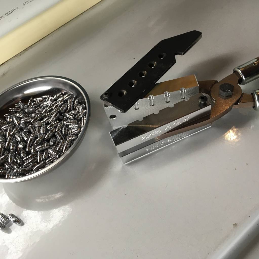

What is the source of the mold that casts those slugs?
Source of mold for lead slugs:
http://arsenalmolds.com/products/257-Bullet-boattail
The Arsenal mold is of good quality.
The PLA projectiles were printed.
