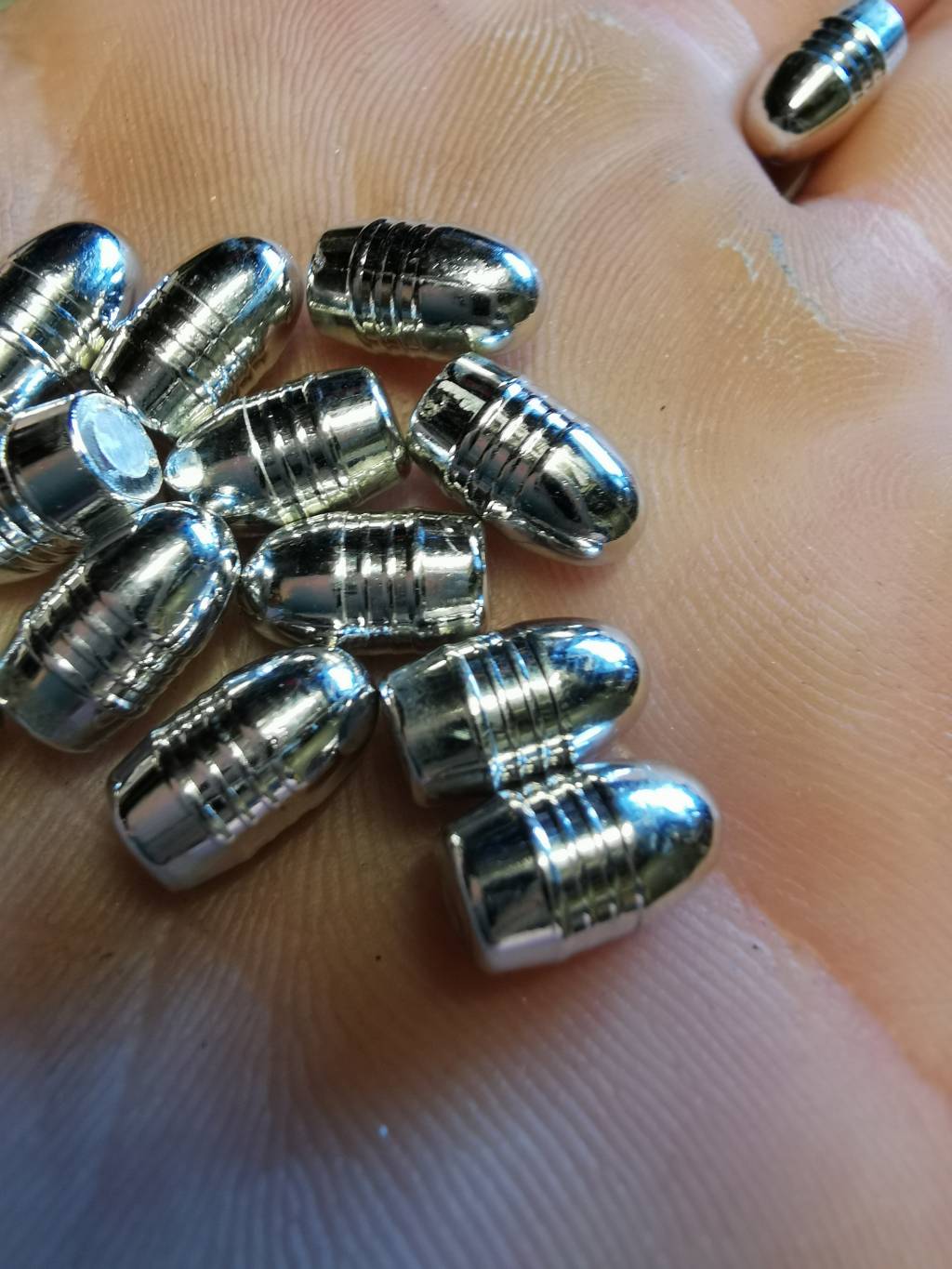

Do you size those down to .25 or are you shooting with a .257 barrel?
I did not size them down. The slugs drop from the mold with .2555"-.2560” diameter at the driving bands.
It's a 25-20 barrel, .249" bore, .2555" groove diameter. It also shoots 34gr JSB .25 pellets fairly well as they have a 0.249" diameter head and a 0.259" diameter skirt.
Tin casted lead 48gr comes in 33gr, hard to cast them, specialy fill them at the top. Accuracy is very bad at all speeds, price...😅
