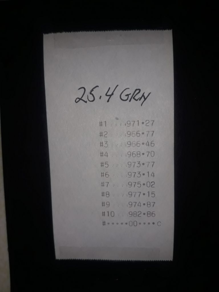

Got the chronograph out today and decided to run some over it with the .20 just to kinda make sure it's still where I think it is.
68 shots, starting pressure of 238 bar and ending pressure of 128 bar (Sekhmet digital gauge so not just guessing)
Lo = 791.3
Hi = 806.7
Ave = 799.2
ES = 15.39
SD = 4.35
With JSB 13.73 gr so average FPE of 19.48.
It's pretty common to read comments where folks make it sound like a sin to just turn down the hammer tension without adjusting the regulator......well.....I'm a sinner. But I'm also pretty dang happy with this Vet's performance (accuracy/shot count/etc) at 20 fpe, whether it's got the .22 or the .20 barrel on it.
A little chairgun fun for those turning red in the face at my blasphemous, no-touchy on the reg, tune......
with a 30 yard zero, the 806.7fps pellet (fastest) will impact at -8.29 inches at 75 yards, the 791.3 (slowest) will impact at -8.73, also at 75 yards. So that's a difference of 0.44 inches. In other words, taking operator and wind out and bum pellets, and whatever other excuses, all 68 shots would hit within 0.44 inches, vertically, of one another. Just sharing a bit of perspective about jacked up tunes.
It's fun to obsess over single digit spreads, and tinker and tune and fiddle till we get there, but how many of us are actually good enough to put this particularly low weight, low bc, low energy pellet within 0.44 inches at 75 yards anyway, Better BC, heavier, and higher FPE simply push out the distance to where a 19fps extreme spread doesn't make any real world difference over a 9fps extreme spread.
