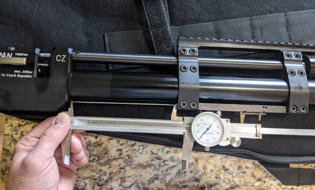

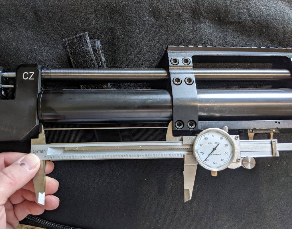

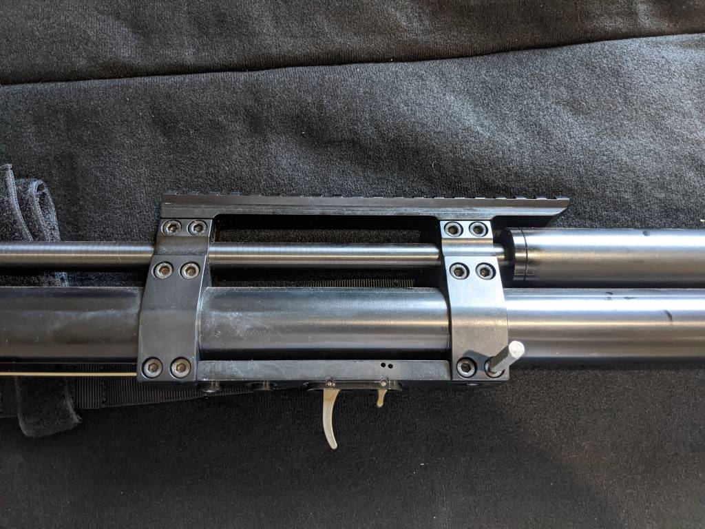

Here's some pics of the steps. I measured the distance between the scope tower and the breech because trigger feel and function is so dependent on that distance in these guns. I usually have pencil marks on the tube but the tube will be in a different place after the plenum addition.
Loosen up all the tower screws.

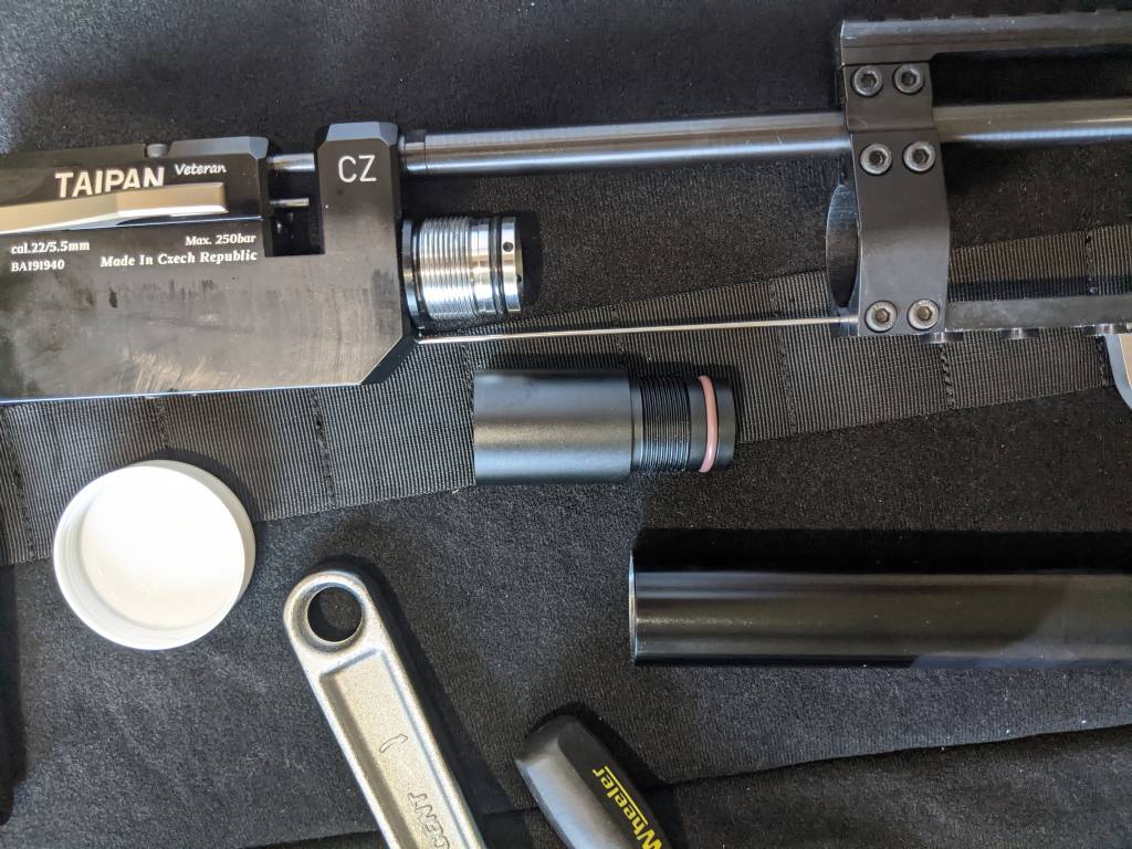

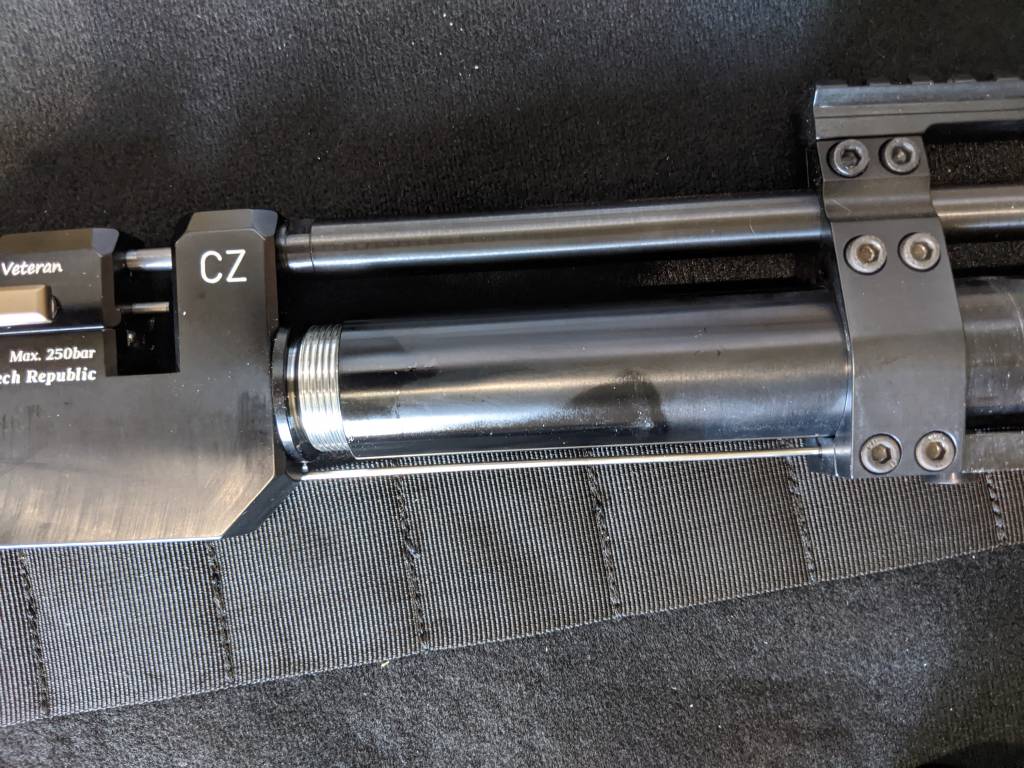

At this point just unthread the tube

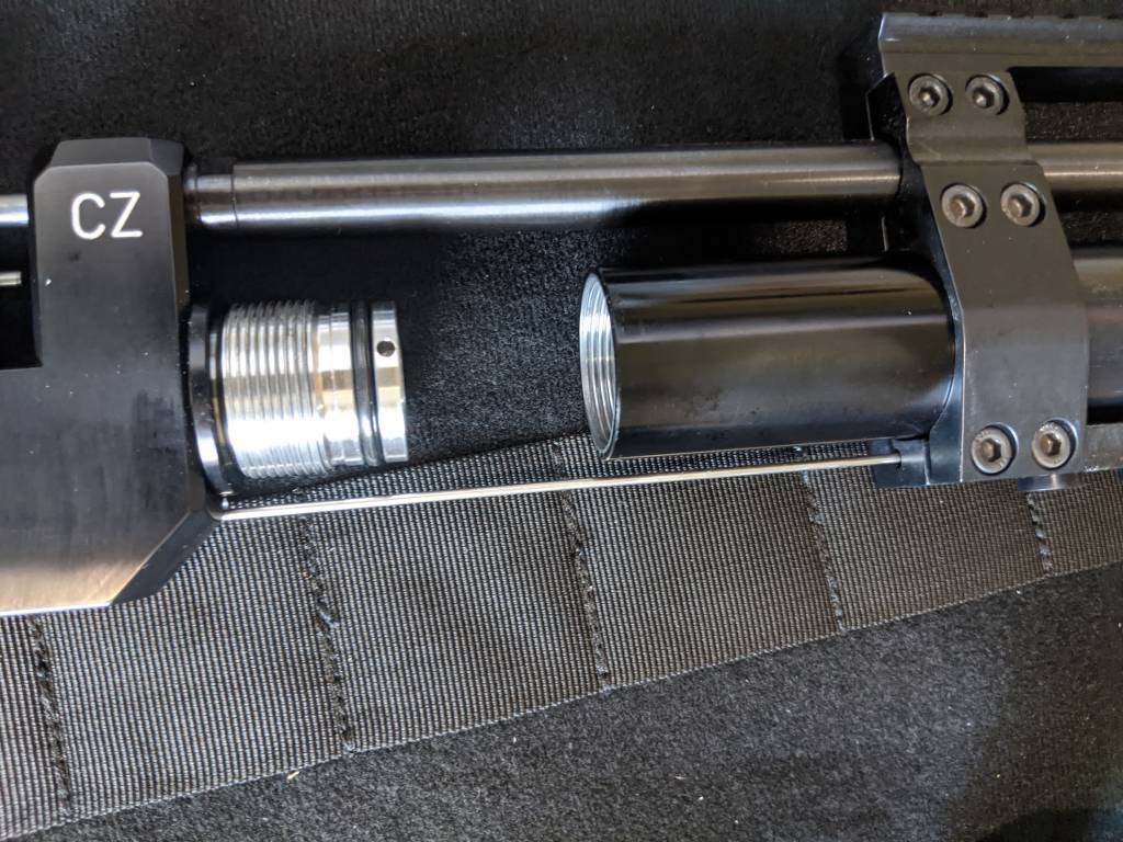

Apply some silicone grease to the oring seen here and to the one on the plenum. I also grease up the threads lightly. Silicone on the threads may not do much, but I've always figured it might help from them seizing up.

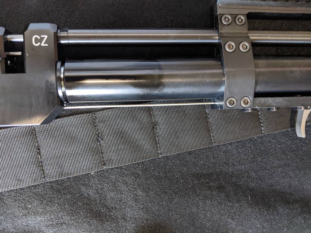

Screw it all back together.
Duplicate the distance between tower and breech as the 12 tower screws are tightened back up.
