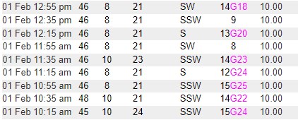

These were the conditions. NOAA has a new weather station just 3 miles from my house so pretty similar to what I was seeing on the home range.
(yeah, not the best winds for testing accuracy....)

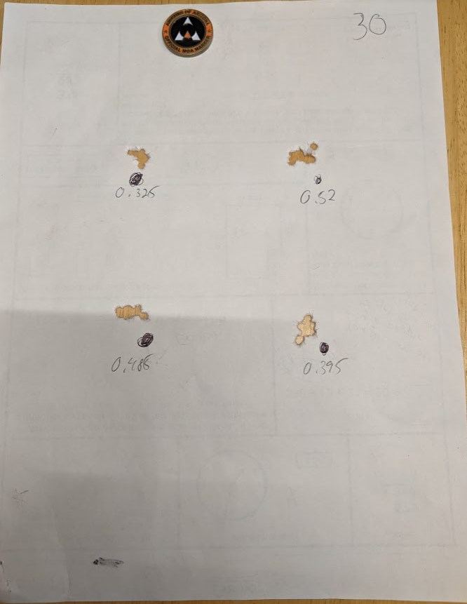

Here's the 30 yarder.

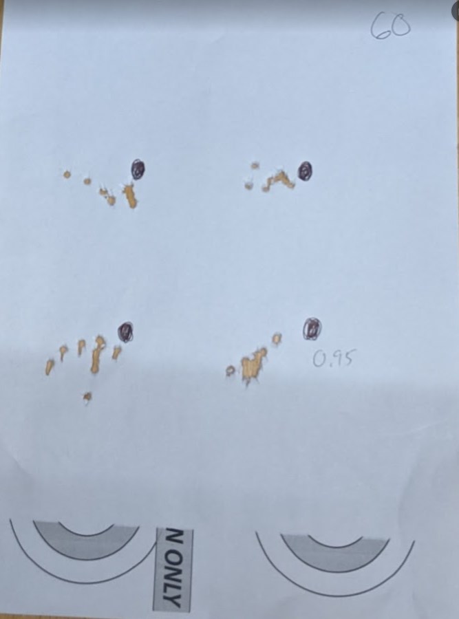

60 yard target below....

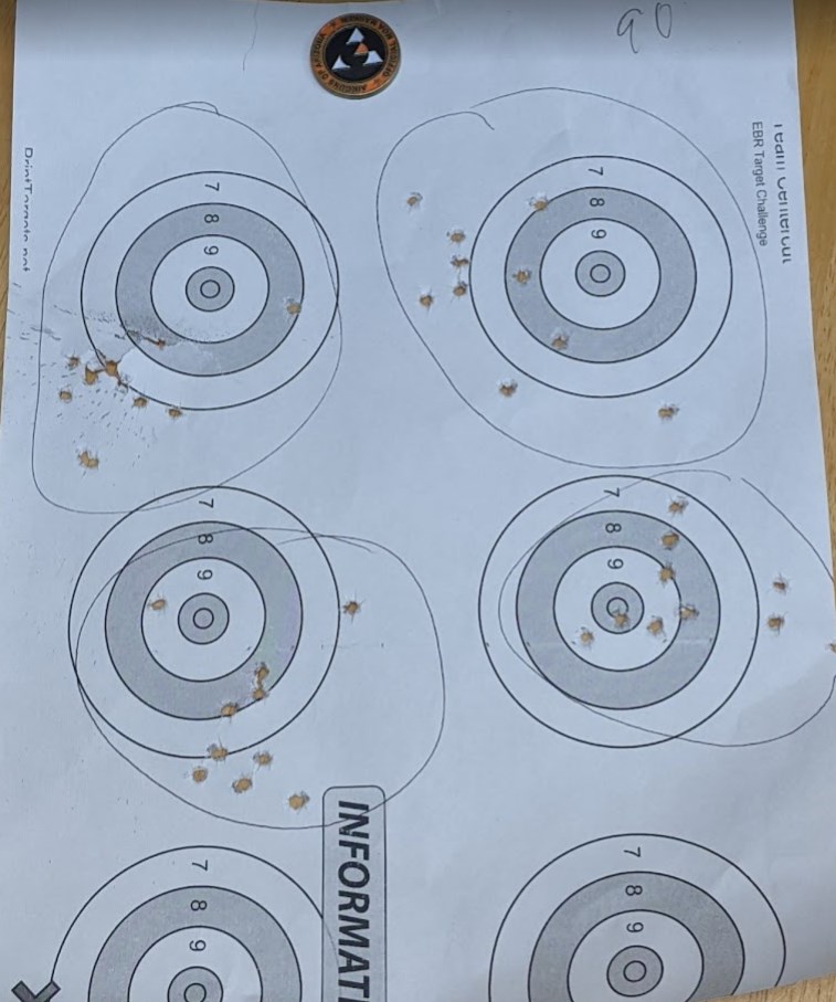

and then the 90 yarder.

During the shooting, I was sure feeling like a couple out of each ten shot group were "flyers." Not bad flyers hitting inches from where they should, just minimal flyers, not quite falling into the pattern of the other 7 or 8 or 9 shots of that group. And I couldn't see any coinciding gusts to explain it away. At the 30 and 60 it was really incredible to watch the pellets go into the same hole. Examining the 60 I realized that 3 of the 4 groups have 8 of 10 shots into 1/2 an inch or less. That's really quite impressive, considering this was from a .177 @ 60 yards in winds that probably averaged 15 or 6 mph.
As for the 90 yard groups, sorta that same trend as the 60s. 3 of the 4 groups have 8 of the 10 pellets into about 1.25inches. That is also quite impressive for a .177 in those winds, at that distance.

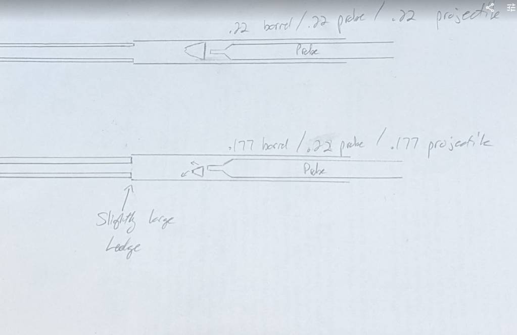

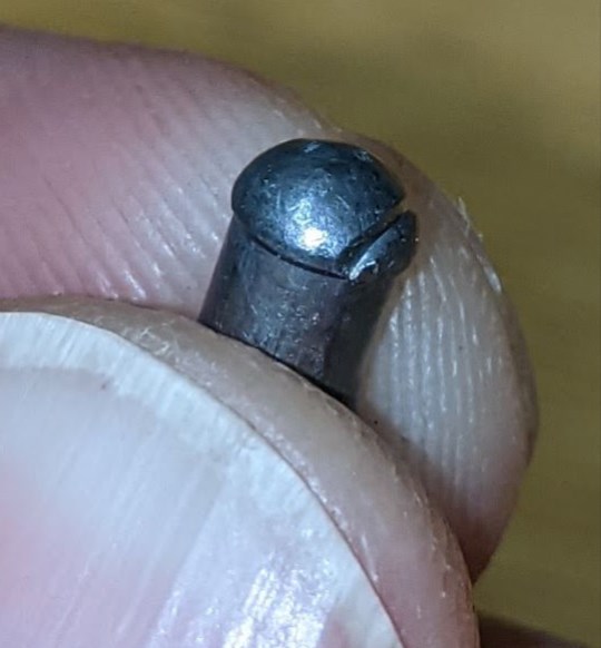

Also, in those 120 shots, I had 4 jammed pellets. Surely a by-product of using a .22 probe with a .177 barrel but partly me learning the gun also, as they happened early on and I figured out that I could prevent it by not closing the side-lever too fast, and making sure the gun was level. Logic would say that the ledge when the pellet hits the barrel would be a problem and indeed that's where it was jamming, but further investigation showed that it is predominately a pellet tipping problem. With a quick lever cycle and/or an unlevel gun, the pellet tips forward and digs into the lip of the barrel. I believe it is because the .22 probe pushes on the pellet nearer the top than the middle like it would if it was a .22 pellet.
This was one of those failed loads.
When I was installing the barrel I pushed a couple into the leade as if to shoot, and then decocked and unscrewed the barrel for a pellet examination. When they don't tip and then jam, there is no head deformation occurring.

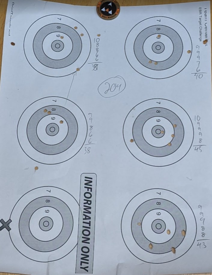

I did take the 15gra NSAs out to 90 yards and decided to shoot an EBR practice card. And with the 15s at 90 I was holding for the wind and varying that windage as the gusts came and went.
That's more likely a 203 or worse, as I see that I gave a 9 a ten in the upper left. But, not horrible, again in the context of a .177 @ 90 yards in gusts up to 25mph.
