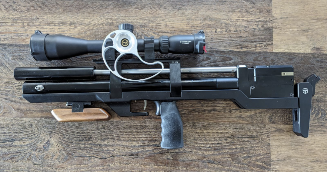

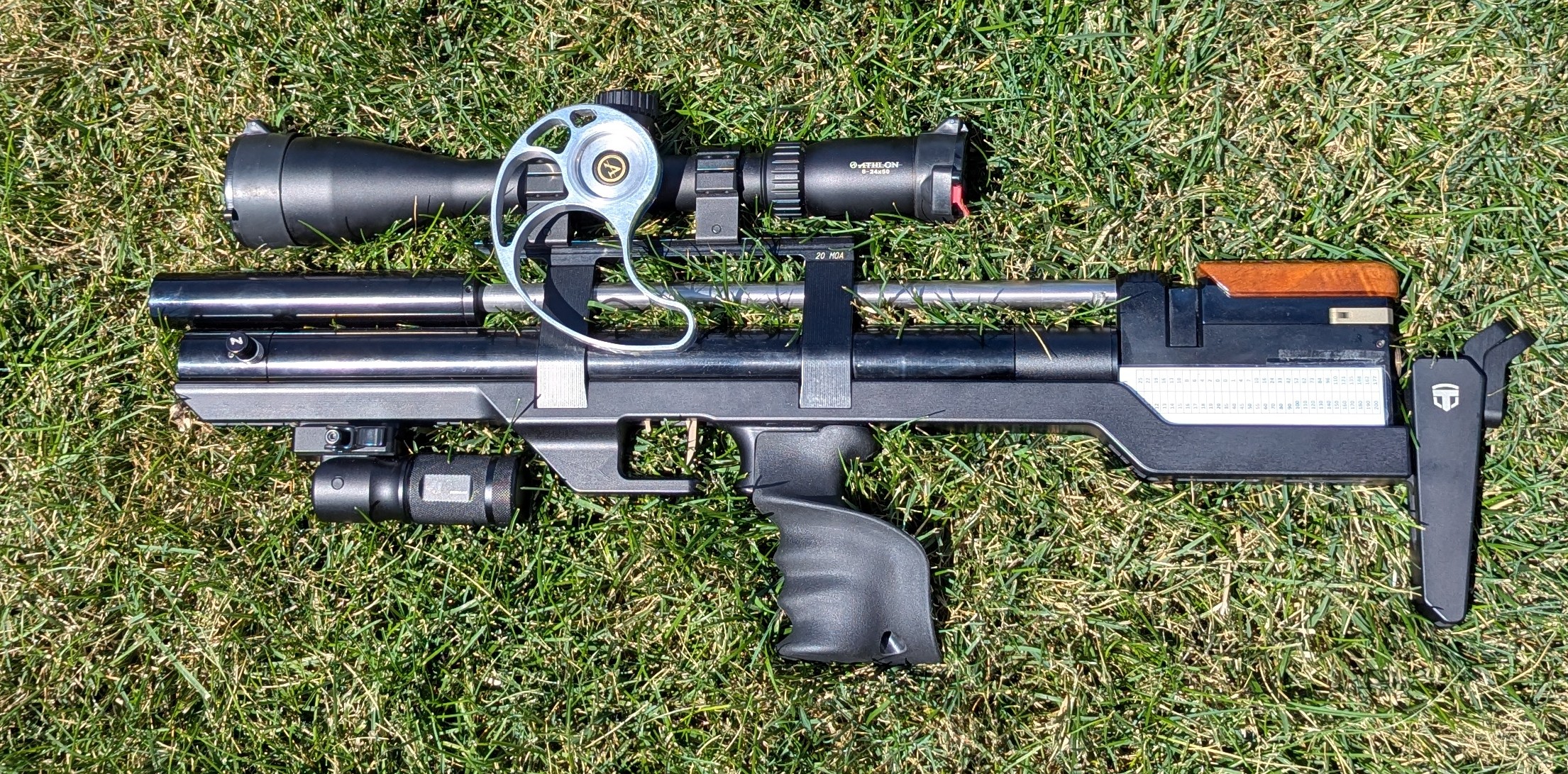

Veteran Short .20
Sweet little gun and I'm just as excited to own it now as I was the day I first received it a couple years ago. I knew in the very first shooting session that Vet's are just special, and that impression is strengthened every time I get the privilege to shoot them. This little .20 Vet is my favorite general use airgun, it can do it all, and well at that.

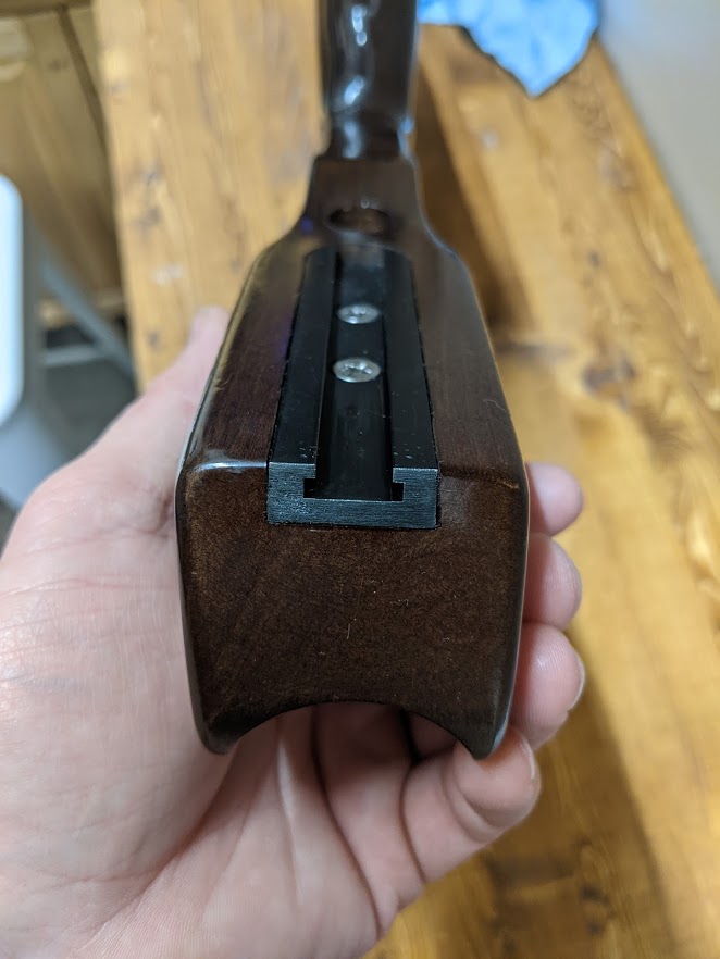

Also, as this is pretty much my general use gun, I've been grabbing it for when a inattentive starling or euro dove presents itself in my back pasture, I wanted to be able to shoot it from a bipod so I picked up one of the Airmaks UIT rail to picatinny adapters. This is for when I have it in the 29fpe configuration with the Heavy .20s. Had to modify the adapter a bit to work but seems like it'll perform its function now. The tabs that slide inside the UIT rail were just a bit too wide to fit the rail so I needed to file them down a bit. Also, couldn't tighten it down enough as it came from UA to get it to stay put so put some tiny orings on the little bolts holding it all together. They gave enough depth and "squish" for the allen bolts to tighten down and keep the rail fixed in place.
Cheapest place I could find such an adapter, as Amazon wanted something like $60 for a similar one.
https://utahairguns.com/airmaks-uit-rail-to-picatinny-adapter-5-slot/

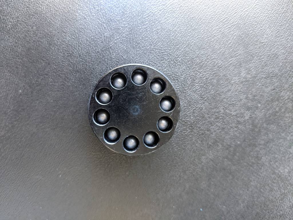

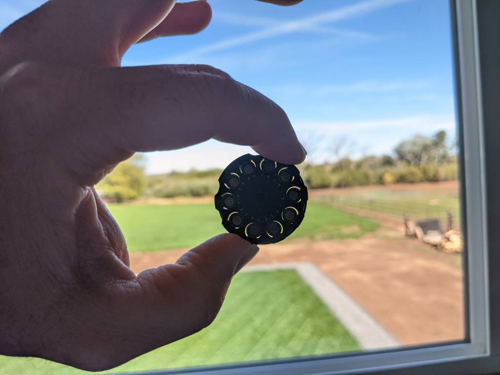

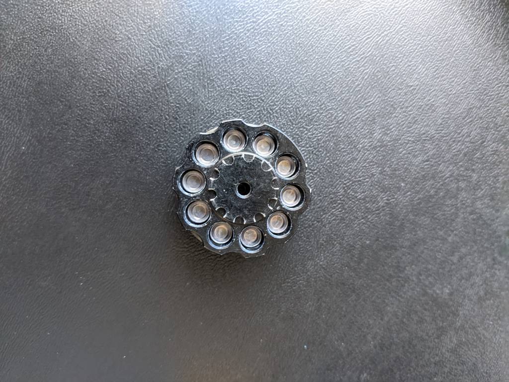

Early on the question of magazine usage came up and I'm not a big mag user so hadn't gotten around to even looking into it much. Until just now.
That's mags loaded with the 15.89 "Heavies".
There's a bit of light showing around the pellet wells, and if tapped hard or knocked against the palm of the hand they'll pop out. But the orings hold them in sufficiently secure enough for the gun to cycle and function as mag fed. For bench shooting or long range pesting, it seems to work just fine, but if a guy was to fill up the mags and stick em loose in pocket, some of the pellets wouldn't still be in the mag when retrieved from said pocket.
So, the .22 mags CAN be used in the .20 Veteran.

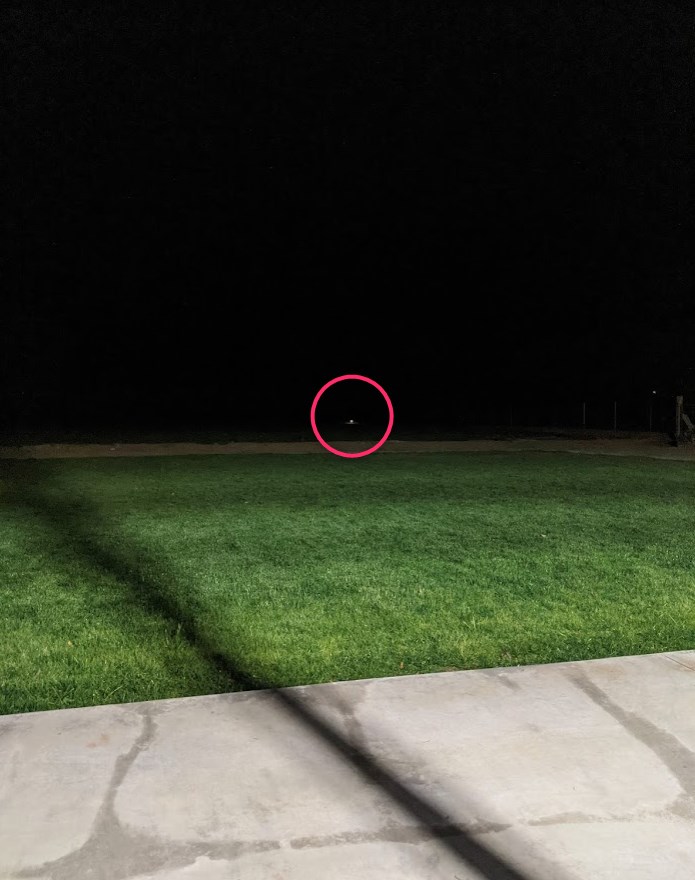

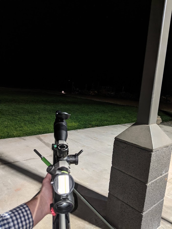

So that didn't go well but I was all set up so decided to throw some 15.89 Heavies down range. Just figured out that I can make this night shooting work pretty well with just some puck lights out at the target, shining into my 5 gallon bucket/rubber mulch pellet traps. Here are some photos I took from a different shooting session about a week ago (didn't take any just now).
First one I circled (red circle) the little speck of light @ 90 yards that is my pellet trap.
This next photo shows the set up a bit better, with a pellet trap at about 50 yards over the top of the gun.
So, anyway, just enjoyed the heck out of shooting the .20 Heavies @ 910fps @ 90 yards and wanted to share. REALLY accurate configuration. Shot a couple 5 shot sub moa groups (no they weren't all that good, but some were). Also got a case of the giggles a couple times when shooting at holes in the paper from previous shots and sticking another pellet in the same hole. Just a mighty dang accurate set-up to be shooting that type of stuff @ 90 yards with a small, small-bore airgun (not.25 or a .30 or even heavy .22s like the MRDs).

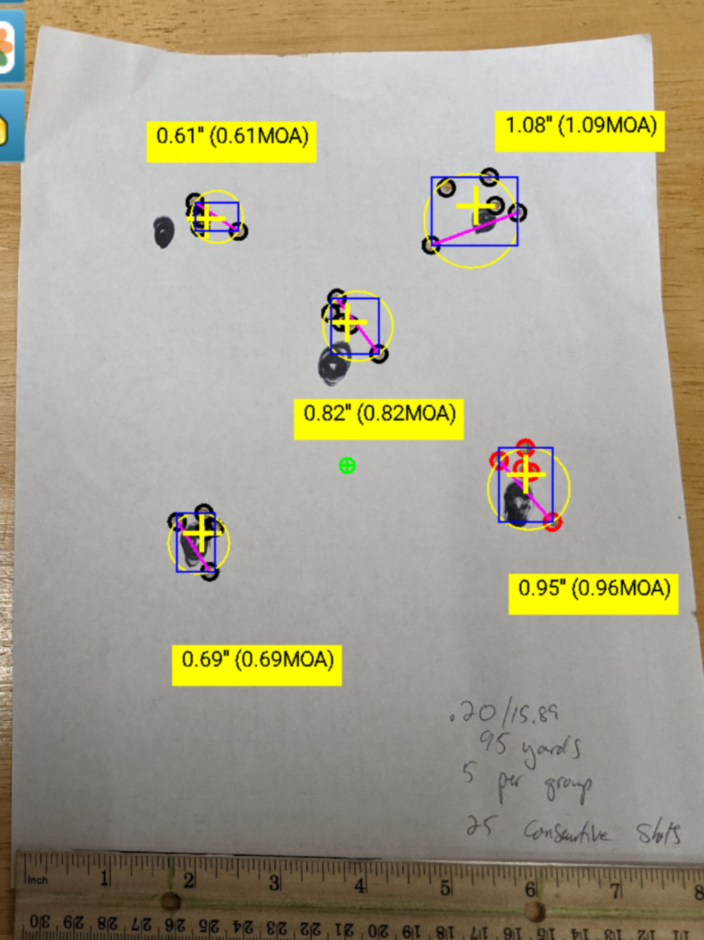

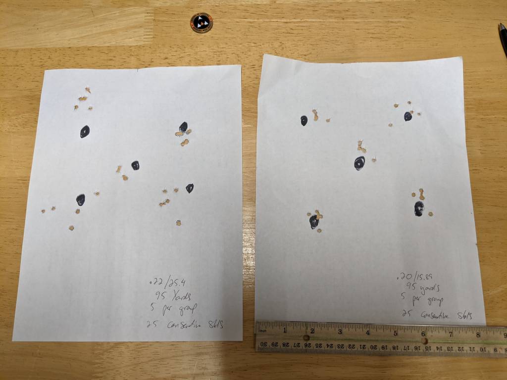

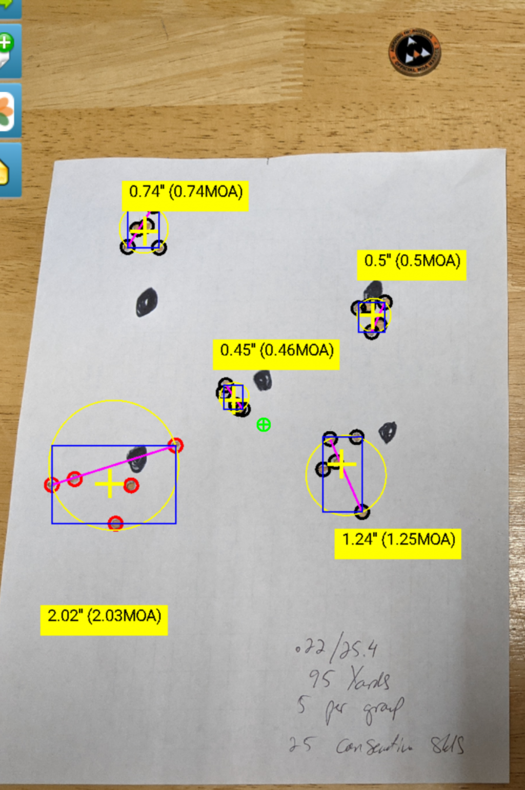

Did a little night shooting again about 10 days ago.
95 yards, took 50 shots, 25 with this gun and 25 with the Vet Long in .22. ABSOLUTELY perfect conditions, hardly any air movement and the air had that slightly damp feel to it, night dew coming on I think. Giving it a couple clicks after each five shot group.
5 groups of five with each gun.
Big smiles after those 50 shots.

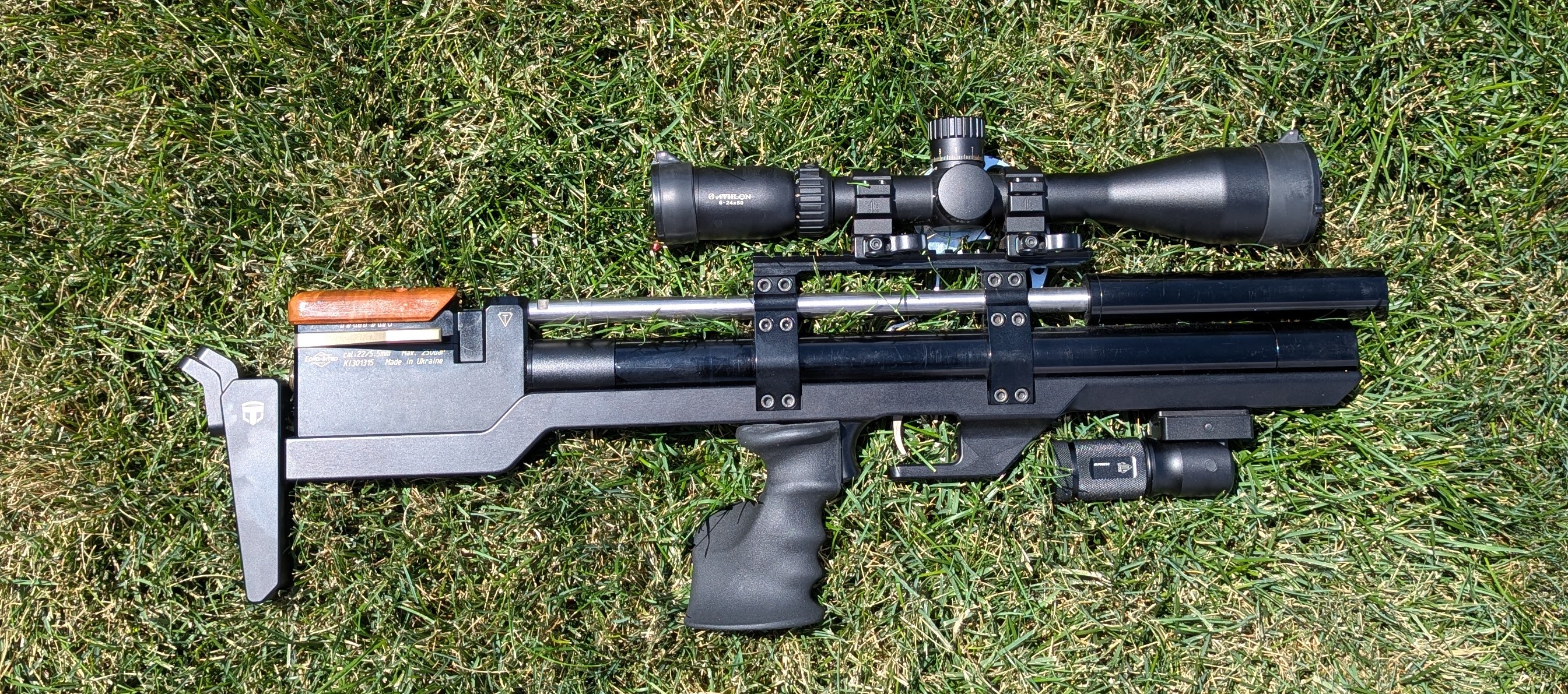

I realized about two weeks ago that I could add a plenum and not increase the overall length of the gun. In this case the plenum isn't for increased power, mostly just to have more air on tap. Adding a 20cc plenum to the "Short" version of the Vet offers the greatest percentage of total air volume increase, compared to adding a plenum to the Standard or Long. Taipan lists the volume as "air tank of 173 cc (without the regulator capacity)" on their website. Somewhat educated guess says the OEM Veteran plenum area is probably worth another 20ccs, so it's probably more like 193ccs. Add a plenum and gets us up to 213ish, probably. Just working our the ratios and should see an increase to something like 115-125 shots at 20fpe above reg pressure, and maybe 50 shots at 29fpe with the 15.89s.
So Colben and I just spent about 30 minutes in the gun room adding the plenum to "his" gun. He hadn't seen the insides of it or the mechanisms that keep it doing what it should. I let him do lots of the "wrenching" and we talked about how the gun works as we went through the steps. (plenum addition is really only about a 10 min project but we were just taking it slow and easy). Gassed it back up and held just fine. Went to the chrono station and got it to 800 fps with the 13.73s and gave it another 1.5turns and fps was 915-920fps. Turned it back down to 800fps for the 13.73s. Dependable as the rising sun.
Here's the new look, compare to some of the older pics in this topic to see the change. I think it looks a bit better now. Still only measures 25.75" long and still fits in the little briefcase shaped gun case. Just a sweet gun.
