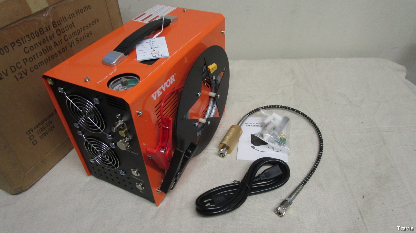

Well I am a bit surprised that I only received one reply to my question about Air Cooled Air Compressors and I thank Tom @tcarlson777 for his response. Anyway I did a lot of research on the internet and reading of reviews and in the process the Vevor Model 220/110/12Vdc caught my attention and I decided to buy one for myself as a backup unit. Now I can give my neighbor a first hand review of the unit and also let him use it. I choose this unit based on a number of factors but several main reasons are: 1) The overall reviews, 2) It has a built in power converter, 3) It has an automatic shut off gauge for any per-set pressure, 4) Quality of the machine itself, and 5) I was able to purchase it directly form the Vevor warehouse here in the USA.

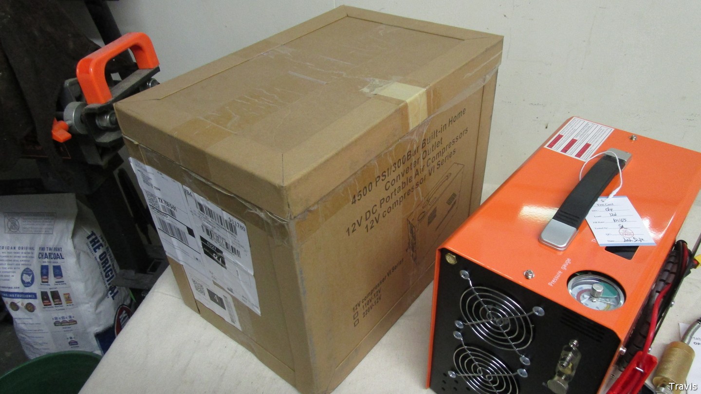

I received it after in 5-days and as you can see in the photo it was very well packed. Unpacking and having first impressions it appears to be a very high quality and came with the parts as shown. The Owners Manual is straight forward and covers the operations of the unit well.
After reading and following all of the instructions in the Manual, I connected it to my FX Crown ( 480 bottle ) which had 120 bar in the cylinder and set the Auto Shutoff to 3000psi and turned the Fan on for 2-minutes and then started the Compressor. Fan not too noisy and the Compressor also not very noisy, less than I had expected. It took about 1-1/2 minutes until the Auto Shutoff engaged and turned the Compressor off and left the Fan to continue to run. They recommend to allow the Fan to continue to run an additional 5-minutes. Only one very brief run but I am pleased at this point, only time will tell if this is a good unit. I will do additional updates as I get more run time on the unit. The only negative so far is the Quick Disconnect on the fill hose is hard to remove from my Crown. But with that said, the Crown Foster fitting is kind of hard to get to in the wood stock.
