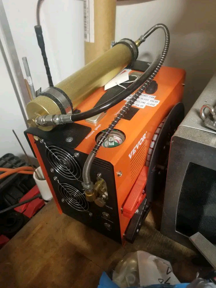

Here's my Vevor, I added a on off switch instead of unplugging it "Yeah I know warranty oh well it was a pain otherwise" I also fabricated some brackets to secure a 3 stage filter and used elbows and fittings suitable to the psi produced and to keep lines from hanging out and catching stuff in my garage work area. As stated from others, I also do not rely on the auto shutoff only although on mine it has always shut off at my desired settings. For the money I think it it is well worth it. I have though about installing an auto shut off found on standard compressors should'nt be that difficult. one more thing I ordered a longer high psi hose to go from filter to gun and a QD with a long sleeve so it is easy to connect and disconnect.

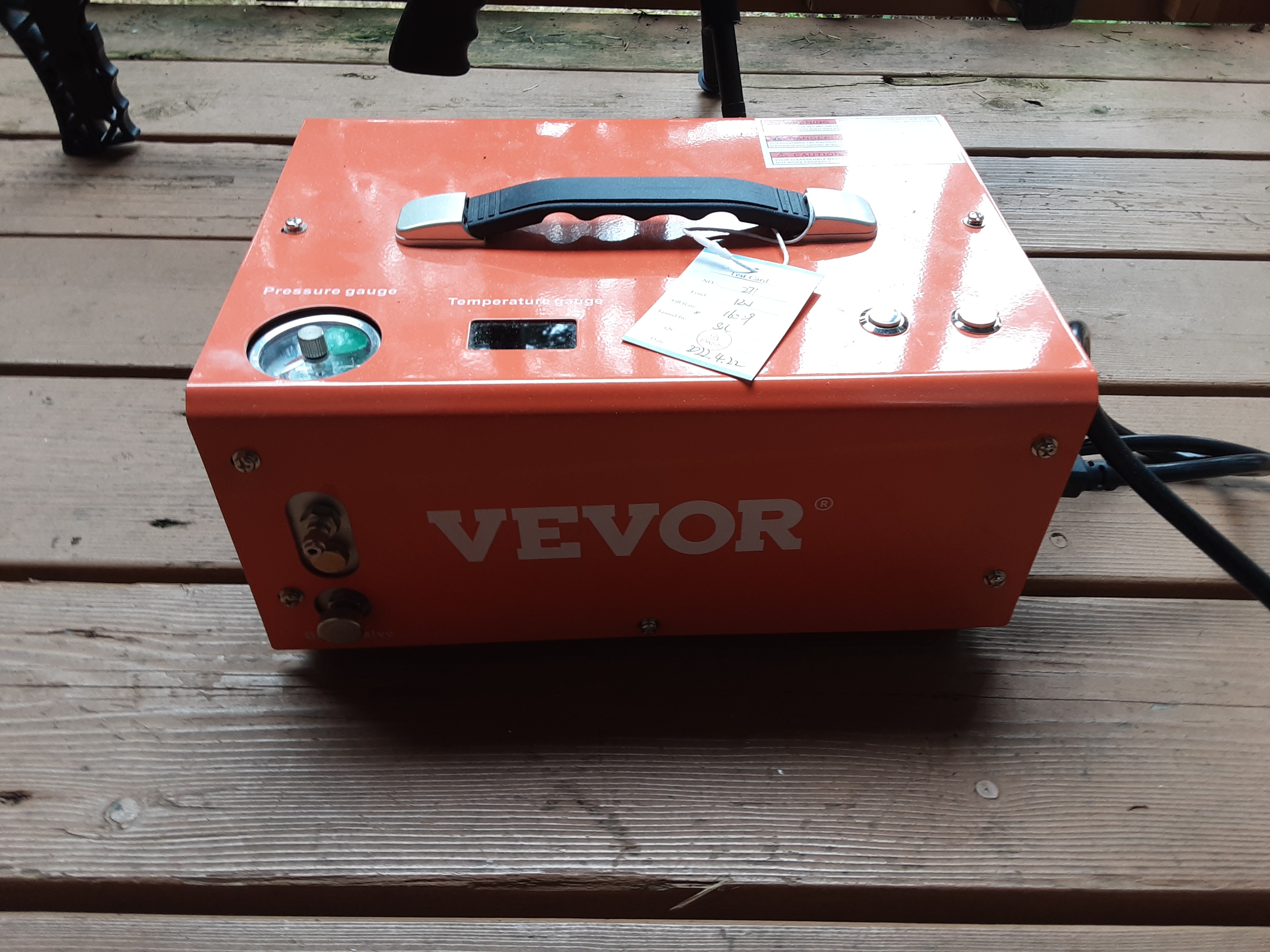

I purchased a smaller one earlier this year and it's been doing great. I did have to find a bigger Oring for the filter housing. The factory one leaked. Luckily had one out in the shop that worked. Hard to beat with a 1 year warranty and US stock. And a quality control sign-off.
Edit wanted to add. I took it outside for better lighting for the pic and when I came back in the pressure gage was glowing. Nice
