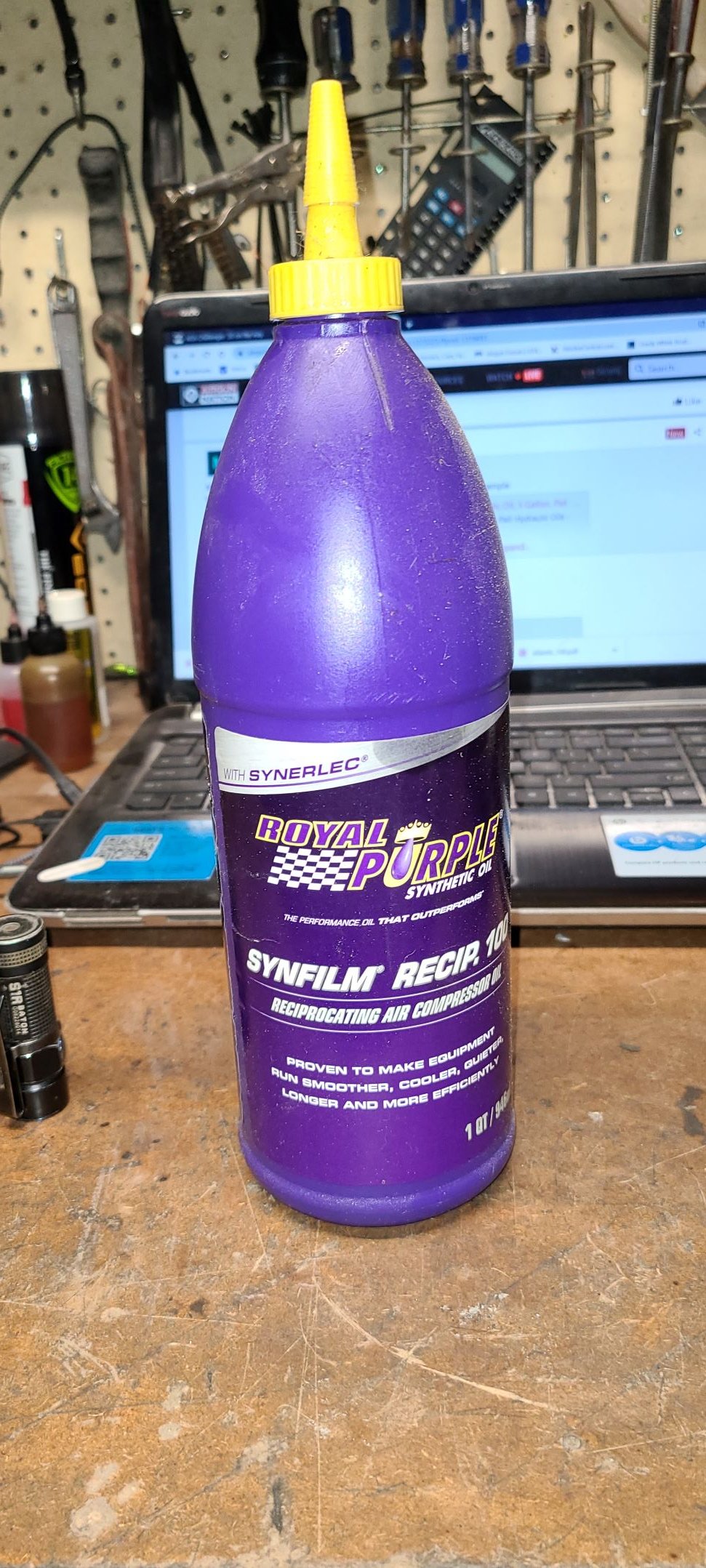

I agree your oil meets the specs of the compressor. But maybe there is a compatibility issue that is easy to check with another oil. This is what I have used for the last year. Use it daily and have changed oil 3 times. First change was after about an hour of use. I ran mine unloaded for twenty minutes to help break in.
