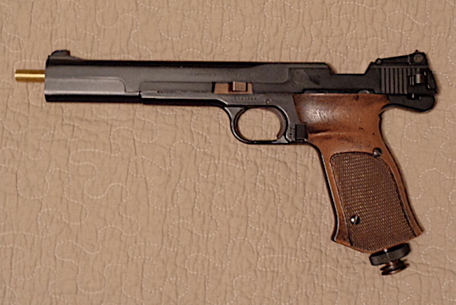

But besides other apparent good deals I came home with that I've since found weren't as good as I thought, on cleaning the bore of my new (to me) 78G I was shattered to discover a complete lack of rifling. DOH!!!

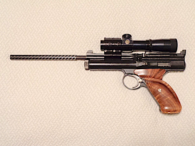

Luckily the barrel measured .375 outside diameter. "Luckily" because I still had plenty remaining length of a bronze Philippine rifle barrel blank that I'd chopped enough off of to machine a long replacement for my Crosman 600 that wasn't accurate enough to suit me with its factory barrel. A (real) carbon sleeve hides the otherwise glaring bronze barrel.
That project having been an excellent success, I hoped to repeat such success on the 78G, that is perfect in every way other than no rifling. The barrel work went well, and I made the replacement barrel a bit longer than the original (9" rather than 8.35") for the sake of a bit extra velocity.
While at it, I also installed a shorter but stiffer hammer-spring, moly-lubed the hammer and spring, replaced the original steel transfer-port with a piece of poly tubing, and installed a set-screw behind the front sight to anchor the barrel in the upper. Decided to not drill and tap the top-rib for a scope base until iron-sight testing indicates her accurate enough to do so. So, "How do she shoot" you ask?
Chrongraphing a new cartridge in 92 degree shade, 25 full-power shots with 14.3 grain JSBs went- Low= 458, High= 470, ES= 12, SD= 3, Average= 462 FPS/6.8 FP. Suffice to say I'm very happy with those numbers!
The long first stage of the two-stage trigger requires 16 ounces of take-up, and the second stage breaks very crisply with just an additional 8-9 ounces. AWESOME!
Though the factory adjustable sights don't give a real precise or 'crisp' sight-picture, ten consecutive three-shot groups at 25 yards averaged 1.47" center-to-center yesterday; and today five consecutive five-shot groups averaged 1.80" c-t-c. Yes, that was from a sand-bagged bench-rest; no, I'm not good enough to do that offhand!
Given the less-than-precise iron-sight picture, my aging eyesight and consequent slipping iron-sight skills, I feel the Smith accurate enough to justify scoping by drilling and tapping the top-rib for a scope base. My hope is she'll then average 3/4" 25 yard groups or better. Of course I'll post those results after I get around to scoping her, but might do more iron sight testing for a while first.
