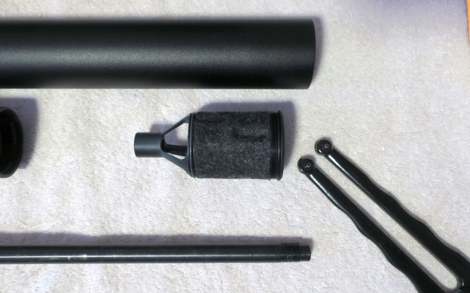

I get 900 fps average with the same pellets you are using. Hammer spring tension rod has holes in it and is located behind the pistol grip. Use a small allen wrench or similar to turn it through it's holes. CW is more spring pressure, CCW is less. Unscrew the barrel shroud. The barrel set screw is the allen screw you can access through the hole in the top of your pic rail in front. Remove it completely so you can see the detent in the barrel when re-installing the barrel. No idea about any adapters for the barrel.
My intent was to use my Vixen Standard (long) for a walk & stalk ground squirrel hunter. So I left it tuned for lighter 15.89 grain pellets, and I am shooting domes @ 898 and Hades @ 891 fps. I don't consider it to be loud at all shooting these pellets. In fact it is pretty quiet in my view.
A cheap pin spanner wrench is all that is needed to loosen the end cap and remove it and the shroud. Mine came from Amazon
https://www.amazon.com/gp/product/B085NV223X/
I don't see the DFL adapter on his site, but the photo below should show you how it would mount.
