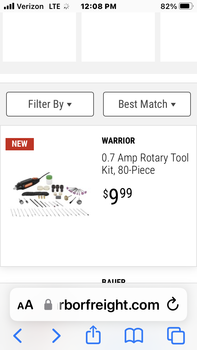

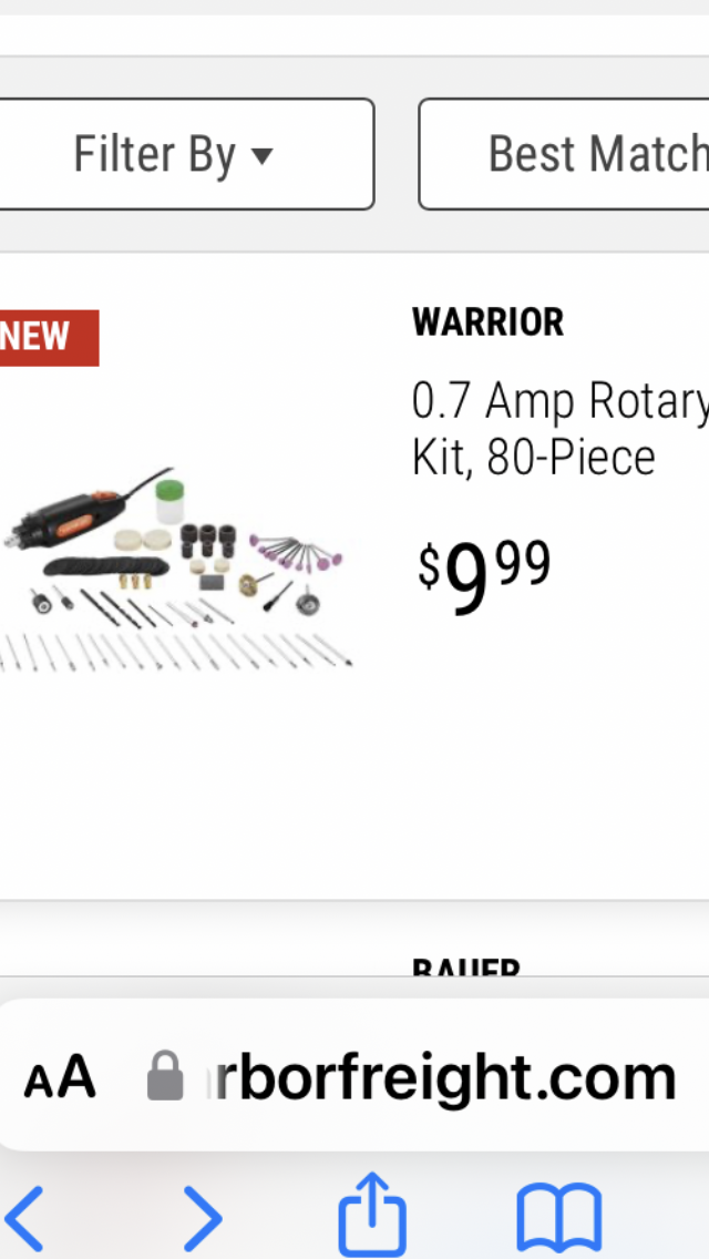

What's the easiest tool to cut the spring with? I don't have a Dremel etc, and would prefer the cheaper/easier options.

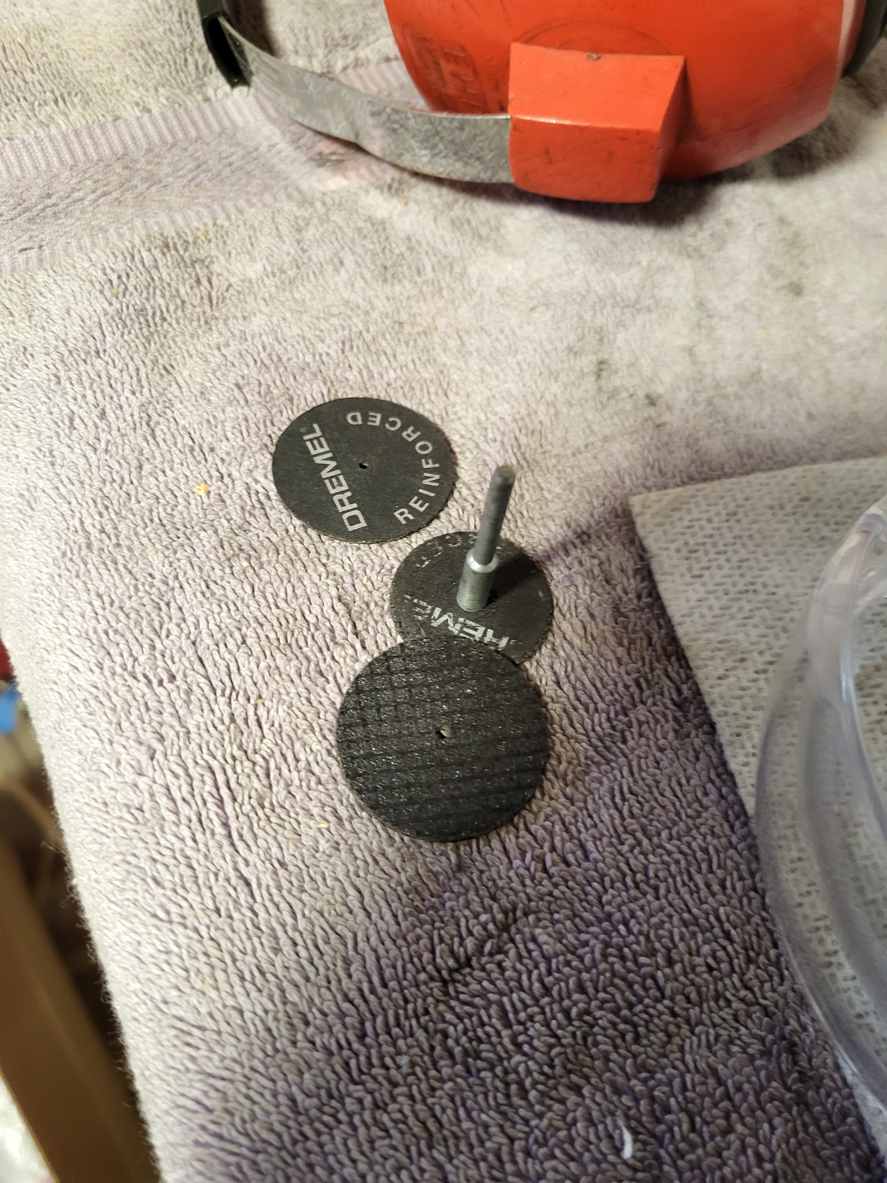

I'm another that uses a dremel and a cut off wheel. If you cut a little at a time you don't have worry about changing the temper of the wire. With an open end spring you don't have to go nuts with finishing. I just round the edges of cut wire a little so they don't chew up the top hat.
I usually go a coil at a time. Half coils don't usually make enough difference to be worth the time. That's just me.
