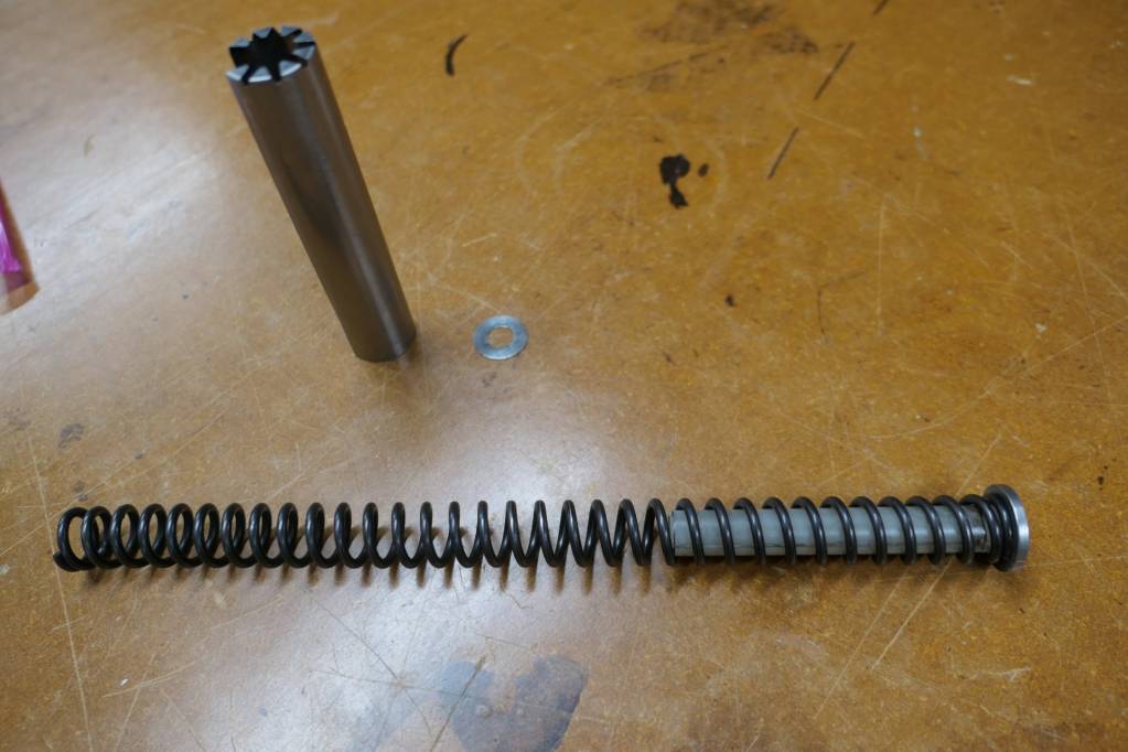

I ran into a problem installing a Vortek PG3 kit in my new HW95. The new spring assembly fits well into the piston and cylinder but takes high pressure to compress. I was just barely able to get the breech plug into the gun and assemble it. My spring compressor is a woodworking table and vise, it has good mechanical advantage.
Cocking effort was ridiculous, I didn't try to latch it to the trigger in case it would break something.
I reinstalled the original Weihrauch spring and everything works beautifully. The PG3 spring assembly looked none the worse for wear, no crumpled guides or scored parts that would indicate interference. I double checked the piston, saw no washers.
Vortek isn't answering their phone.
Perhaps they packed the wrong spring or the guides are too long? The PG3 spring itself is shorter than the original by about an inch. Wire diameter looks about the same. It's definitely much stiffer than the original spring.
Any ideas would be appreciated.

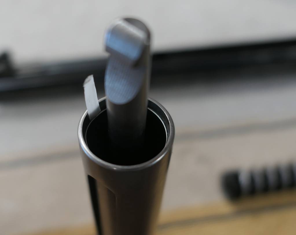

Hi, I put the Vortek back in and look what happened. Gadzooks! Obviously the piston liner was the problem.

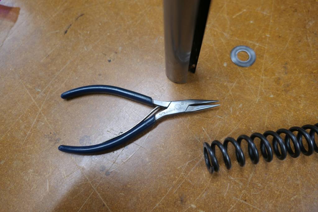

Is there a best way to pull the liner? Or just use a pair of smooth jaw needle nose.

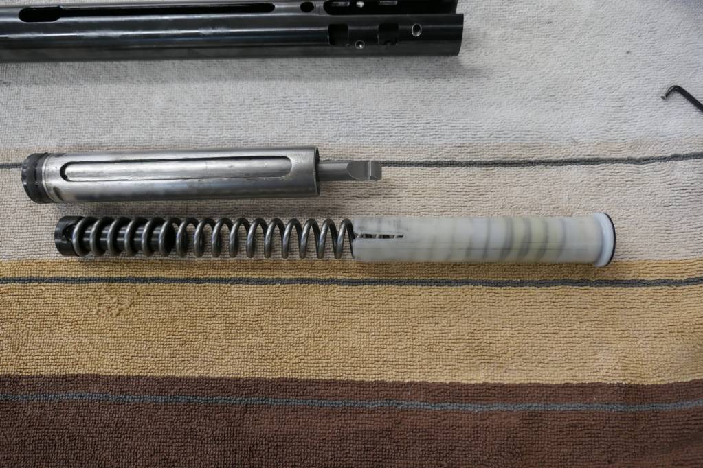

Ok. So what haappened is the plastic spring guide got hung up on the piston liner when I tried cocking the gun. The liner cut a slice from the guide.

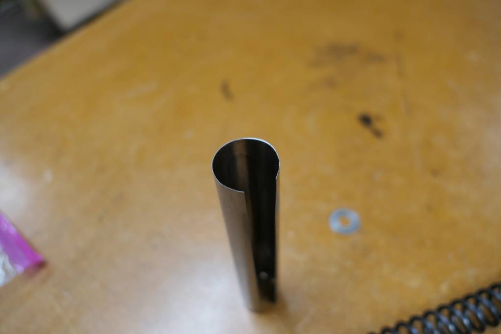

The Vortek instruction only says "Remove all items: spring, guides, washers, thin metal sleeve (if any)." The piston liner (thin metal sleeve) is not obvious, that's why I missed it. Grrr...
I pulled the liner out with a small needle nose plier that has smooth jaws. The liner is like a spring pin, it has a slit all the way down one side. First use a very sharp tool to lift a corner. Then get the needle-nose jaw under the liner. Pull a little at a time, alternating from side to side. The liner is mild steel, not hard spring steel. If you mar it, you can probably bend it back. It's important to save the liner and original spring in case the Vortek spring ever breaks.

The liner being visible in the cocking slot seems pretty obvious to me. Also easily removed if you just stick a small flat screwdriver underneath it through the cocking slot and pry/pull it out.

The piston liner is not obvious. I fiddled with camera position and lighting to make it show up in the photo.
