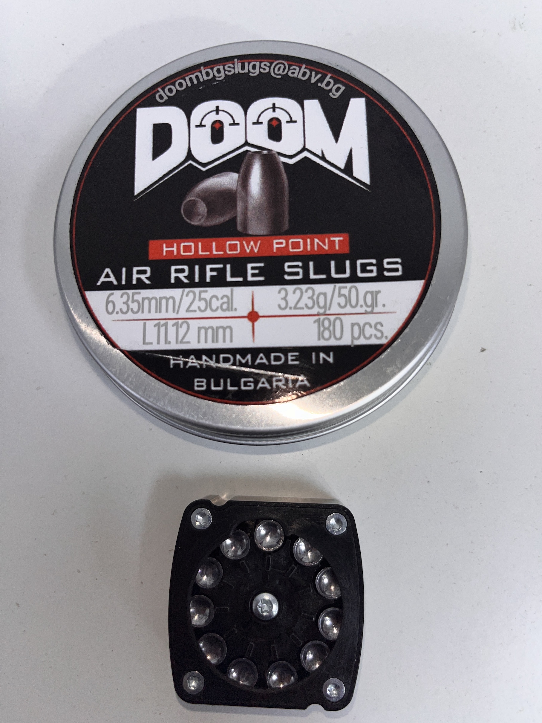

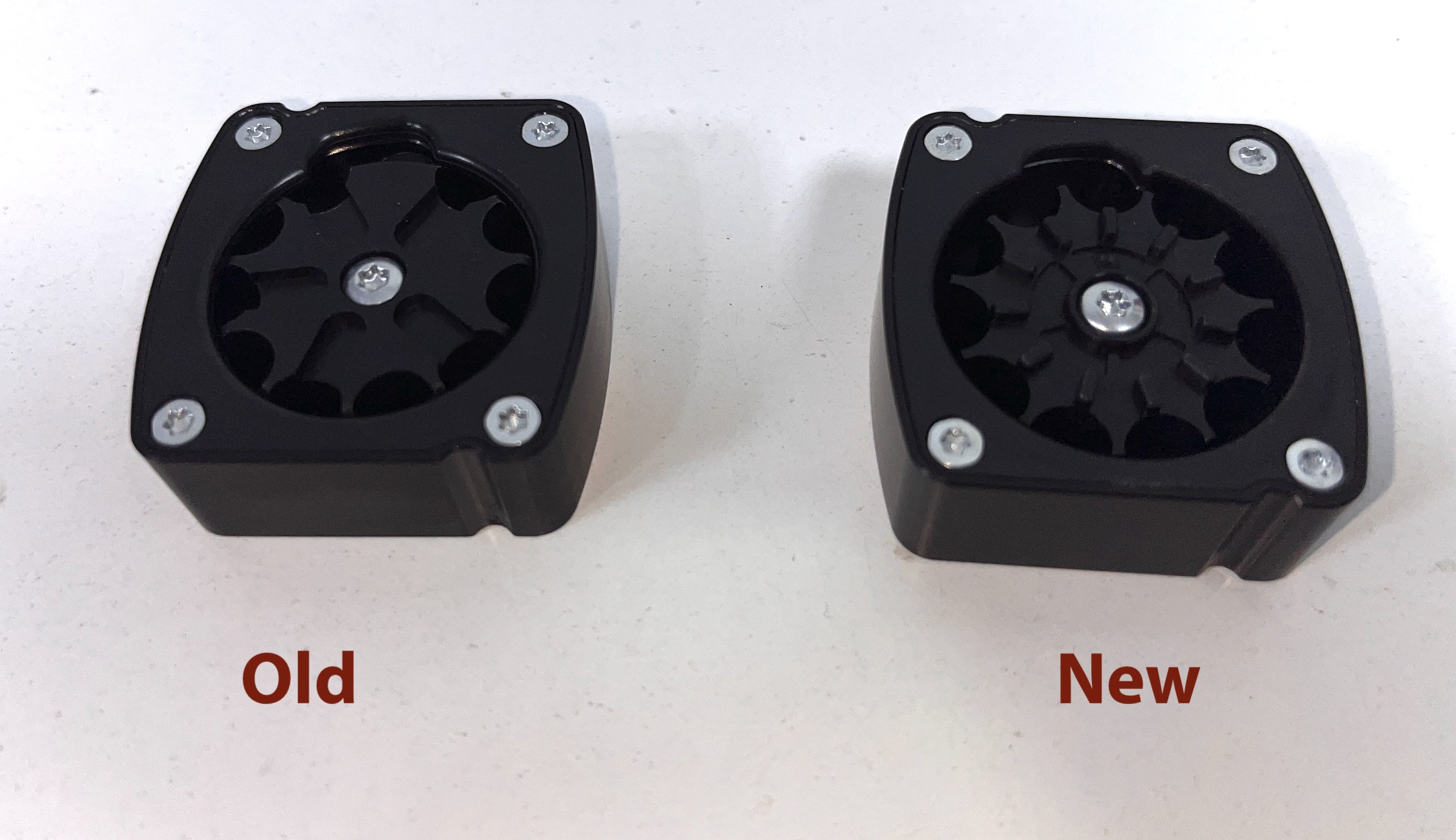

Since couple of months AGN ships all Vulcans with new magazines.. First only in .22 and now also .25 and .30
The difference - new magazines can hold one more projectile and longer projectiles
Here are pictures:
