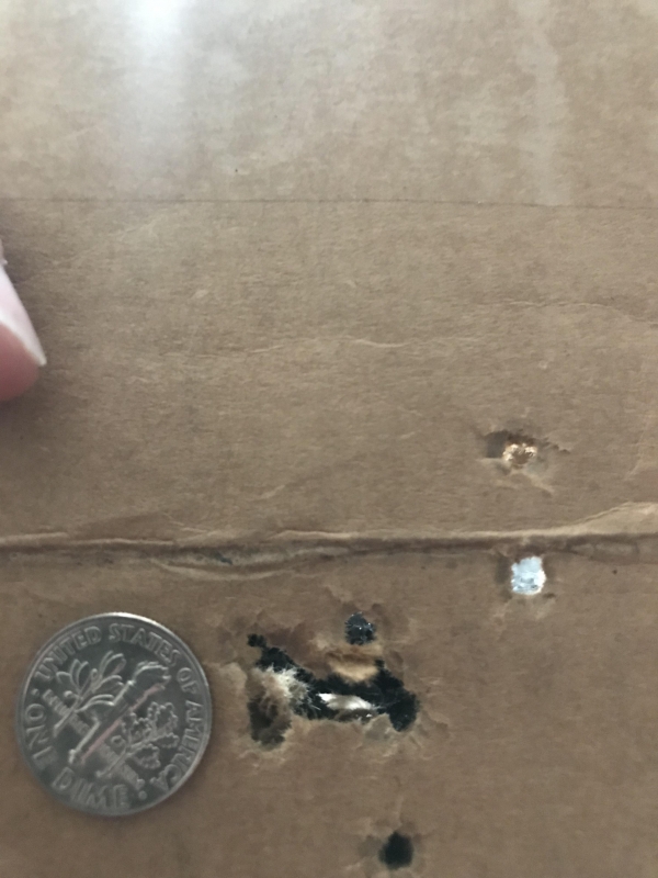

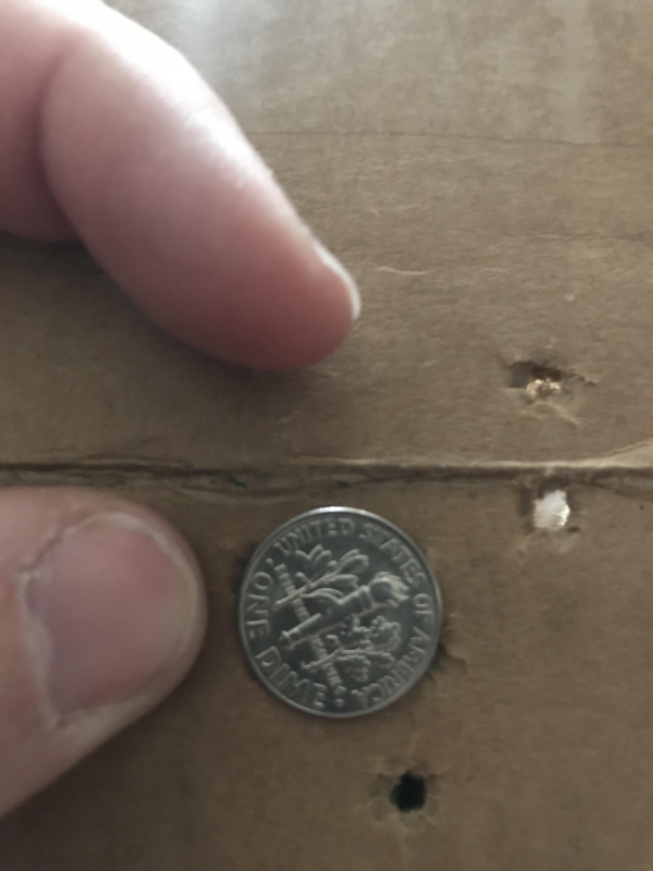

1543802002_17655332825c048c924ae791.99009557_6ED99715-9E49-4F42-881D-603FA7442F20.jpeg
That is 16 of 18 shots under a dime at 50yards. The r5m long is still breaking in and I don’t have a decent rest. I tunes the trigger a little and other then that I’m impressed with it slinging jsb mk2 heavies in a gusty 15-20mph.
