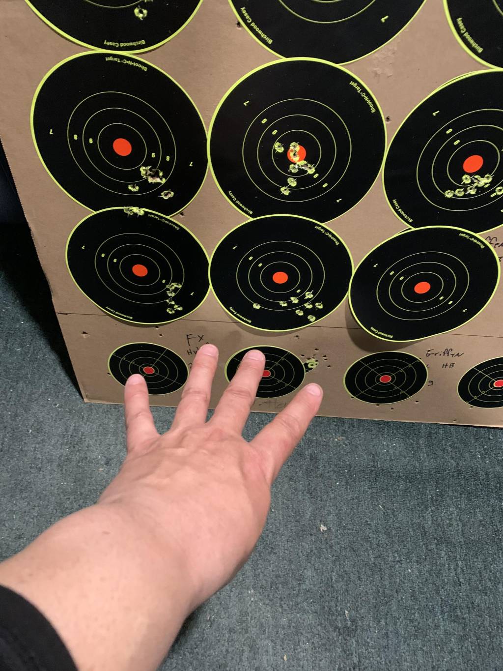

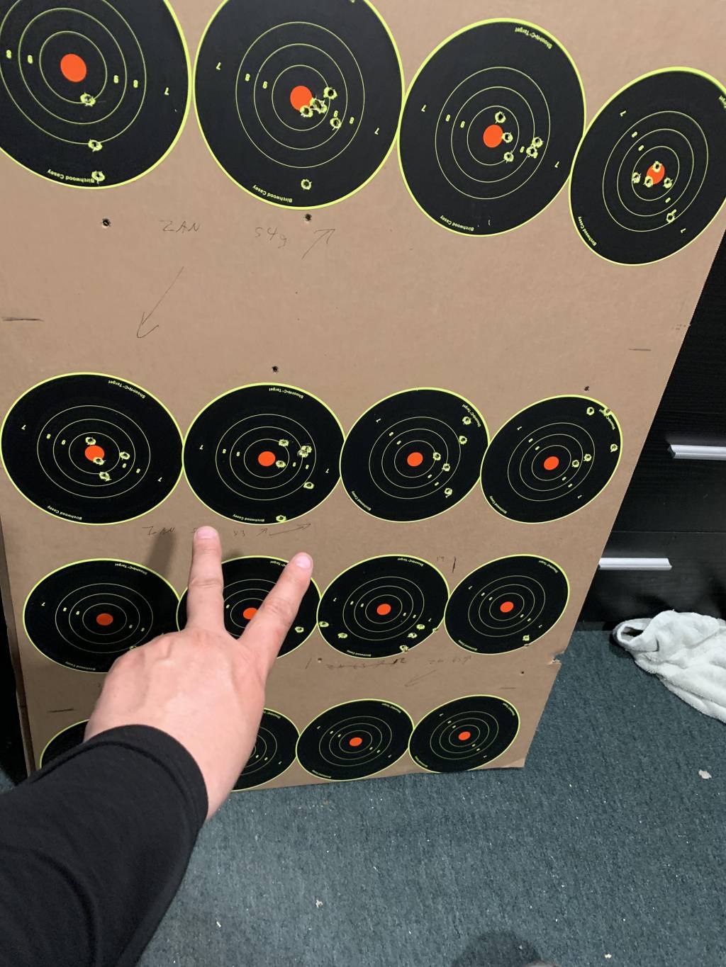

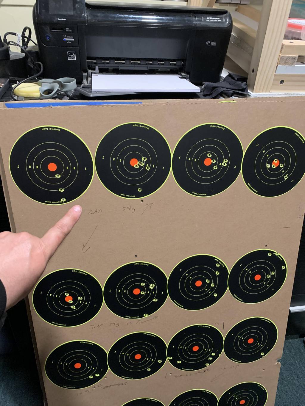

Vulcan3 in 30 cal
90 yards with ZAN 54gr (put wrong sleeve in pic). My worst groups were under a quarter size, best groups under a dime.
Factory tune.
...buy the ZAN 54gr and 59gr first...save some $$$

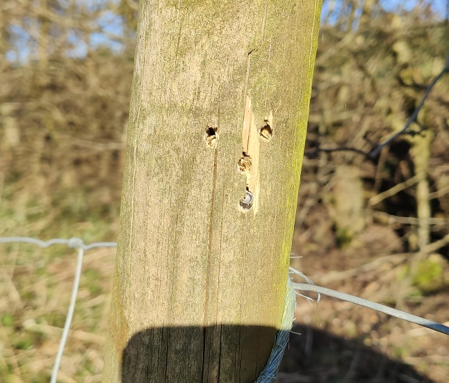

I have tested at 75 M today, and both the 13.43 KO slugs and the MRD pellets ( shooting 500 mm - .177 ) did pretty well, having no problems hitting a pellet tin lid screwed to a fence post.
Wasent super accurate but i was also shooting off my toypod and the shoulder + i think the speed was a little on the low side, so generally pretty happy with the result, the wind was very light so i cant blame anything on that.
The eagle / falcon / whatever with a 4 foot or so wing span circling above the field for a while as i was shooting,,,,,, that was quite nice too

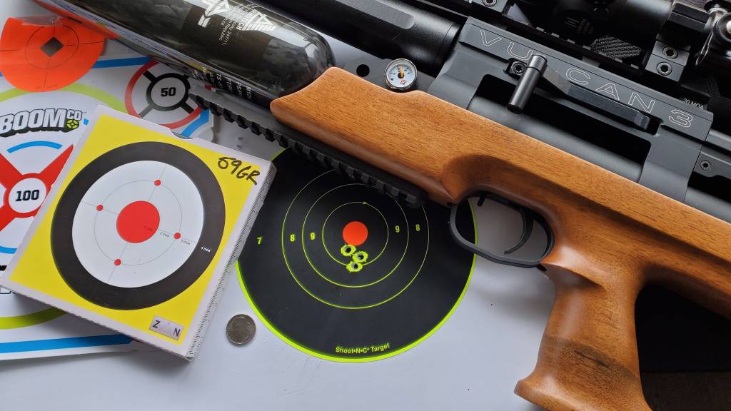

i have the Vulcan 3 but i went for .22 (5.5mm) i have some boxes of zan slugs 26g & 40g as i,m hoping mine will be a slugger main quarry is rabbits with few rats too, i have had the rifle sat here for well over a week as i,m waiting on my air tank to arrive i have fitted a thermion xp50 so the suspense is killing me, Had a 2 uragun 2s one in 2.5 and one in 3.0 high power 18 months ago what brill rifles these were will keep updated if anyone’s interested ?,

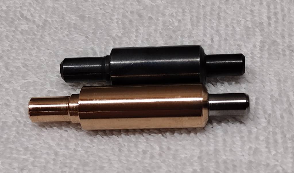

54.5 can only reach 950 with the hammer spring at maximum preload. I feel coil bind just as the cocking lever reaches it's limit.
I've made a new hammer from phosphor bronze for the extra weight and gave it extra length so I can trim it to find weight that works best.
The valve and port will get work as well. I'm waiting for some new tooling to arrive tomorrow.
