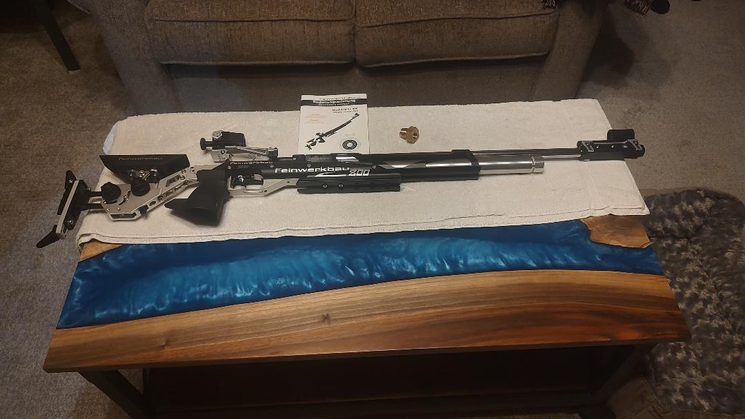

Thank you for the kind words John. You nailed it, I know very little about any air gun. I've been reading up on this Feinwerks 800 and impressed with what I'm reading. I'm looking forward to shooting it with a full cylinder of air. I believe the cylinder is good until the third quarter of 2025, its marked lll/15. So I should be able to have the cylinder charged at a dive shop.
