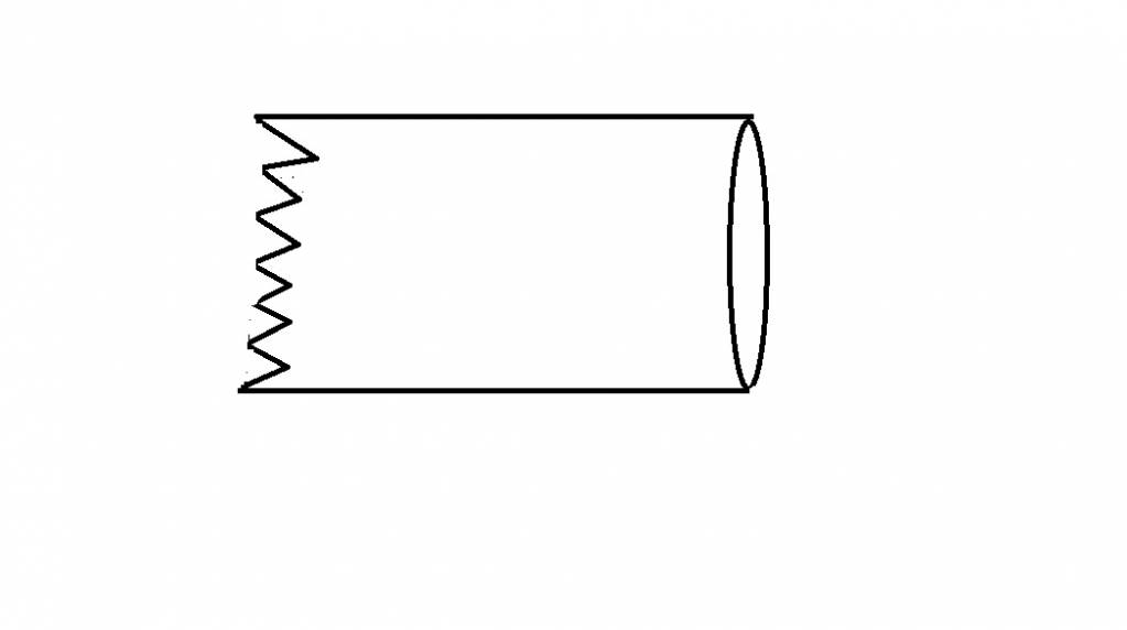

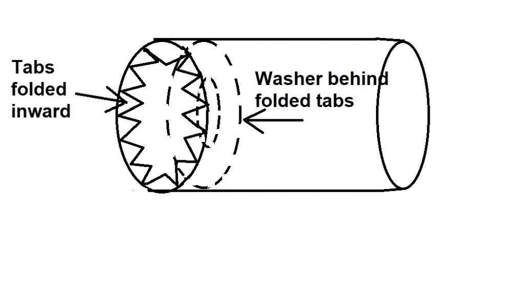

I added a sheet metal shim in the form of a tube to the inside of the piston in my 97. If I recall, the shim was .003 or .004 inches thick. I cut and folded tabs inward and backed the shim tabs with a washer of proper size, locking the shim in place. The metal shim then slides into the piston to take up some area space but not enough to hinder the release of the spring.
This was a red neck Vortek spring guide of sorts. I also made a tight fitting top hat for the spring with a center hole that fit the piston's shaft with little room to spare to stop any wobble at the end of the spring and guide it on the straight and narrow.
The spring with top hat then slides into the piston with the fabricated sheet metal sleeve and washer already installed and the piston goes into the gun's piston sleeve The preload of the spring keeps the washer and sleeve butted hard against the end of the piston to prevent the fabricated sleeve from moving.
Here are some crude MS Paint drawings to show how the metal shim was set up. The first drawing is the shim as cut. The second shows the bent tabs and the backing washer.
The mod made the gun a one holer at 40 yards and eliminated spring vibration.
