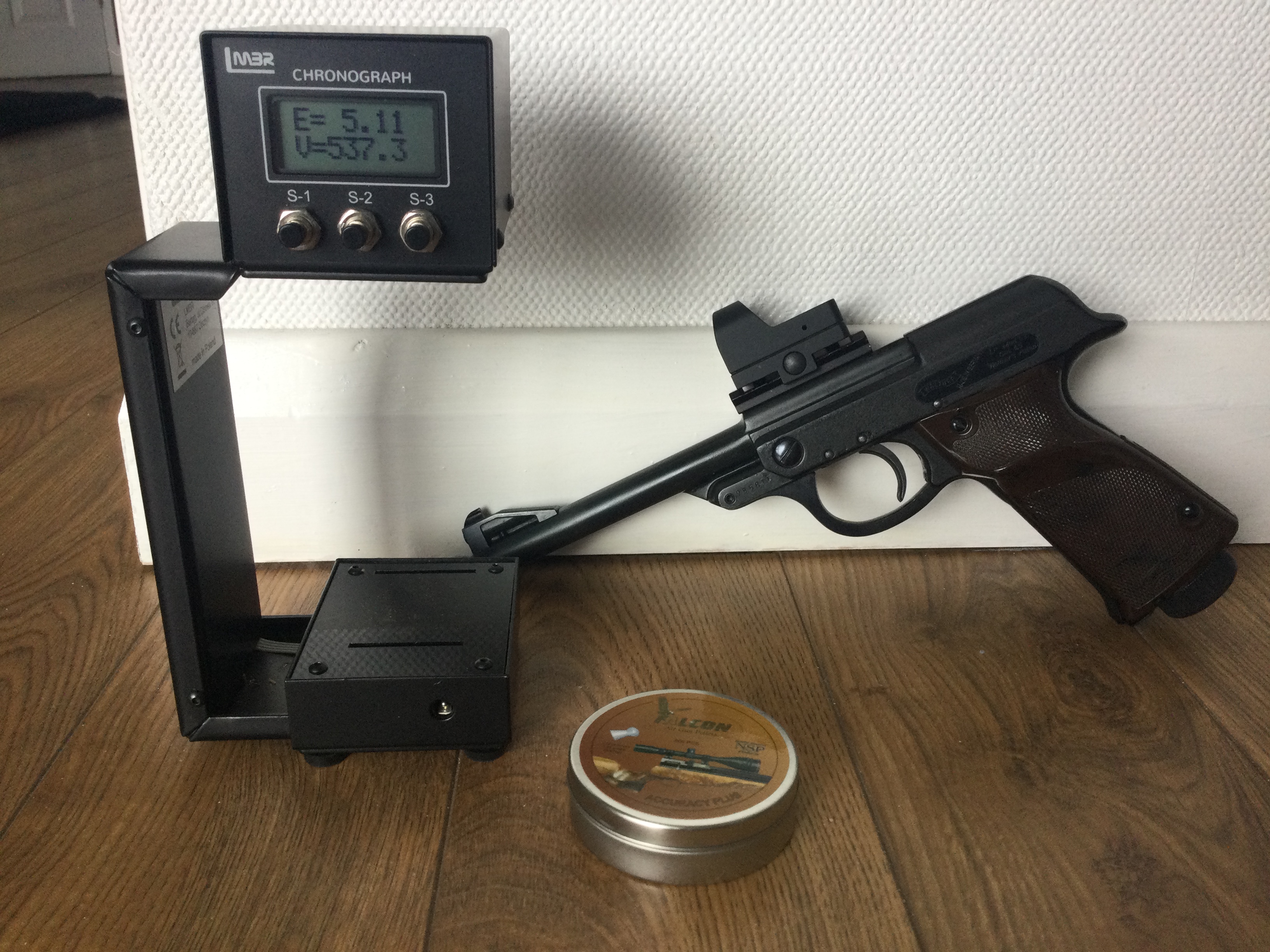

I decided to go with the silicone, the most inert, less subject to oxidation. I put a few drops in the exhaust port last night, and set the gun up so it would drain down into the cylinder, Partially, and I mean manually cycled the piston a few times, stopping before a cocked position then took it out for a few minutes this morning, Cold and wet so did not stay but for a very short time, It's putting out a rather consistant 325 fps, don't know what is normal for that gun and have been unable to find any specs. Makes a soda can jump nicely.
Can do 440 fps Stock with light Wadcutters.
Tuned….none std…add another 100 fps to that.

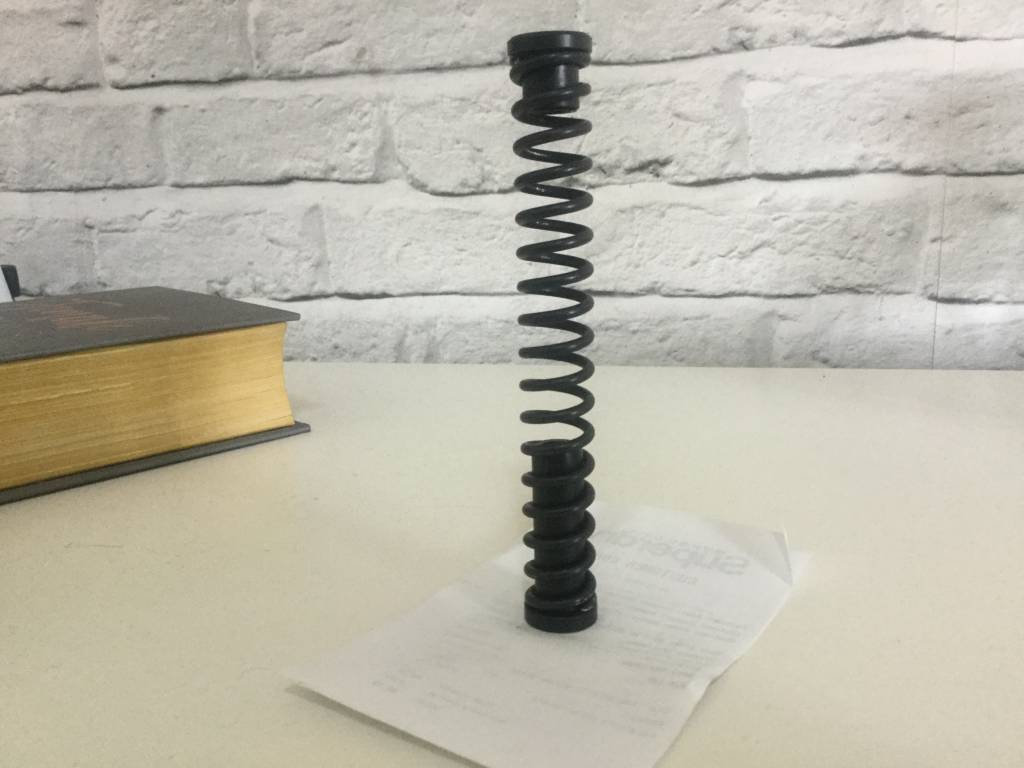

Notes on kits.
I designed the original kit, but having my idea copied and put into production by someone that did not do as i had described.
The kit is not too bad, but the individual wound his own mainspring which is not the best and made the guide way too tight.
You could buy the kit and chop a Cometa 50 or even better HW30 mainspring to 18 coils to replace the poor spring.
The kit gives 50 fps, the HW30 spring and kit guide, or home machined guides can make 70fps +
This puts a decent 430 - 440 fps 53 into 500 fps territory.
The unskilled should probably stop there.
My own kit which Proteks copied....
But mine having used a HW30 mainspring (Probably the worlds most reliable long lasting mainspring) chopped to 18 coils and flattened one end
Delrin guides to slip over existing grip cap guide.
