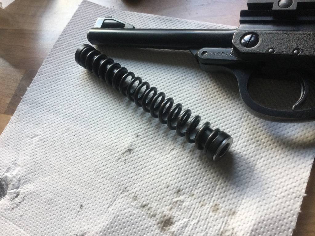

You will not get much better than 20 fps variation while staying with the OEM duel spring set because the main outer spring has to ride over the smaller inner spring.....essentially acting as the worst possible guide rod for the larger spring.
Much better to go with how I run the gun with a HW30 mainspring on a delrin guide set....approx 5 fps variation and 80 fps more velocity.
