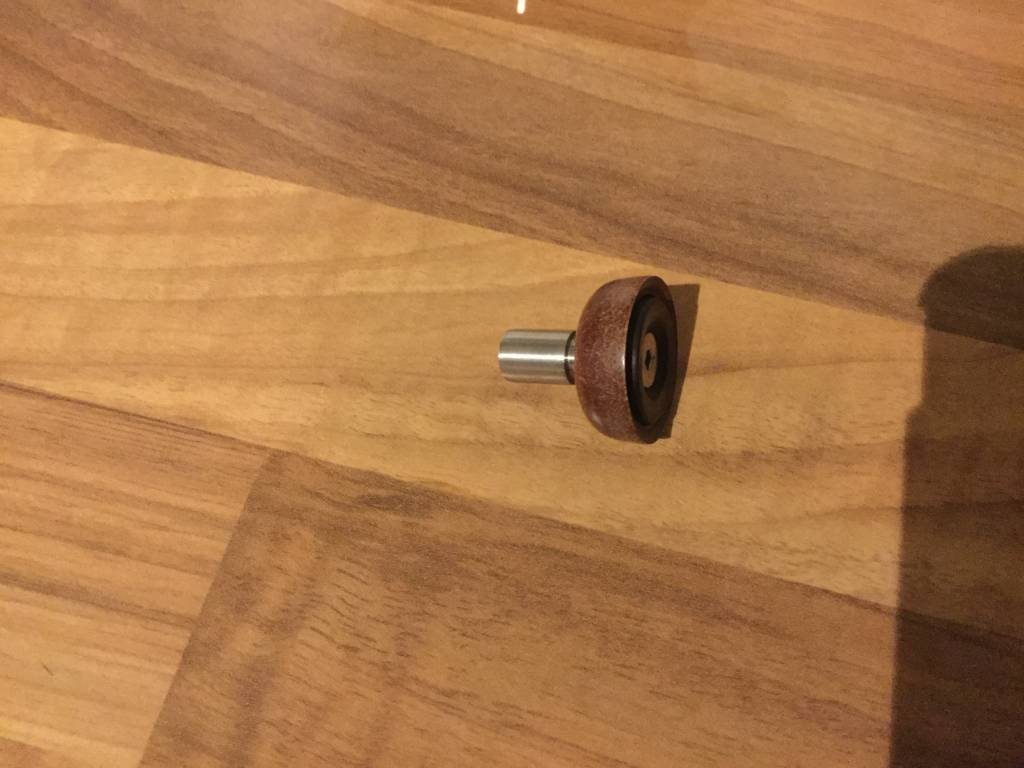

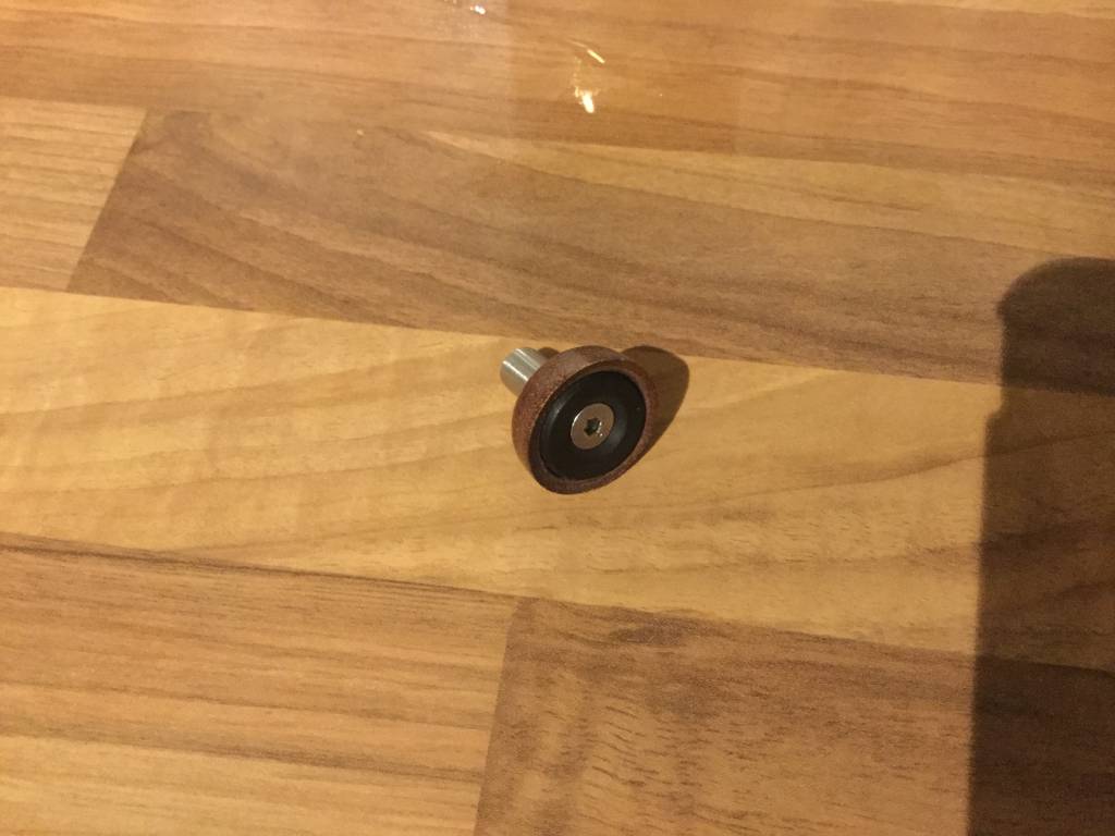

Never ever dry fire this pistol. It will destroy the leather seal, but more importantly may crack the sear groove flange at the front of the piston.
A rare accidental dry fire will be ok but repeated dry firing will cause damage...
It sounds like a re-seal is in order.

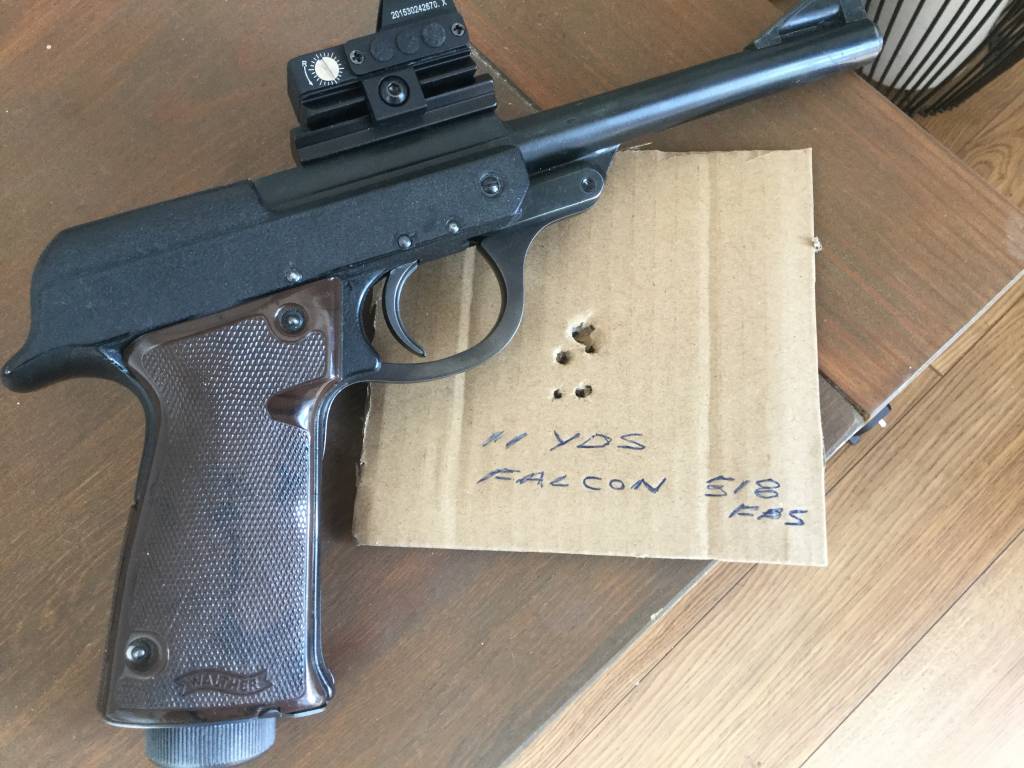

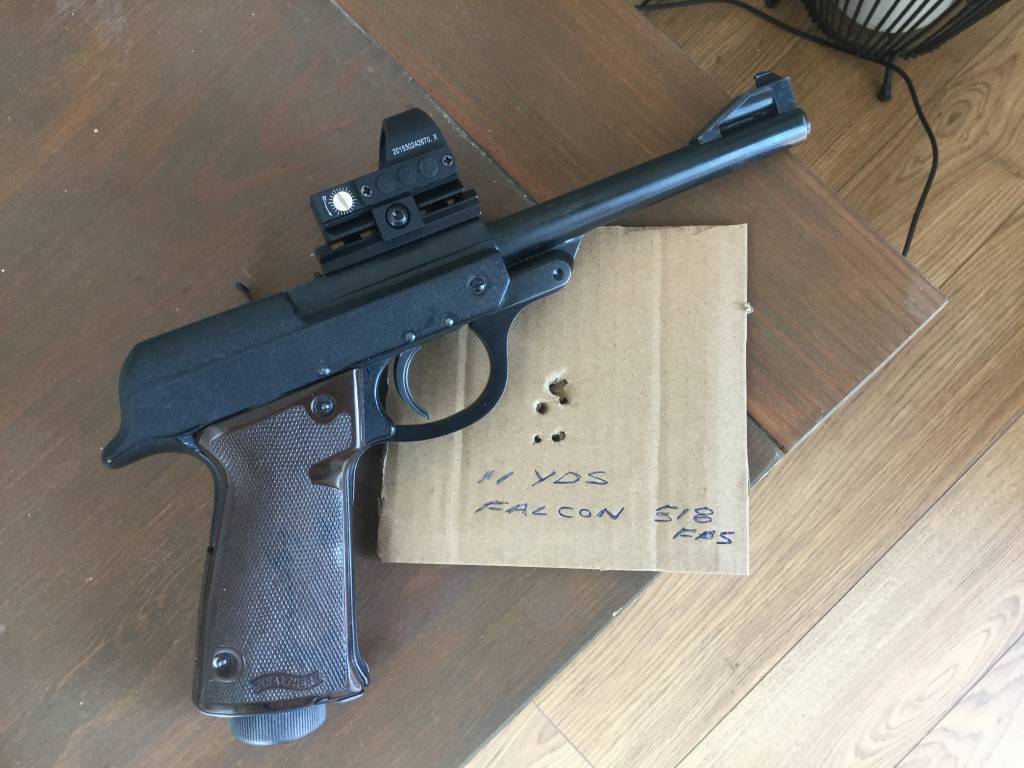

Sadly it's not a match pistol for serious competition use but arguably the most accurate recoiling springer pistol.
I usually edge out the groups made with Webley Tempests and HW45s.
