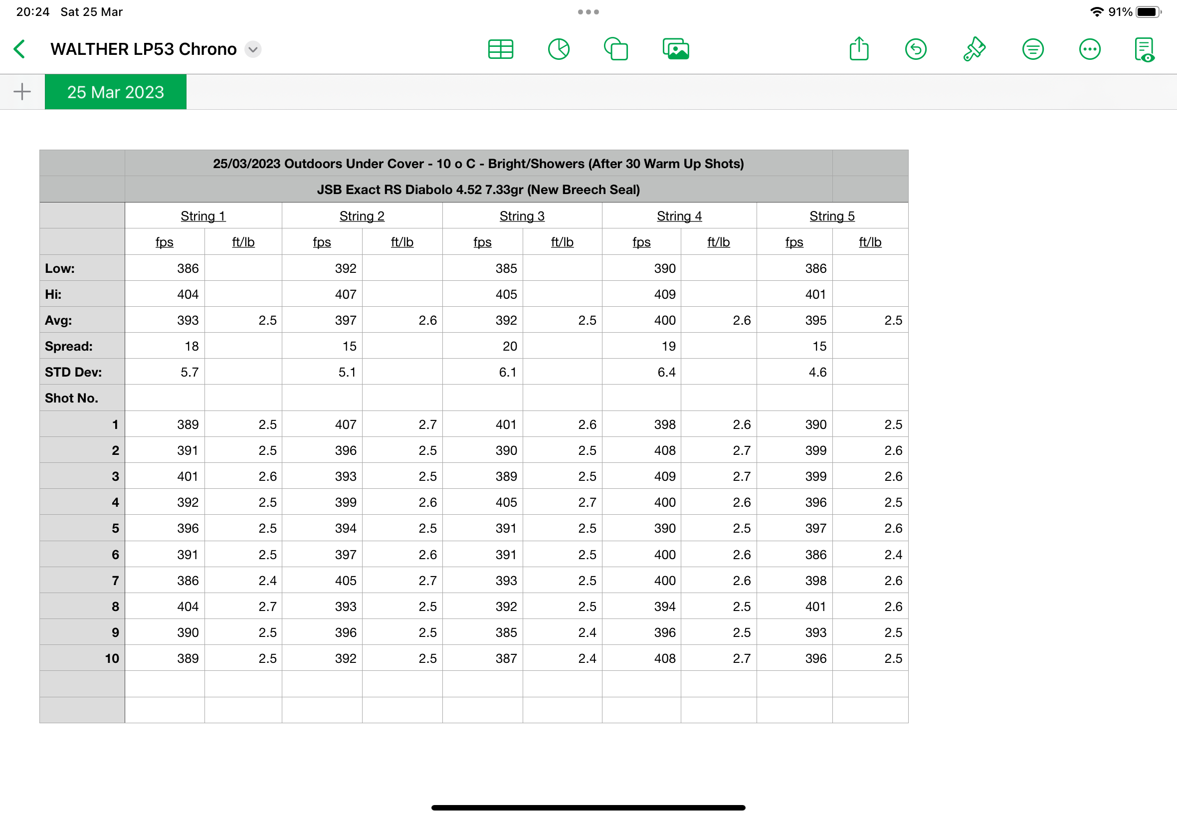

For what its worth guys, here are the results of my chrono session at the range yesterday. The pistol has had nothing done to it apart from fitting a new breech seal and a bit of neatsfoot lubrication for the original leather seal.
Thanks for posting your results. My LP53 has the TR Robb piston head installed, however those numbers look very comparable to mine. Here are my numbers with 7.9 Premieres; 385, 371, 371, 380, 385, 351, 378, 376, 376, 376, 378. Ave fps in this string; 375. By using a pellet insert, velocity climbed to 410.

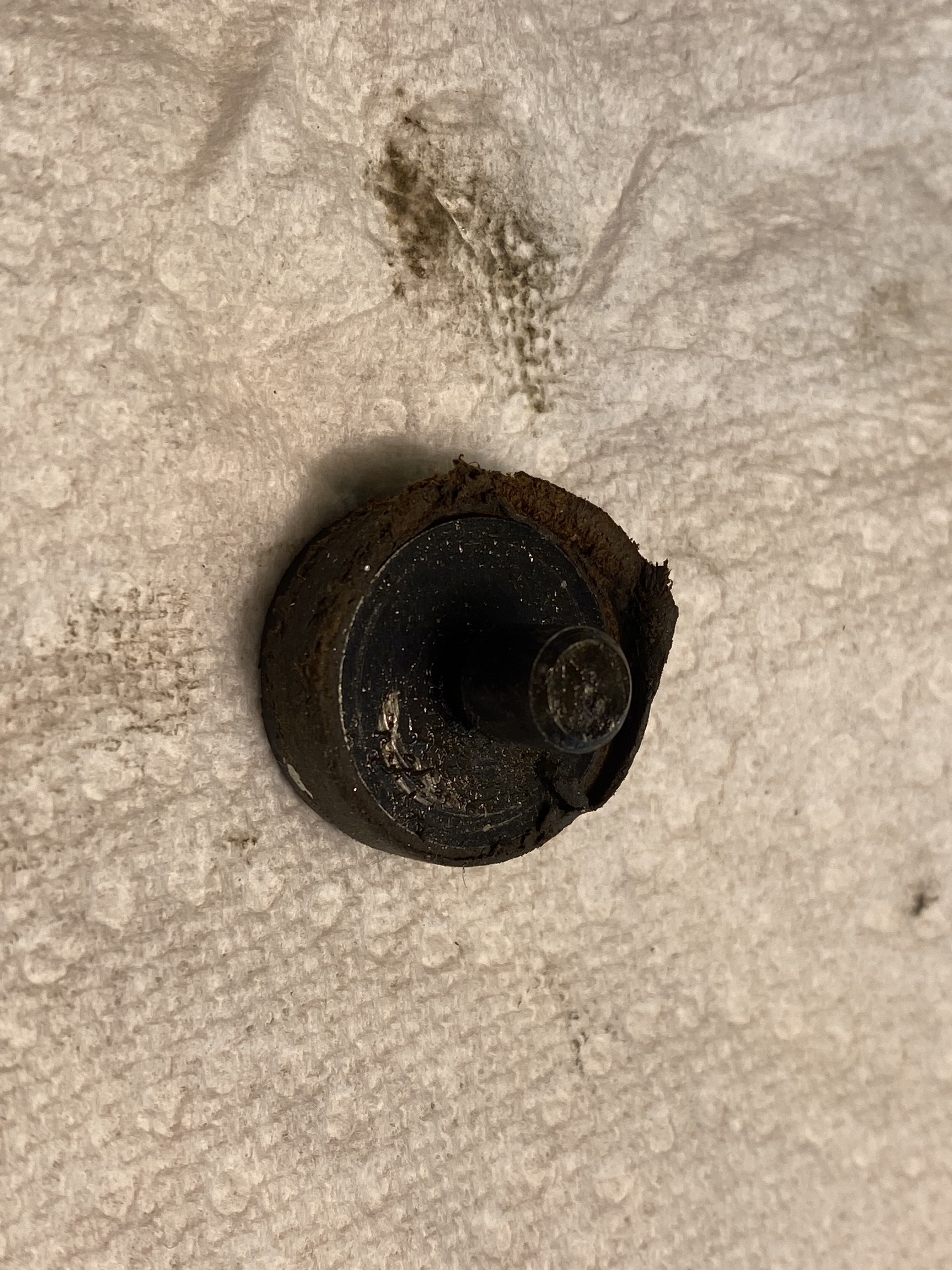

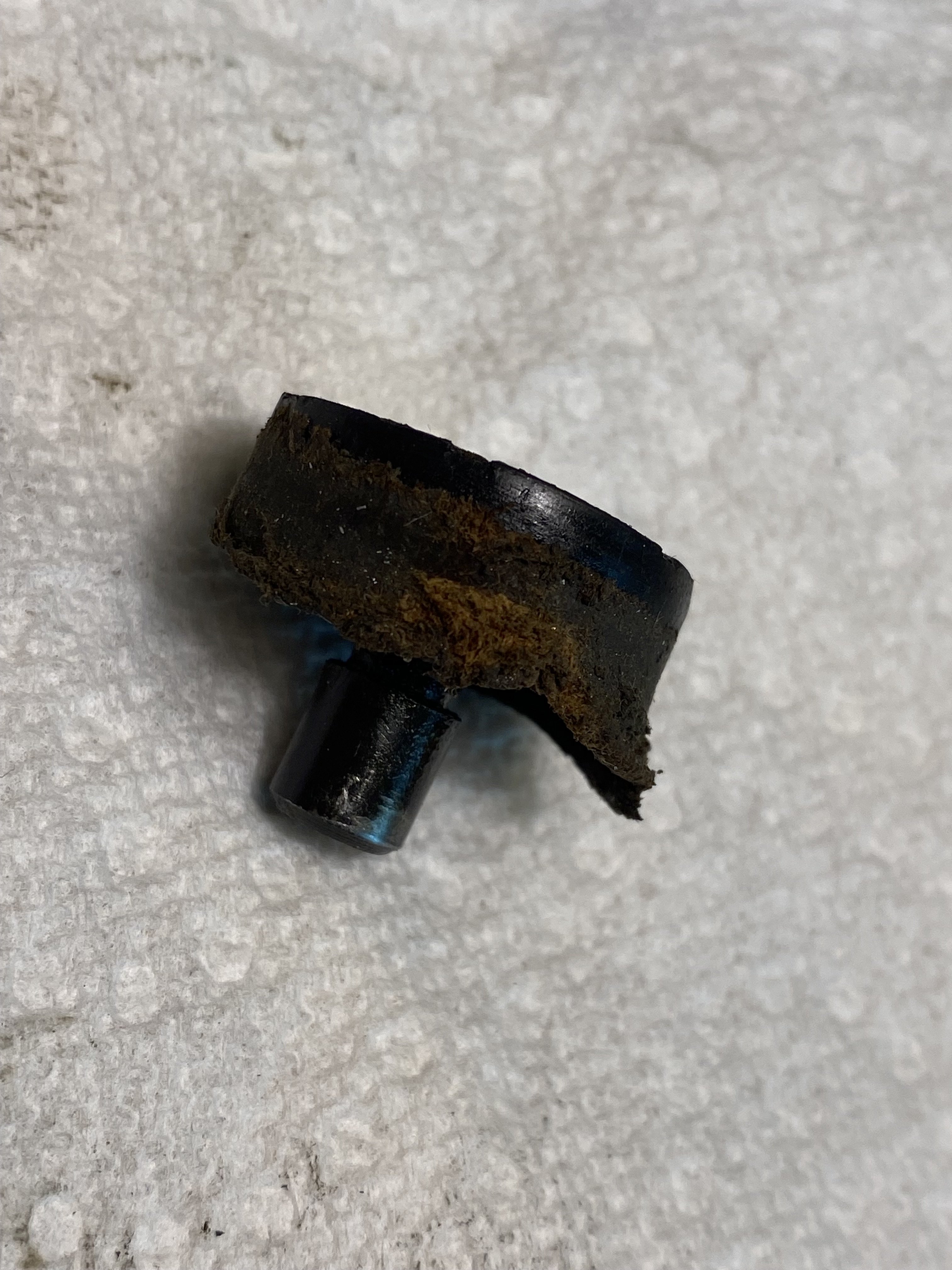

I took it back apart this morning and here is what I found, Installed a new leather piston head. oiled it with some silicone. I still need new breech seals the one in it now is flat and hard, probably not sealing much if any. I did not wait too long and tested it over a chrono, still about 300 fps. I cleaned the cylinder chamber out with mineral spirits, let dry and sprayed with some dry teflon for starters. I'm hoping after the oil soaks the seal a bit more and I get new breech seals it will get some more velocity back. I injured my left hand last summer and really have a hard time putting that trigger bar pin back in as well as getting the mainspring cap started.
The new leather seal is more of a cup, and uses a leather inner washer, instead of that rubber washer on the end, Hopefully it will help giving more volume and velocity,

Still no breeh seal, but with new piston head seals velocity jumped from about 295 to 350 fps. I could see where it was blowing some oil out the side, around the hard flat seal in there now. I have a couple on order from thecountrystore in the UK , but who knows when they will arrive, and finally found some over here on this side of the pond, they are supposed to be delivered next Monday, so am hoping for a bigger jump in performance.

Well USPS came through and delivered the breech seal today. The old one was extemely flat and had flattened on both sides so it was totally square edged. Popped the new one and gave the gun a quick test and was somewhat dissapointed. Velocity with remains about 300-310 fps, no change and that is with new leather seals. I am hoping the new Proteck spring will arrive soon. On Mar 20 they said it had shipped the previous week.
