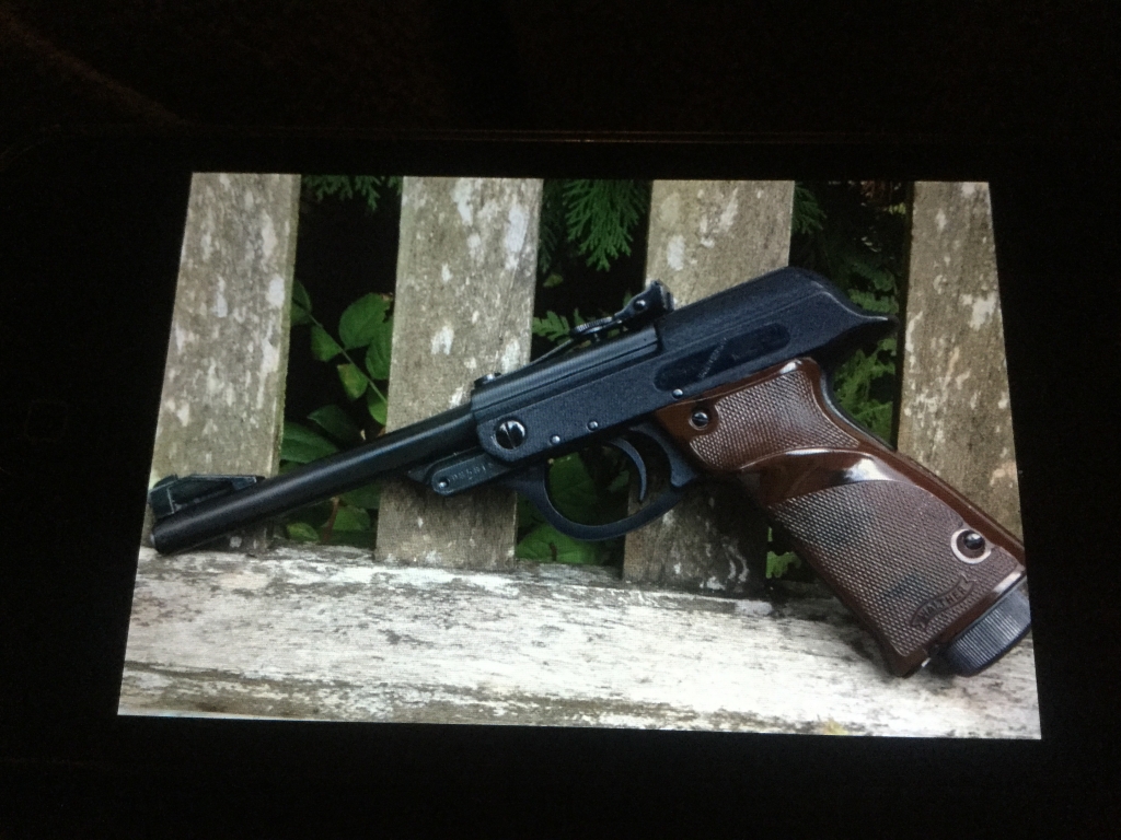

Walther LP53K
This is my LP53K K stands for Kurtz ..short version..
Fully modified internals and transfer port returns in excess of 500 fps with most regular pellet brands.
Falcons and JSB RS give 520 fps and 10mm groups at 10 mtrs...
Great short range ratting tool.

However, this model of mine is no stock 53.
Surprisingly, the 53 in stock spec, has an almost ideal set up in cylinder diameter and stroke, despite its short internals. The cylinder diameter of an air rifle and an ideal in line TP, unlike the aforementioned pistols which have massively inefficient TPs due to 90 degree bends and the length, to get from cylinder to barrel. It means they require much bigger springs and strokes to make power... The 53 has a mere 11mm long TP directly behind the rifling and therefore a potentially much better gun.
In stock format it should make about 400 to 430fps with most pellets but i chucked out the duel mainspring and replaced with a single mainspring from a HW30. I then made up a Delrin guide rod and top hat which slips over the existing guide in favour of the inner stock spring. This outer spring can now function super smooth, with zero vibration. The guide spins on the inner guide removing all felt torque. It also gave me a good 50 fps increase in power. Reducing the TP from 4mm to 3mm reduced lost volume and gave an ideal compression ratio for much reduced recoil and greater velocity for another 20 fps Finally a slimmer piston head, in either parachute seal design or leather, returned another 40 fps rise in velocity for the 2mm gain in stroke...It was then just a case of finding the ideal pellet for the new assembly.
I can easily match a FWB 65 pistol for accuracy but obviously using a 2 hand hold versus the single hand hold of the target grip on the 65..
With a hard round nose pellet like the Falcon, i have found rats shot at 8 to 10 metres to be occasionally shot clean through the head...I do not shoot birds out of choice but solid tin cans are penetrated both sides out to 16 metres...
