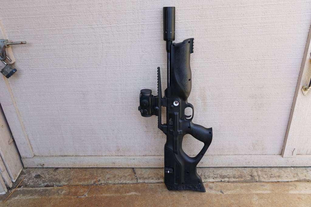

I cut the barrel off just behind the silencer. I worked to remove the barrel from the silencer body, so I could reinstall it on a much shorter barrel. After two days of slowly cutting away at the barrel by hand with rotary files, I found that I wasn't happy with the outcome, and just ended up buying a silencer adapter, cut the barrel further and installed a Donny Tatsu silencer. It's right up against the front of the stock, as short as possible without cutting the stock.
I did finally get to where I wanted to be, a "short" gun. But trying to remove the silencer from the barrel is not an easy task.
A special holder to hold the silencer tightly, and going in with a milling cutter on a mill would be the way to save the factory silencer if that's what you want.
As far as just taking the silencer apart, again, nope, at least and not and being able to put it back together..! The outer plastic sleeve will rotate around the aluminum body. You may take the plastic sleeve off and find a way to remove the end caps...but...
And yeah, after all that, it still shoots as well as it did before all of my hacking (cleaned up the end of the barrel and recrowned). And the sound, the Tatsu, is "slightly" quieter and has a different sound than the factory silencer did.
