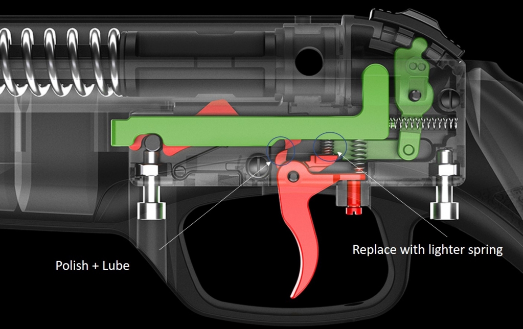

I had not disassembled or adjusted mine before, but I was told to remove the action/barrel from the stock and ship it bare. When I did, the green bar and associated spring shown in your diagram just fell off. Don't know if that was to be expected. Yeah, I'd really rather they repaired it but just maybe this is a silent internal recall. Pretty sure they would have wanted to fix it and just charge me for the service. At any rate, I shopped for a long time and I really felt this was perfect for me. I only had maybe a couple hundred rounds through it.
