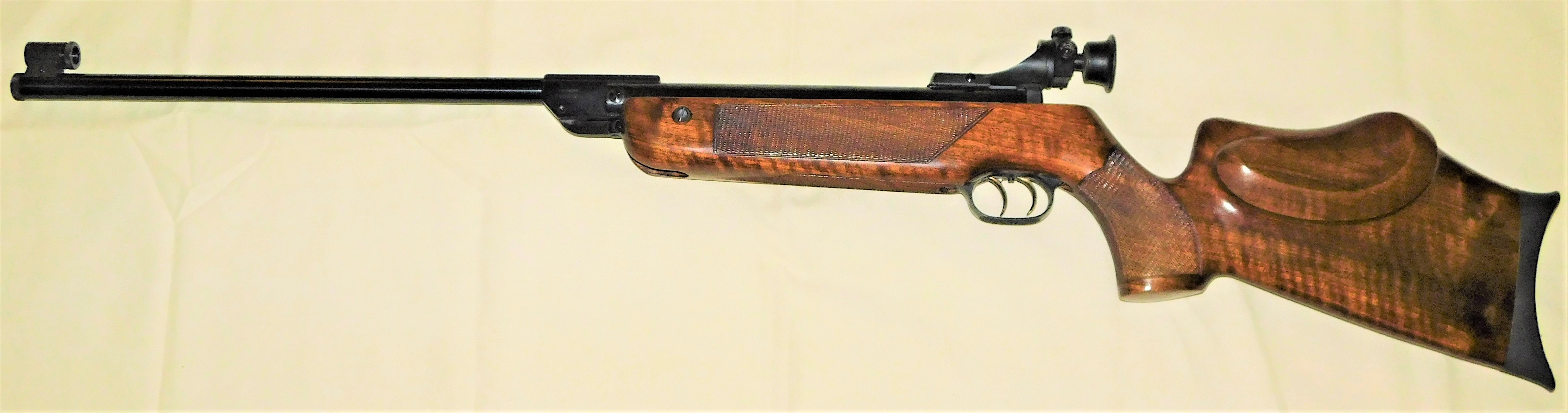

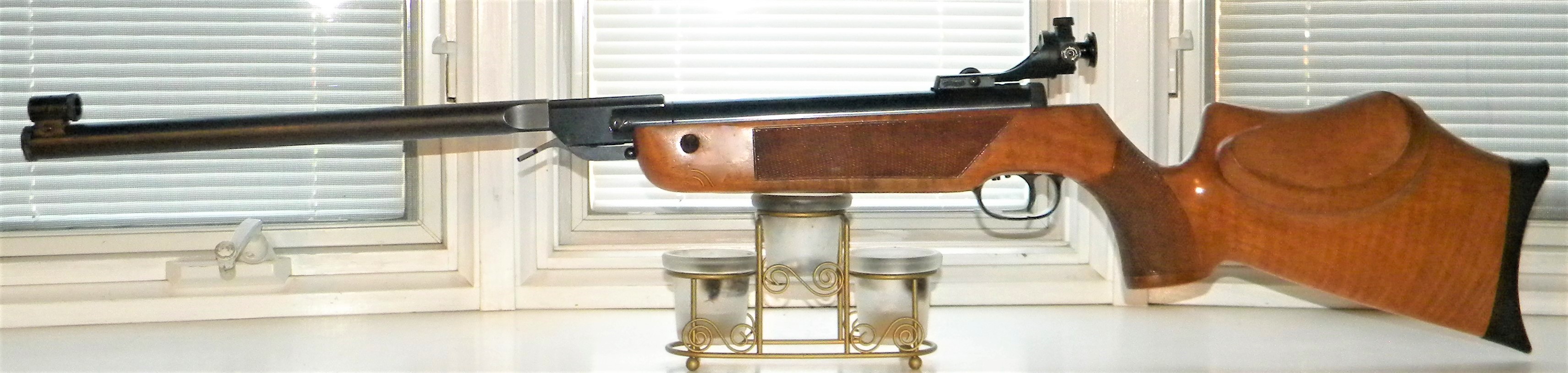

Here, LG55 and early LGV with breech lock.
Wow, those are gorgeous! Whoever picked Walther's stock blanks back in the day should be in a hall of fame somewhere.
