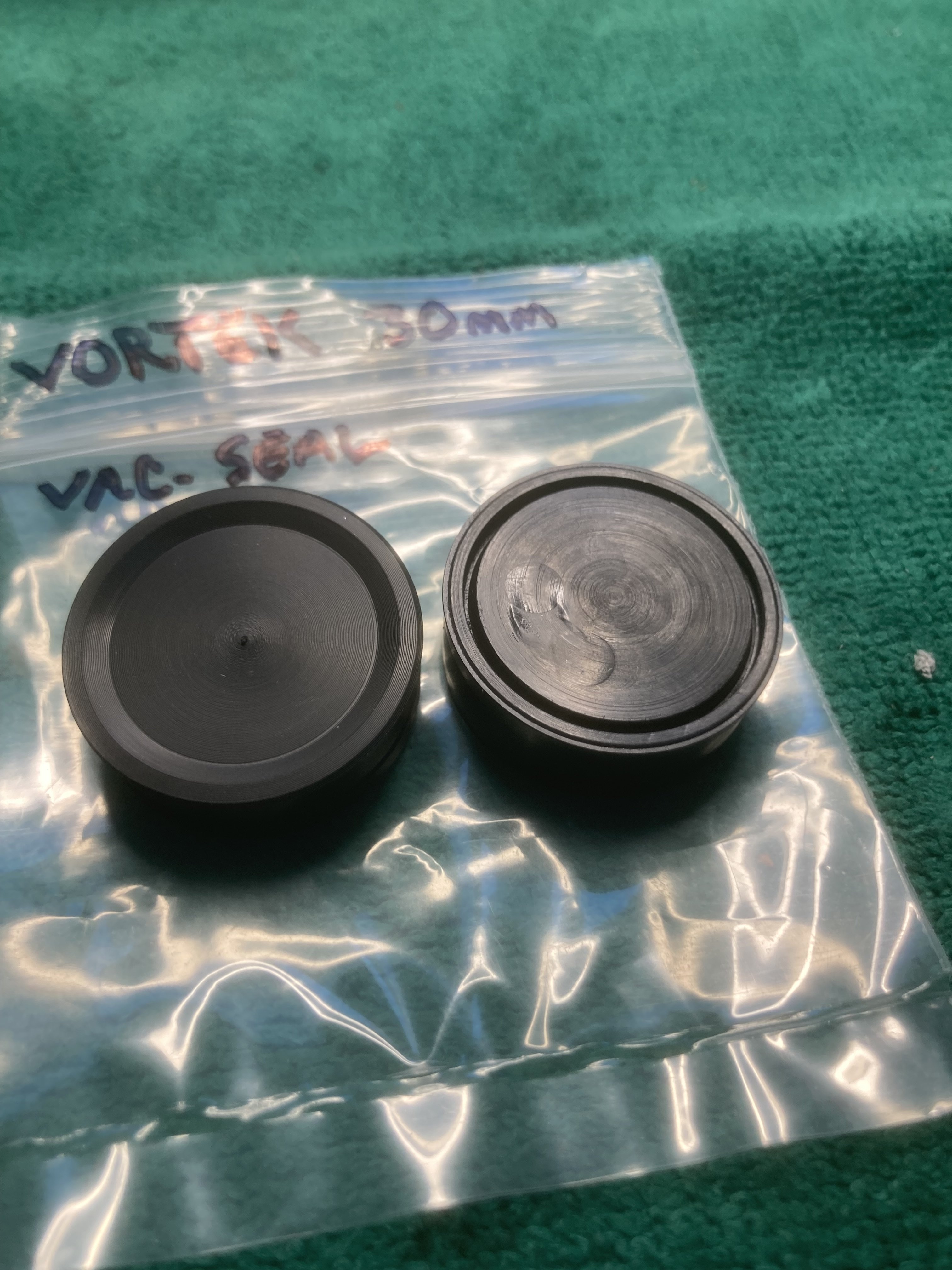

Vortek on left, original on right. Original shows signs of impact at end of stroke.
Depending on how the seal sits on the piston it looks like the Vortek has a deeper valley which
may eliminate the piston slam marks.
Haven’t disassembled to look nonetheless harsh piston stop with original, not so with Vortek. Seal height at lip same as original with face of Vortek recessed, also much tighter push-on fit to piston. The concave face does make a difference. Not sure how the lip will hold up taking the brunt. Doing well so far after 1200 rounds. Will have to see how long it lasts.
