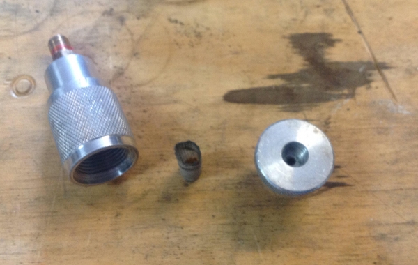

i know some of you are getting compressors for Christmas. Here is what happened to me last week with one of these cheapo compressors from China. In the parts kit that comes with them you get a small inline filter/dryer, which has been installed on my compressor since I have had and now only use it as a backup. It does not get used much as I have purchased an Air Venturi compressor. Last week while I was waiting for the return of my Ari Venturi, I needed an air charge so it was hooked direct to my Benjamin 90 ci pony tank and as the pressure neared 3500 psi, the compressor and tank was on the bench, the hose blow out of the aluminum inline filter and hit me in the left side of my stomach. The threads where pulled out by the pressure, and the threaded end waked me with the wire wound end, I'm luck that the filter did not shoot out at me it could have been really bad. So take the proper safety precautions. From now on I'll be using a better quality filter and it will be mounted in a safe direction so any blow outs will go in a safe direction.

Yea it is something to think about for sure. I was just keeping an eye on the charge, because the compressor does not have an auto shut off. Both my tanks are Carbon Fiber and when they go, it just rips open like cloth, they don't exspolde besides the burst disk will go long before the tank rips open. The threads must have been defective, because they just ripped out. Bad thing is the these Chinese stuff don't really have a QC law so you have to hope they are of good quality. It looked like the threads were 1/8" NPT instead of reg 1/8" BSP that the foster fittings are.
this liter was screwed into the blow down block, and hose was screwed in to the top. You can see that the little filter element is empty because all the fuzzy stuff came out through the tiny hole in the top when the hose went flying. It hurt like all get out at first but just a large bruise now, no real damage, maybe my pride a little. I just ordered a much better filter before before I use it again. The filter cost more than the compressor,LOL

"Centercut"Yes, like Thurmond requested, please provide photos. Also, what was inside your small filter, and how long was it in there?
Just posted a picture, the filter was new I just put a new one in ever charge. It is the ones tha came with the filter housing in spare parts kit. They look like a large cigarette filter kind of. The element was not the problem, the hose ripped out the threads exit side of the filter. I had looked at the pressure gauge on the block the filter was screwed into, like seconds before it blew. It read a little less than 3500 psi.. Like I said, I think the threads where defective. I'll be more observant next time.

"huntjunky"Sorry to hear about your misfortune. I haven't seen anything like that, since I got rid of an EX girl friend that contracted herpes. I own a Yong Heng (cheap Chinese compressor) but do not recognize the component pictured...would you mind expounding, with some detail, as to brand or make of compressor? Thanks for sharing.
It does not matter what name is painted on the sides of the compressor. They are built in the same factory and sold by the Chinese army through distributors. There is no competition between these compressors they are all the same. They most all come with a little air filter either attached to the drain block or inline with the hose this one was screwed into the drain block with the hose screwed into the round top with a small fiber filter element inside. The hose striped out the threads and hit me in my left side as I was checking the presure. You put these in a cage, box or steel safe, but at some point you have handle them with out protection as I was doing next to it.
