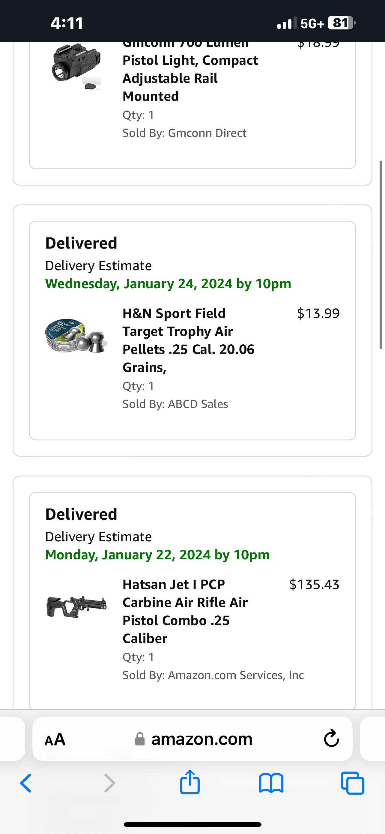

WARNING! DO NOT BUY THE HATSAN JET!!!
This is just a warning post for everyone to not buy the Hatsan Jet. By far the worst pcp I've ever seen. Gun came looking like it was a return or used item. Had tooling marks all down the barrel, was leaking oil from the receiver and was impossible to sight in. I chalked it up to being a one-off, but the replacement came in the same condition as the first. The top rail is just a faux rail. The picatinny are too small and the dovetail is too deep to mount ANYTHING correctly. When trying to mount on the top pic rail, the brittle plastic just crumbled. Upon contacting Kadden at HatsanUSA and explaining the situation and asking for a refund, I was immediately denied. I was told that "I" modified the gun (the broke off pieces of pic rail) and then they offered to repair at the rate of $50/hr. The repair would have cost more than a gun I don't want. Hatsan customer service has been horrendous. Poor manufacturing and even worse materials used to produce. The barrels are out of wack, the iron sights are unusable along with the top rail and they leak oil out of the box. If you plan on purchasing with the intent of using it as a platform to build your own gun, then you still have to consider the bad materials used to build it. That said, I'm stuck with a brand new gun that has broke off pic rails, leaks oil and will never sight in. A laser sight on the side rail is the only way to plink with it and Pellets are still highly erratic. Steer very clear of this one. If you are debating between jet2 or the Notos, it's the notos all day.
