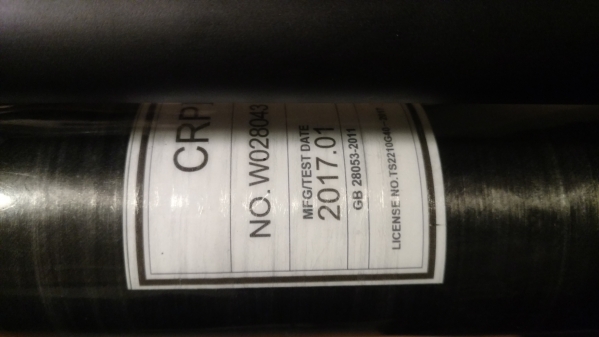

I guess that were we have different schools of thought. Part of the "Design Spec" indicates that certain things must be "marked" on the label of the cylinder. If the cylinder doesn't have these "markings" then how can it me made in compliance with them?"Dairyboy"This is his quote on the topic
"I have already had an email about them not complying with the DOT and TC markings, which I would agree is the case.... You probably can't get them filled in the USA or Canada.... I purchased the tank for my own use, after checking on the design spec. which is GB-28053-2011.... That is a very detailed technical specification, but here was the part I was concerned with, for my own peace of mind....Quote

Here is an air cylinder that is made to GB-28053-2011 Standard. Take notice of the marking on the tank."Dairyboy"This is his quote on the topic
Yes - so they are now putting it on the tanks. Not sure if that's good or bad. Originally the cylinders didn't have that on there, but now they do so I guess they are learning. Makes me wonder what else they weren't doing to the tanks."Dairyboy"![]()
