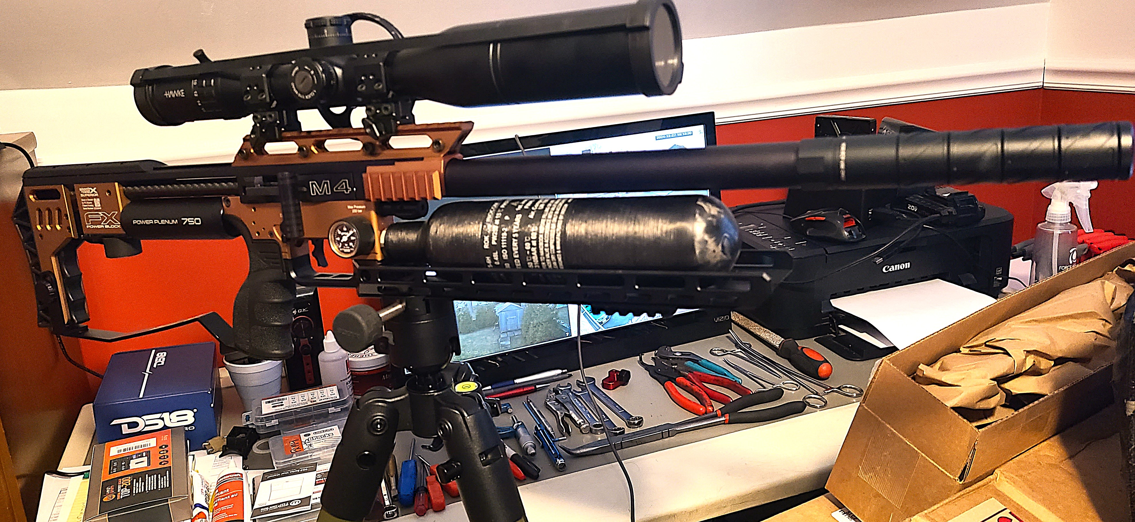

got the Donny Ryu today with 2 extra baffles as they suggested also in 30 cal.
i decided to also change my liner to the stx slug 1/16 last night.
not sure about anyone else but i have found the .22 fx CF Liner stiffeners fit the 25 real tight vs the .25 which slides on.
also add an o ring to each end for vibration just the way my mind thinks right or wrong seems to work, got it indexed put 150 rounds through it.
shot with both the stock fx and the RYU
stock mod just works well for being an empty can cannot deny it.

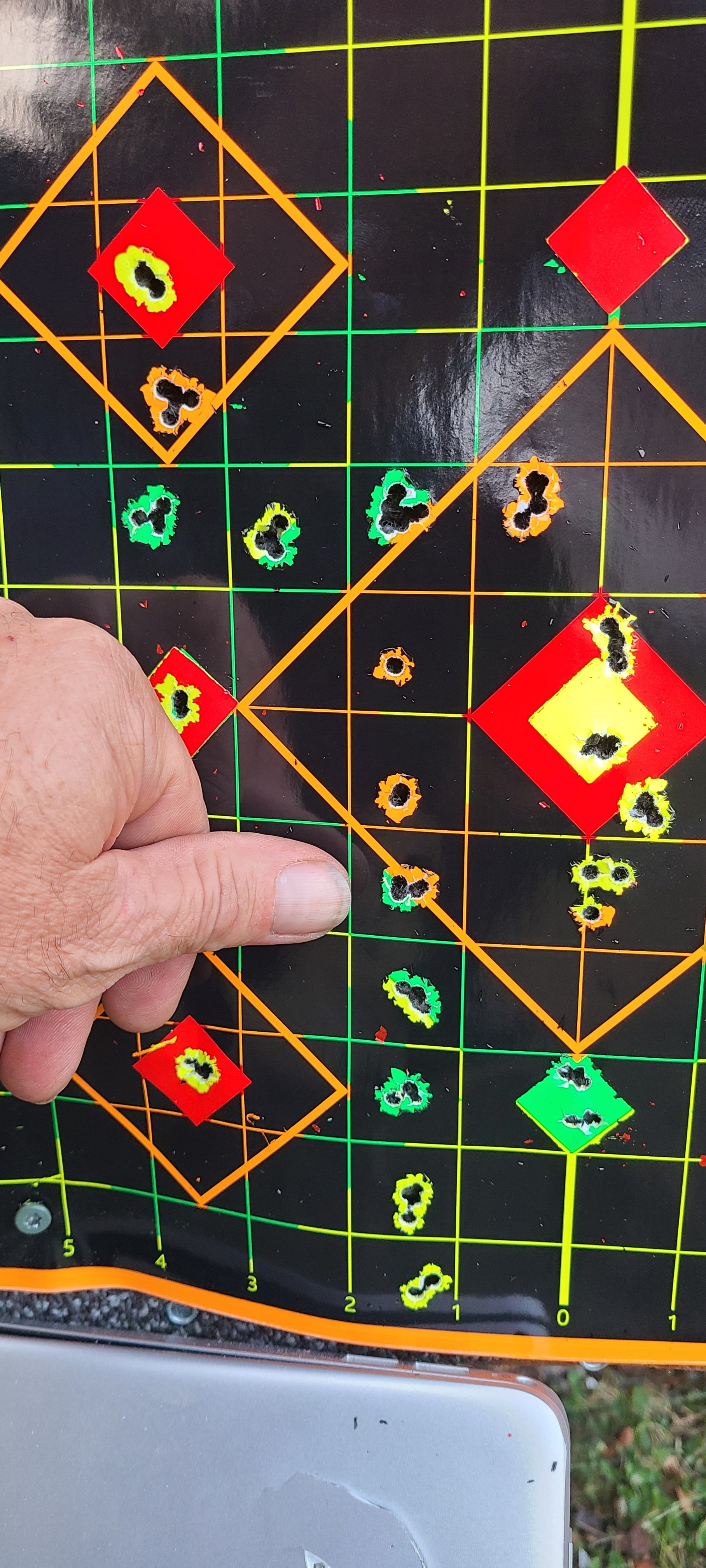

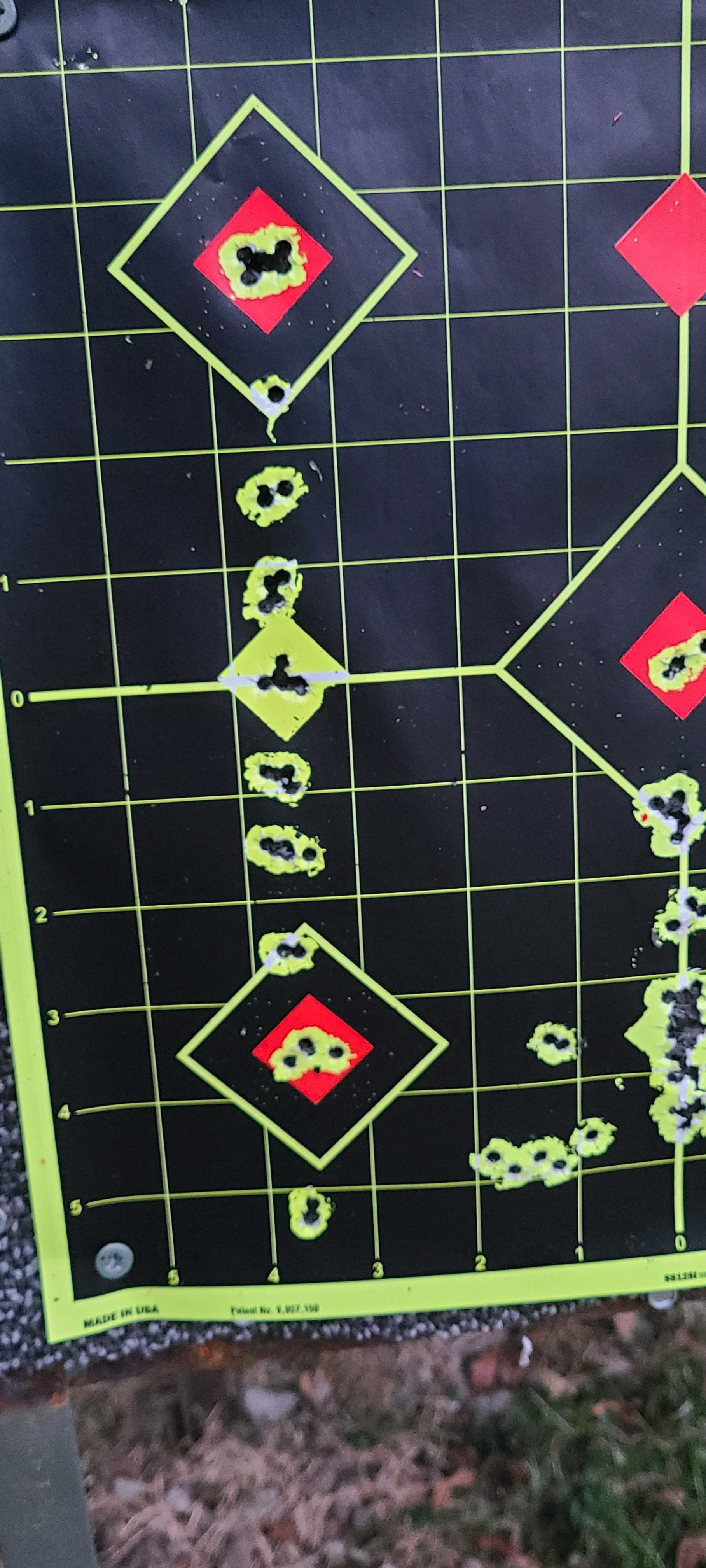

the RYU i shot 4 groups of 4 starting from 1 baffle to 6, then, 5 baffles down to 4 and 4 worked best. tight groups just like the stock moderator.
i will say the sound is different with 4 baffles i hear the action of the gun more so and a lower tone more so a thump vs a whoosh.
i like it with 4 baffles 3 baffles seem to have more of a pop than a thud i guess you could say
also groups better with 4 than 3 or 5 or 6 for this gun 600mm shooting 32-34g H&ns and 32 aea.
group on the right stock mod one on the left if the Ryū all at 50 yds if no rain going to the range Tomorrow, for 100-150yds.
all in all, I'm happy with the results just as good as groups and a lower tone.
