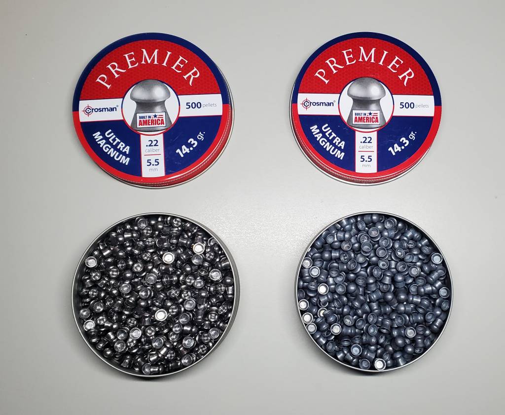

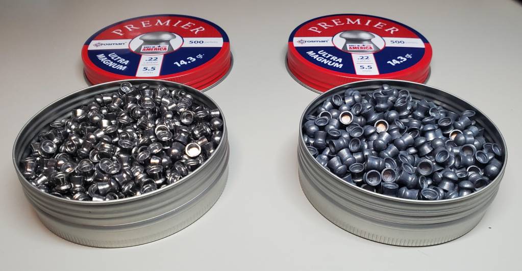

I picked up several tins of Crosman Premier Pellets for use in my AEA Semi-automatic pistol. These pellets are harder and may cycle better than the JSBs that are made of softer lead. When I opened up the tin, the new pellets were shiny and but had lots lead shards so I washed them with a few drops of Dawn soap. Triple washed them and dried them on a paper towel. Originally, the pellets are shiny and now they are dull albeit clean. What is going on here?
New unwashed (Left) Washed (Right)

I started washing because I thought the Crosman pellets were dirty, now that I learned it is graphite no more washing. I am going to dump the pellets into a strainer basket to remove the "shards" A can of compressed air may help knock off the loose particles. Afterwards, I'll put it back in the tin and shoot them as is. It should be good enough for plinking with my semi-auto AEA pistol.
