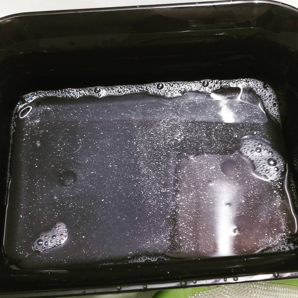

Washing Pellets??
Thanks guys
iI had no idea but I certainly will make a regular habit of it. Doesn’t seem like that much effort to keep the barrel happy.

also washing pellets means your fingers do not get as much on them to transfer into your body , think about it .
I try to wash my pellets in warm water and dish soap. Then i roll them in an old towel or tshirt and then let them air dry. Once dry i spray a little furniture polish in a tin and roll the pellets around until they are coated and let them air dry. BUT…….. before you do this to a whole tin or more do it to 20 or 30 first and make sure they stay accurate. I made the mistake of washing and lubing multiple tins of 25 cal grizzlies and they flew all over like a shotgun blast. Unwashed they were dead nuts.

Always wash/dry my slugs - take a look sometime at the amount of debit left over from casting/machining etc. - this and, after drying I put them in a plastic bag and put a Q-tip with a drop or two of Lucas RC10 to add just a bit of lube. works great. my gun, Taipan Vet .25 - tuned - two plenums add ons - LW polygonal barrel, hand lapped. Griffin 48gr HP BT
