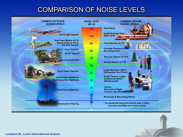

"rwsmike"Steve, another great video and I'm glad you admitted that this gun is not backyard friendly at all out of the box ....that meter saying 82 Decimal is so probably off by at least 25 otherwise 82 decimals would be backyard friendly . good job pal:)
OH NO! THE DREADED SOUND METER COMMENT IS BACK TO HAUNT ME... AHHHHHHH :)
It's not off brother. It's just spaced 15 feet from the gun and is outdoors. The 65 dB it registers from my loud voice 15' away calibrates out and the Jumbo is definitely not as loud as a blender, freight train, or jet engine as all these warehouse readings would suggest. (Love you Tyler) :)
Hope this helps.
