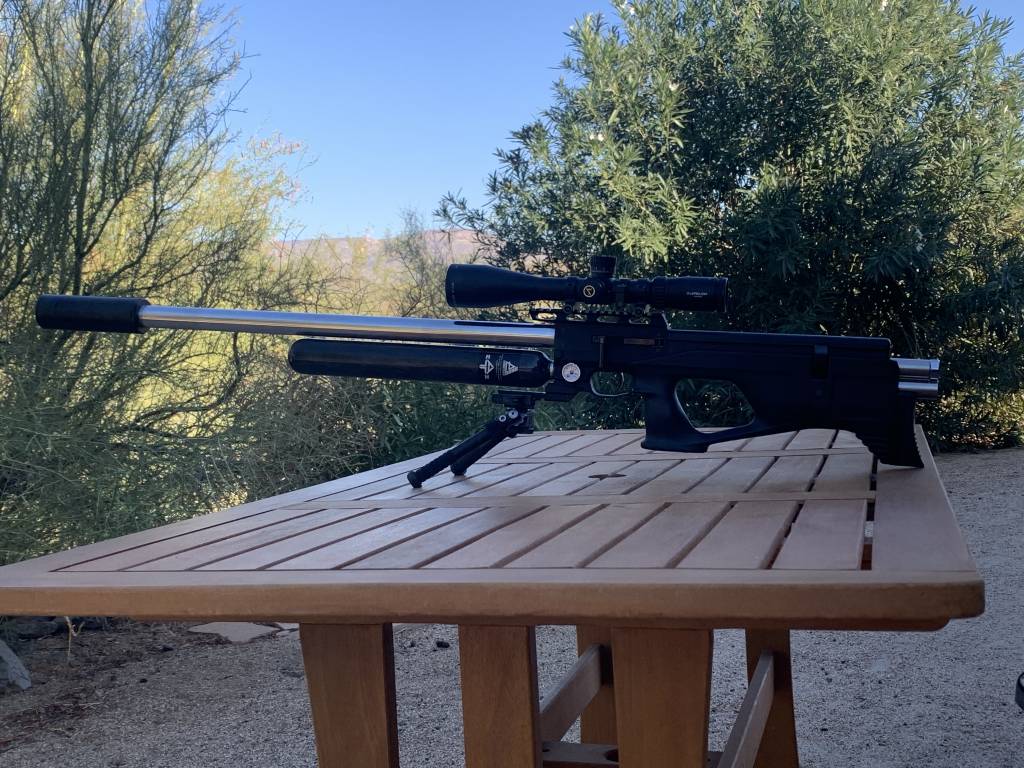

Stoti, I just finished a long session of slug testing with this “ new” barrel. Let me tell you this barrel is here to stay! 34.5” tj 1:26 .294/.300. I was just playing with a 35” tj but this ones more accurate now. Looks like my tune is going to stay with 61.5gr nsa @ 1020 fps. I had 4-3 shot clover leafs at 90 yards, then a 10 shot around 5/8”, then another 5 shot around .5”. The wind was pretty calm. Heres a little twist, the 44gr slugs are above the sound barrier, makes a nice crack, and still shoot an inch or better. Nice flat squirrel shooter there! I couldnt be happier, every slug I tried was minute of squirrel. And being as this is a hunting gun its perfect!
