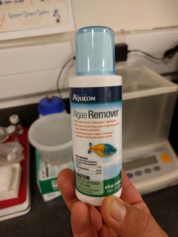

prfsslee can you tell me or provide a link to the algacide you are using. I was looking at algacides on Amazon for pools it they look mighty concentrated. I like the idea of not have to be constantly changing the water whether it is supposed to be bottled water or distilled. Bill

@AirgunBill - This is the bottle. If I remember, about $7 from the local Pet Supply store. Just a couple of drops so that's a lifetime supply right there.
