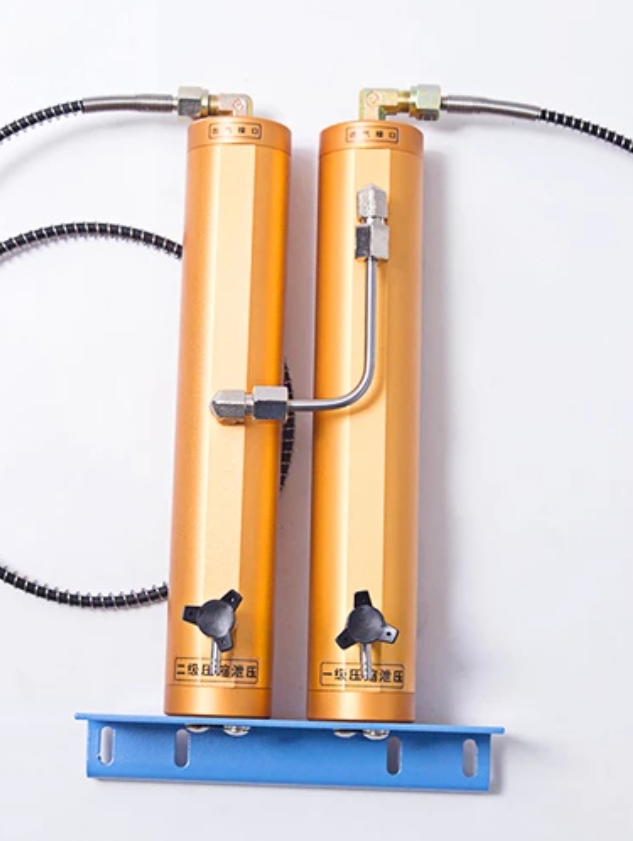

I have been reading through the forum threads referencing how to remove (separate) water and oil from the system when filling airguns and tanks. The generic dual orange cylinder filter comes up in several threads as a recommended option.
Some of the older forum threads included URL(s) to Ebay and AliExpress that are no longer active links. I was able to find a similar filter, but wasn't sure if anyone had a recommended source to purchase this from?

Recently learned the double-tube set-up is geared more towards breathing air usage over the single-tube system. Actually, the single-tube system ($125) is one half of the double-tube system ($300), the second tube containing activated charcoal to remove odors and taste, making breathable air more palatable. Your PCP doesn't care about tastes and odors, save your money, get the single tube. WM
For a PCP setup, my understanding is that you fill the 2nd tube with just moisture absorbing material in the plastic tube to get the air as dry as possible. No need for the charcoal unless you wanted to have an emergency SCBA mask setup in your home in case of a fire. If you use the type of moisture absorbent that changes color when moisture has been absorbed then you will know if and how much moisture is getting past the first stage water separator. If it never changes, then you are getting all of the moisture with the first stage.
I ordered this one on Aliexpress for $162.15 shipped with all the discounts offered that I could find. I plan to hook up to my Yong Heng. It arrived today, taking exactly 11 days from when I ordered it. I haven't installed it yet, but it looks well made. They also have a smaller version for lower volume flow compressors that should work well on the YH I would think in lower humidity areas.

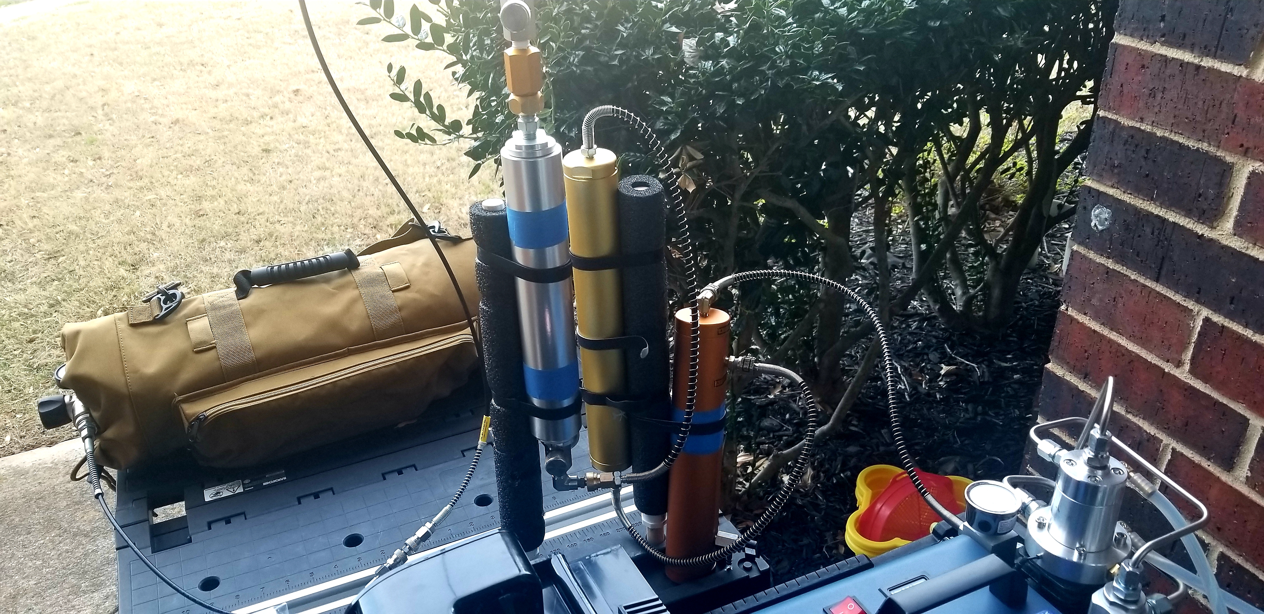

Thanks for the reminder. It works well and it seems to be stopping all moisture from getting into my SCBA tanks. I'm probably going a little overboard as I am running three filters.
I put a Gold Tuxing Water Oil Separator Molecular Sieve filter in between the JB Alpha Filter and the copper Coalescing Water Separator. When I purge the water every 7 minutes I am only getting water coming out of the Copper Colored Coalescing (none coming out when I bleed the JB Alpha filter). So far everything is working as I expected and I haven't seen any rust as I saw mention that someone experienced with their Coalescing filter.
The main reason I run the extra Gold Tuxing filter is in case there was any rusty water somehow getting by I didn't want it getting into the JB Alpha filter.

You win the “most filtering” prize for any YongHeng I’ve ever seen!!
PJ,
One heck of a set-up, anyone buying a gun fed from that should have no worries. My only suggestion comes from a Biohazardman recommendation to keep all items to be filled higher than the system. Since moisture prefers low-lying areas and making it struggle uphill to get to your stuff is a good thing, he always stressed high placement. WM
