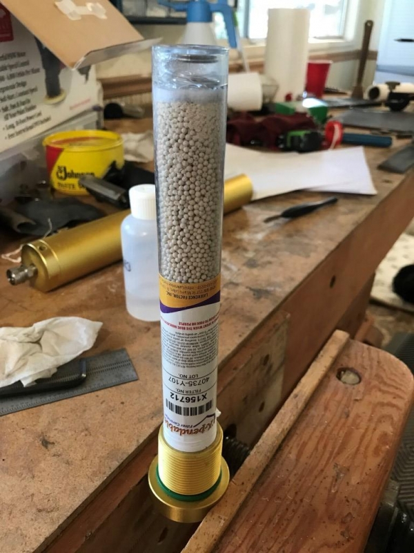

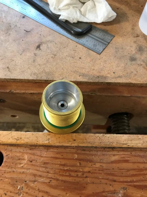

Made some progress on the water separator system for my YongHeng compressor. I ordered a "gold" filter from AliExpress for ~$50. I bored out one of the caps to 1.180" x 0.75" to allow the o-ring of the Fiter Techs 13x molecular sieve element to seal in the cap. This will be the outlet, as pressure will push the filter element into the cap. I cut one of the tampons to 2.25" so it presses against the filter element on the inlet side.
https://www.filtertechs.com/shop/product_info.php?products_id=394&osCsid=qf8e3qqcb8on78i46tfkanhf31

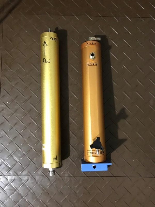

I bought a second mechanical separator from someone on this site used (the mechanical separator has an inlet on the top that goes into a muffler and diffuser directing flow down, and the outlet is above the exit of the diffuser so the air has to take a tortuous path giving moisture a chance to condense at the bottom of the separator. There is also a drain at the bottom to vent the water.)
The outlet of the compressor will go into the top of the mechanical separator, which will have a check valve on it to keep pressure in the separator when I vent the compressor. The outlet of the mechanical separator will go to the bottom of the gold filter with the 13X cartridge. The gold filter will have a PMV set to 1800 psi to keep both filters pressurized. Both filters will be mounted above the compressor outlet, allowing the compressor vent to act as a first stage separator.

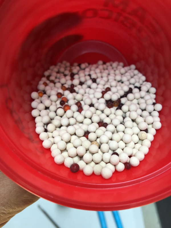

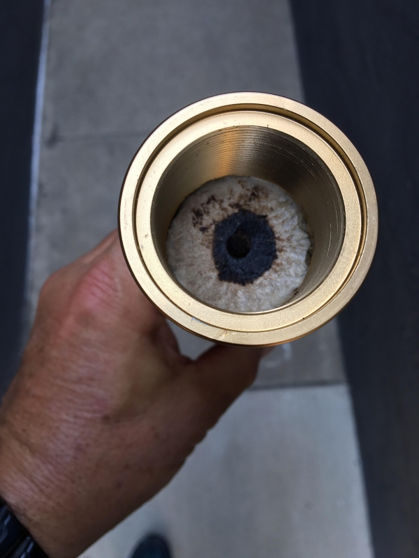

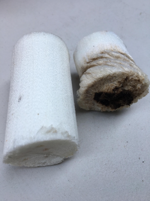

@milacik, you do have a valid point. However, even in not so humid areas like Southern California, some of the moisture from the compressor can get to your air rifles. See photos below of what my filter stopped after a total of 7.5 hours run time. The first two photos are of the cotton inlet tampon filter, and the third photo is of the Zeolite 13X molecular sieve with a sprinkling of color changing silica beads. They turn dark when expended or moist. All of the colored ones were orange when I put them in the filter housing... The cotton filter on the left in the second photo is the outlet filter, and you can see that it is clean.
1536608216_15811789235b96c7d8d16168.16367276_Zeolite expended orange beads.jpg
