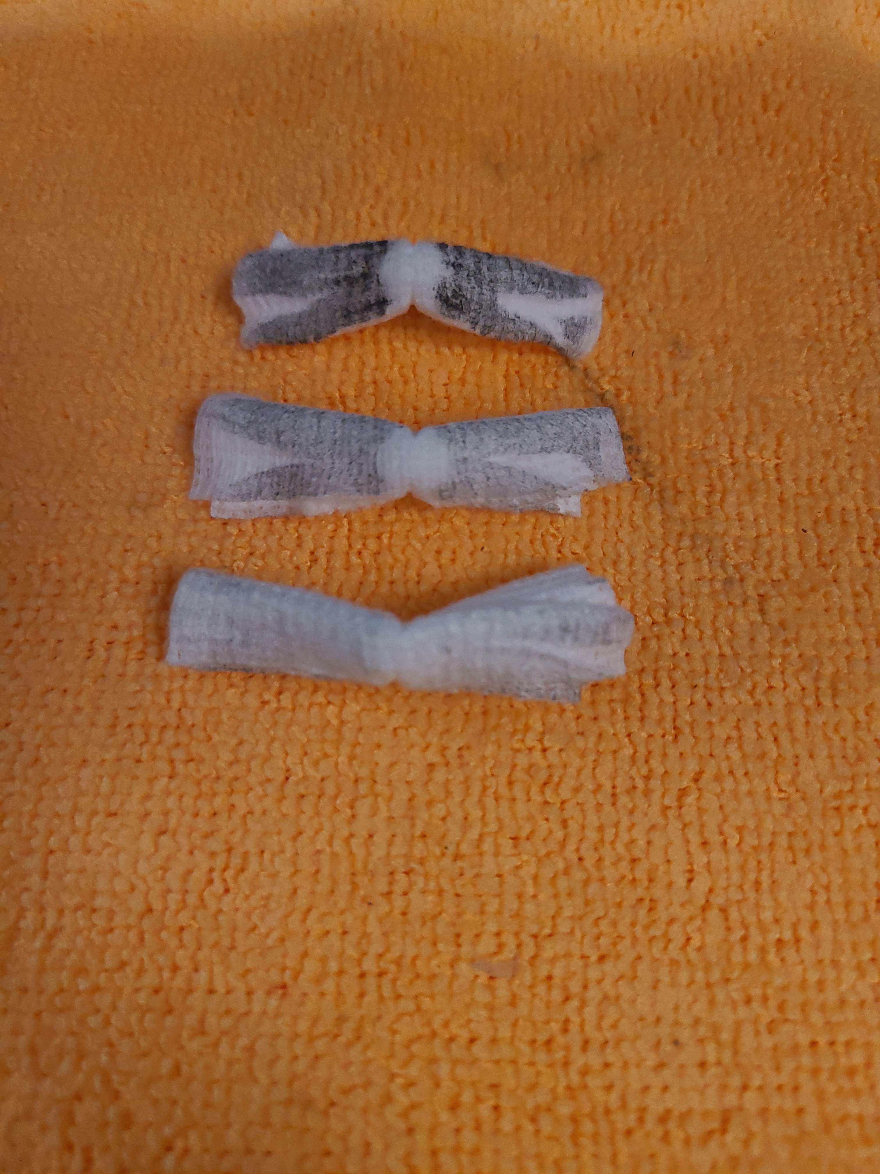

I wasn't going to pull patches though yet, but here are the results. 400 plus 30gr slugs @ 960fps. 3 dry patches.
