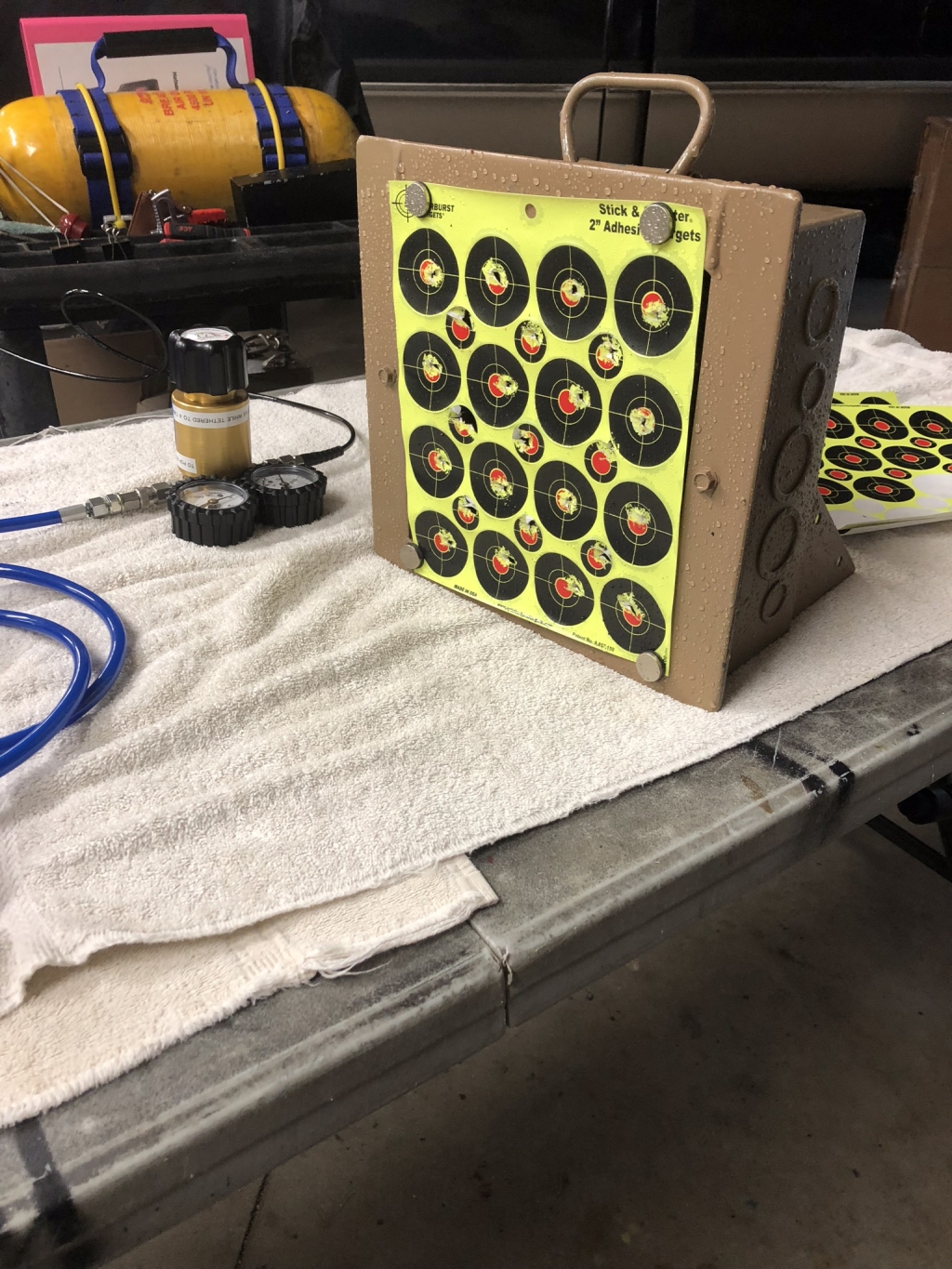

Okay this is a good example of why I like applying wax. The choked .177 LW barrel on my QB79 HPA scatters pellets for the first 30 shots after a cleaning. The first time I cleaned it and went to zero it, I was getting frustrated because it kept wandering around all over the place.
With a coat of wax, it falls in line with less than 5 pellets:
Yes, it made a sub-MoA group with wadcutters at 30 yards. No, I can't do that every time :) It was dead calm today and I was uncommonly locked in.
...and here's how the .22 cal fared:
Without the wax treatment, this barrel only needs 10 or so pellets to settle in but it groups straight away with the wax. If it weren't for that cantankerous little guy to the left, this one would have been right around MoA. No hard feelings though, they're Daisy pellets after all.
