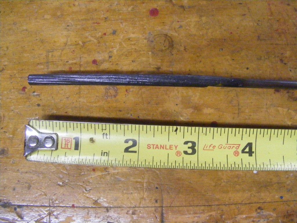

this would probably be a good candidate for a lapping, but I wouldn't feel comfortable doing it on a choked barrel
If you cast a long-ish lap at the muzzle, 2" or 3" long, you can effectively lap both the main part of the bore as well as the choke.
Side benefit is you can't accidentally exit the muzzle when lapping.
