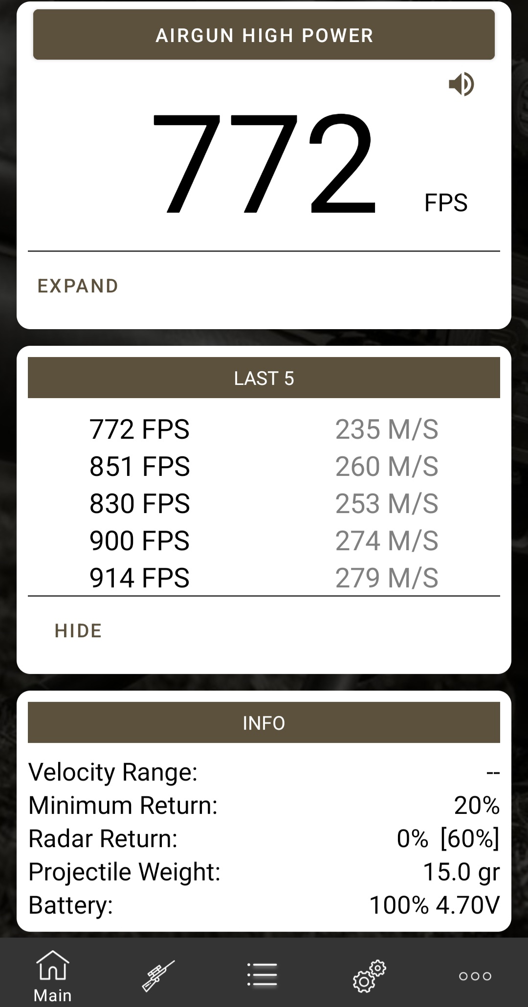

Rotated and still the same🤬🤣🤣
Have you removed and weighed the hammer weight? My Wildcat MK3, BT compact came with the wrong hammer weight (too light). It was a real mess trying to figure out what the gun was doing. FX customer service helped diagnose the problem and sent me the correct hammer weight. It made all the difference in the world.
Yep my hammer weight is 10.55 grams, what was yours?
I had to send mine back to (FiX) to have them sort mine out, I got tired of wasting pellets trying to get that gun to shoot. It’s so frustrating to pay that much for a gun and it doesn’t perform. If I were you, I’d box it up and send it back, I know you’ll be without it for a couple of months but at least you can keep your sanity.

Update* I called FX today and they suggested that I inspect the hammer and sear. I pulled both out and there was very little scuffing, so I polished both up and reinstalled, still the same issue. They are sending me a new hammer to install but I highly doubt that has anything to do with this issue. Next I took both regs out and polished them, including the belleville washers. Installed back in gun and test fired... still same issue, although now I can hear the gun constantly airing up after every shot. It sounds really slow like there is a bottleneck somewhere going to the plenum. That was with the first reg at 120 bar and second reg at 90 bar. Next I lowered the second reg to 60 bar, (after degassing of course) and I am now getting a pretty consistent shot string around 880 with an ES of approximately 20. It seems like the air fills so slowly that it can't keep up when the second reg is set at 90 bar but it is able to barely keep up with it set at 60 bar. I'm not sure if this is the regs or something inside of the plenum.
The new Huma regs will be here Monday so I will have to see what happens when I switch them out. I guess in the mean time I will try to open up the plenum and take a look inside. I haven't lost my sanity yet, I want to figure this out without having to send it in. I don't have a problem sending it in cause I still have my impact to shoot but I want to get to the bottom of this🤣
