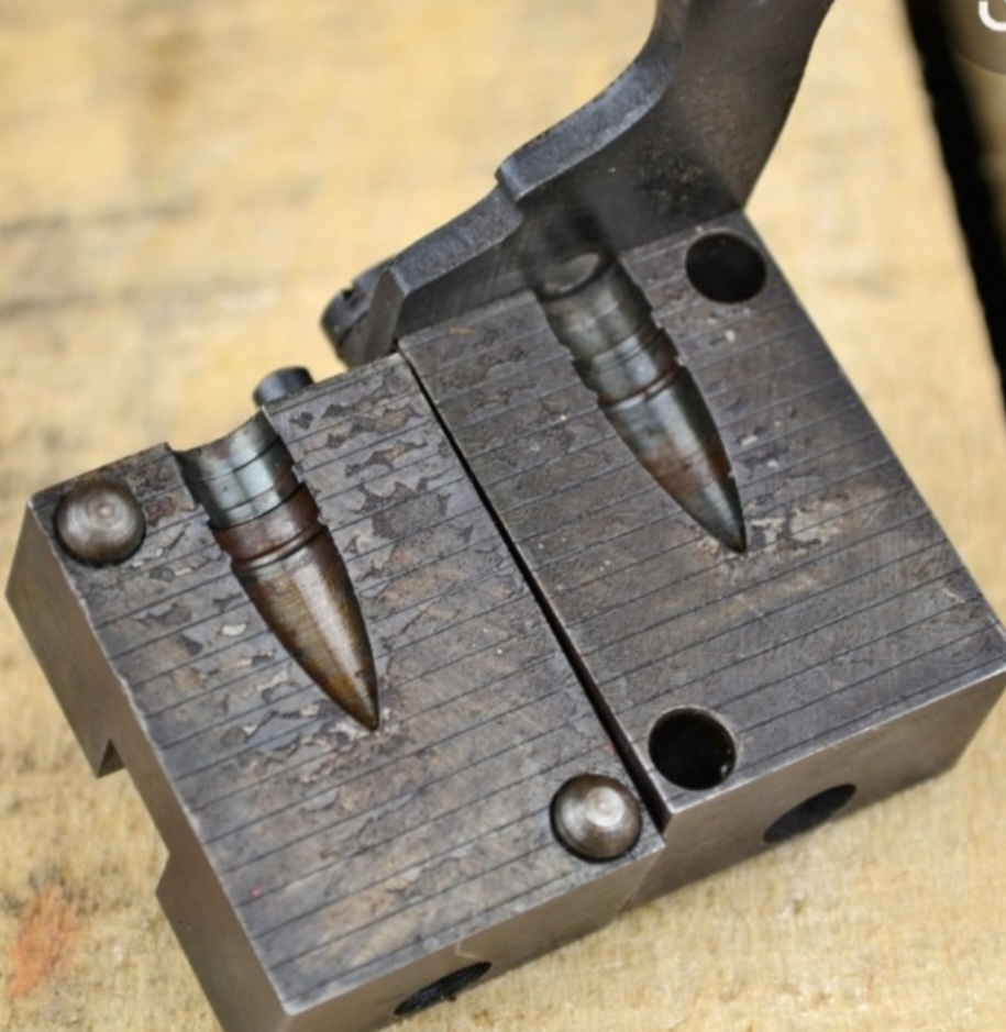

90gr 257 is not accurate 100+ yards.. 85g is the proven max that that the 1-14 twist will stabilize..depending on the bullet profile..there is power to push up to 105g but not aviable twist rate.. that is why I paid for the 1-8 n 1-9 ... 1-10 was tested to since the beginning by Mr Bowman n Cedric.. and it was a no go ..been the 1-14 chosen as the best option.. up to 85g ..a 1-7 was tested for heavy bullets but it didn't work.. but the twist rate calculator puts 100g ..0.9375 length .. stability between 1-8 n 1-9 at a average speed of 1000fps ..if you look at the profile of the 257-418 - or the 257-100 there is a bit more to be said about 257 if we manage to stabilize better n heavy bullets... same thing also applies to the .224 with a condor ss frame n 33" barrel 65gr could easily be pushed at 1000fps..
