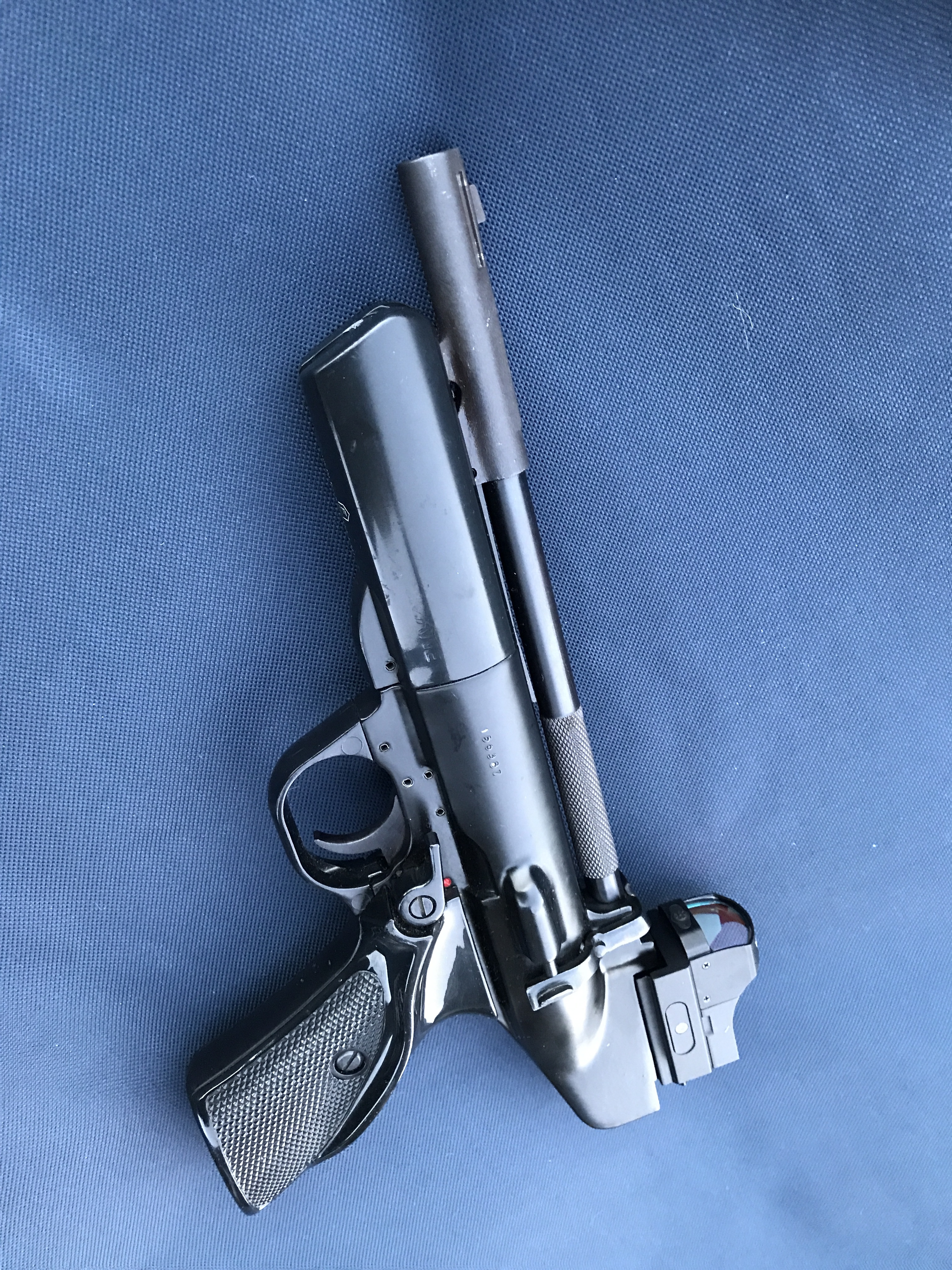

I think the original scope mount are not very harmonic on this pistol so to say. It is looking a bit odd with that rear over hang.
Mounting a picatinny, and attach a red dot is a more balanced set up I think. And it definitely gives you a better result than the iron sights. At least for me.

Can you send me or set up a link to the mount and red dot you used, I am in the process of purchasing one of these pistols and I love your set up.

You simply replace the rear sight with a picatinny rail (search the net) and mount a red dot (search the net) on it. In my case I had to drill an extra hole through the rail to match one of the original shrew holes. I can`t remember now, but I THINK I used the original sight shrews when fasten the pic.rail.
Tip: Be exact when drilling through the rail, or the rail will be mounted inaccurate. And make room for the shrew head. A pillar drill will be necessary.
